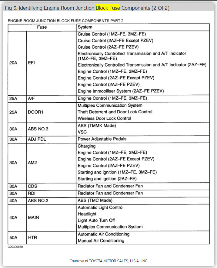

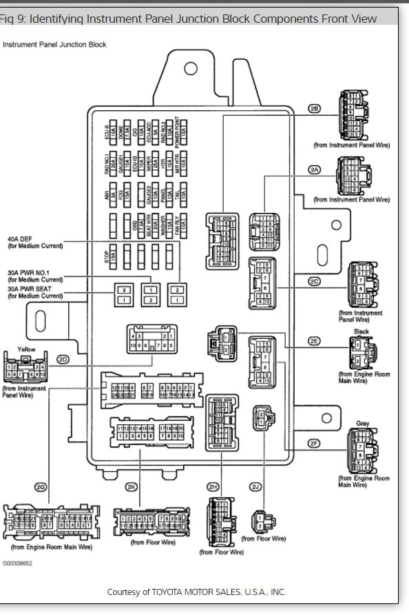

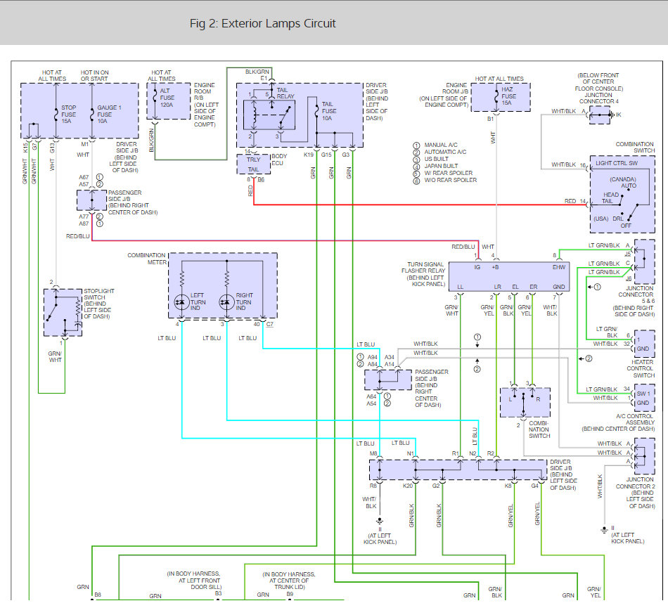

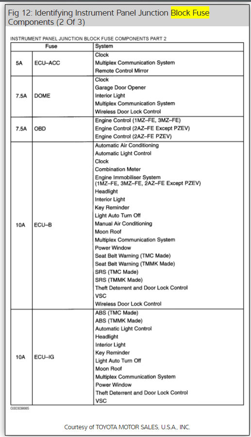

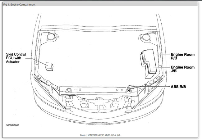

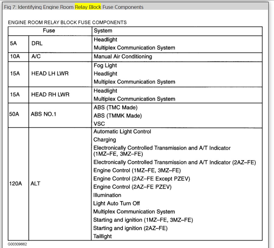

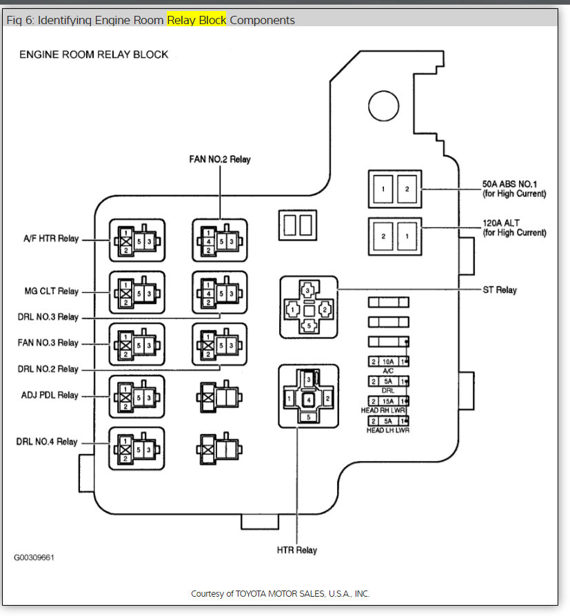

I replaced the cluster with a used one from eBay and the brake light does not work. is there a way you can reset the cluster to make the brake light work?
Sep 19, 2017 at 10:55 AM
  • 55,433 POSTS

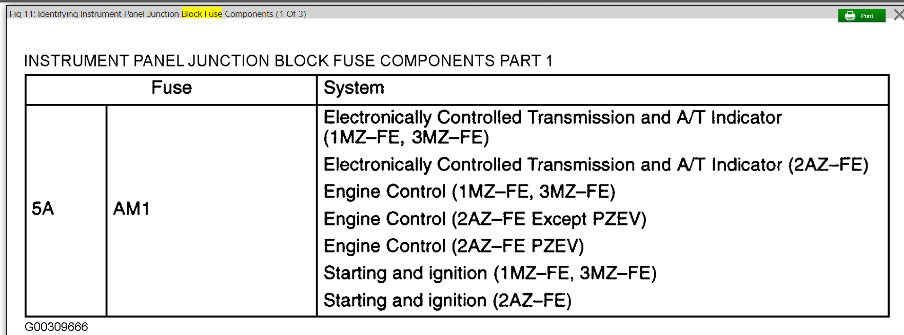

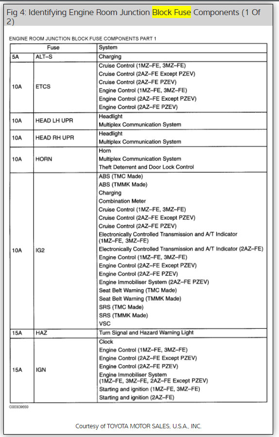

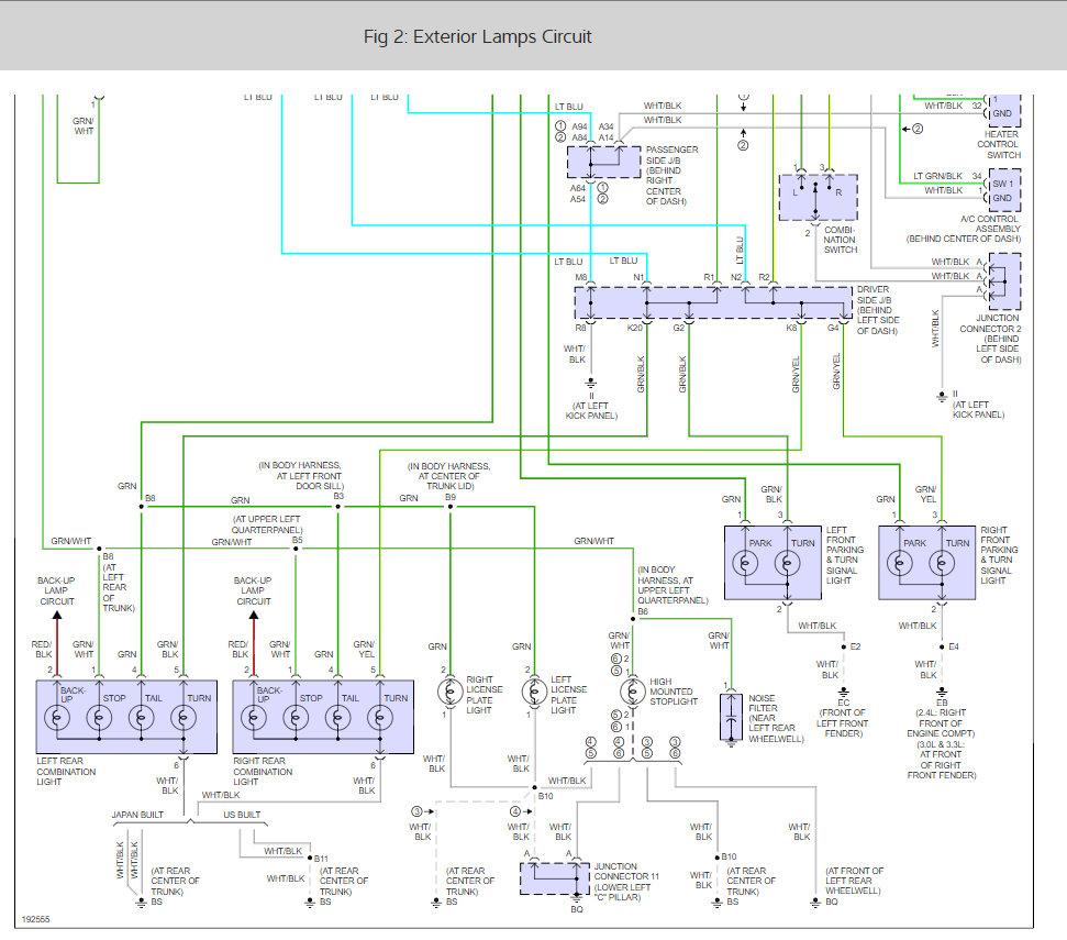

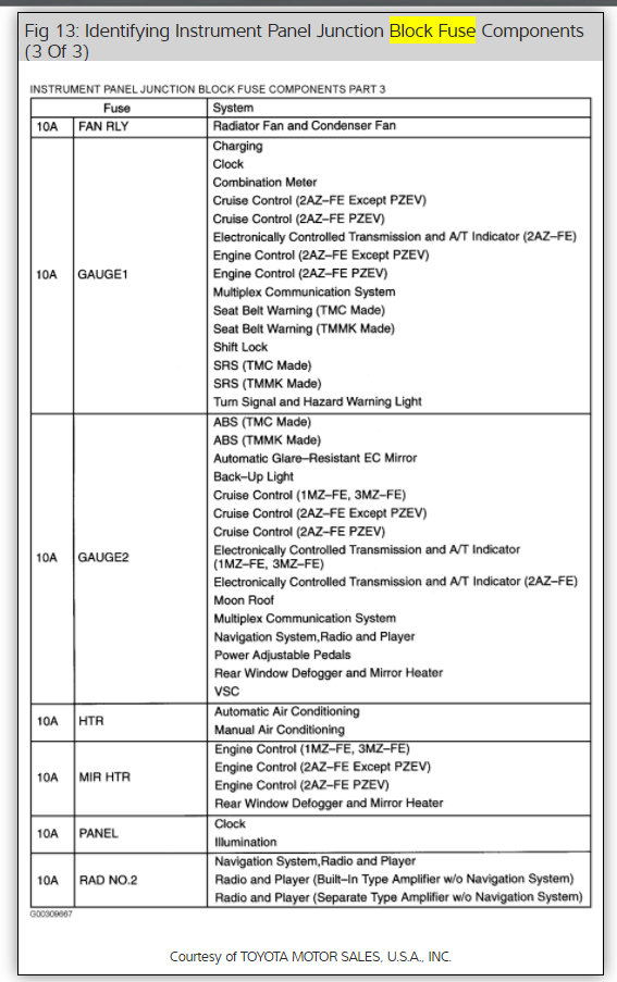

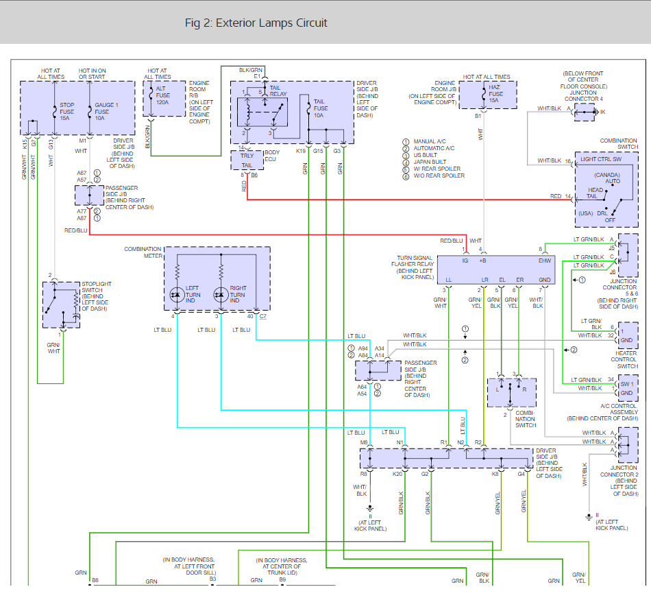

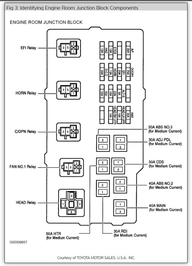

The cluster has nothing to do with the brake lights. Maybe the fuse blew (there are 3 of them), here is a guide and some diagrams to help us see what happened.
and
https://www.2carpros.com/articles/brake-lights-not-working
Here are some guide (below)Please let us know what happens and upload pictures or videos of the problem.
