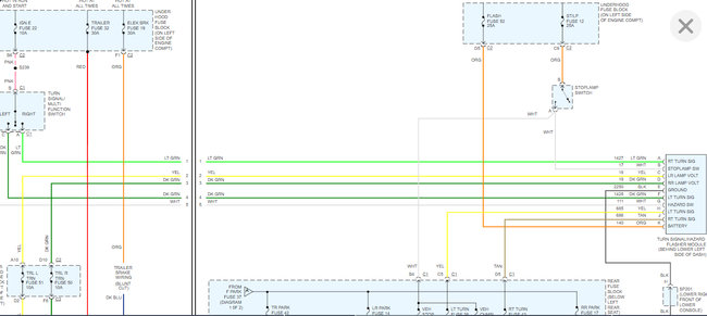

Both sides and third top brake lights not working.
Dec 24, 2018 at 8:11 PM
Good morning,
I attached a wiring diagram for you to view.
Check the fuses listed in the under hood fuse block for power on both sides. then check for power to the brake light switch under the dash by the brake pedal.
