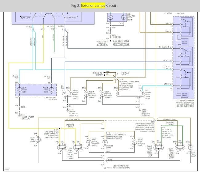

the brake lights do not work, the tail lights work fine and the third brake light in the center of the truck lid works. I change the brake light switch and checked the bulbs and the bulb sockets. any help would be appreciated.

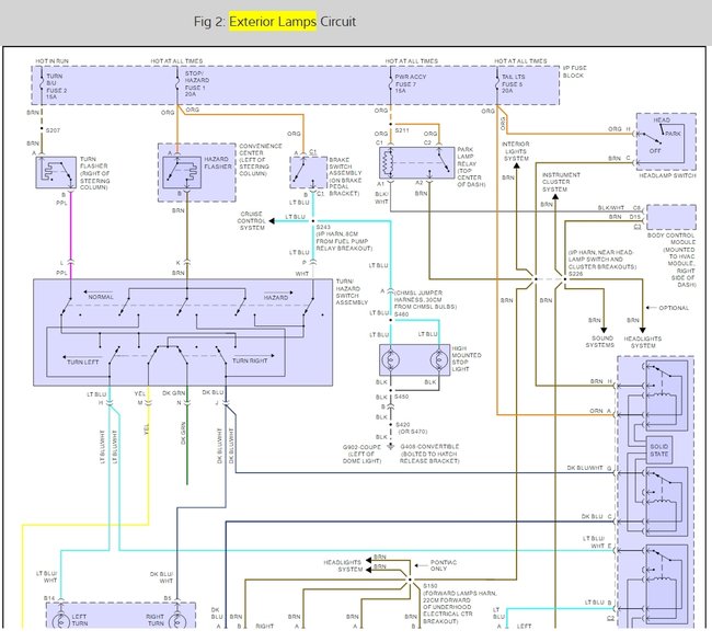

That is most likely a bad turn signal switch. The two lower lights pass through that first so the turn signals can cancel out the brake lights when necessary.

You really should test things before replacing them. You would need a wiring diagram and someone that knows how to read and follow it along with know how to test.

Okay, if the CHMSL works you can eliminate the primary fuse and the brake light switch. Next item. Do the rear turn signals work? How about the hazard lights?
The brake switch feeds them.

Yep a simple test light and this wiring diagram I got for you. Trace the power and see where you loose it then replace or repair as needed.

Thanks Ken for all the info after changing the turn signal switch I have brake lights again thanks again.
