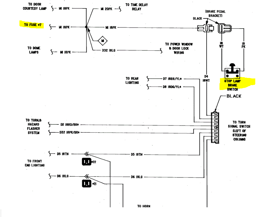

Brake light fuse blows as soon as you hit the brake and shuts off all interior lights, door buzzer, cargo, lamp as well as the cluster lights. can't find any exposed wires.

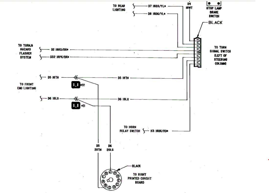

Because of the model year, my schematics are very limited. However, I did find a schematic that includes the brake light switch. According to what I am reading, it shows fuse 7 as the power supply to the switch. If you look at the two pics below, they include the schematic I found. I had to cut the schematic in half to make it readable for you. but, I did overlap them.
Here is what I want you to do: Disconnect the battery and then disconnect the brake light switch. There are two wires going to it. I want you to check for continuity to ground via both wires and let me know the results. Next, check the connector at the switch. Check continuity again via the switch. There should be none when the brake is not touched and then there should be continuity (power in/power out) when the switch is actuated.
Do this and let me know the results.
See pics below for the schematic.

I will try that and post the results here. I do not know if it is related but if you by chance have the turn signal and hazard lights on it will blow the fuse and the flasher seems to be bad/non-functional afterwards.

If I'm reading the schematics correctly, they get power from the same place. I have a feeling you have a bad light socket that is causing a short. Pull the bulbs related to the brake lights and signals and inspect them for damage or anything that would cause a short. Also, when all those bulbs are removed, install a good fuse and hit the brakes. If the fuse doesn't blow, it's one of the sockets. If it still blows, it's before the sockets.
