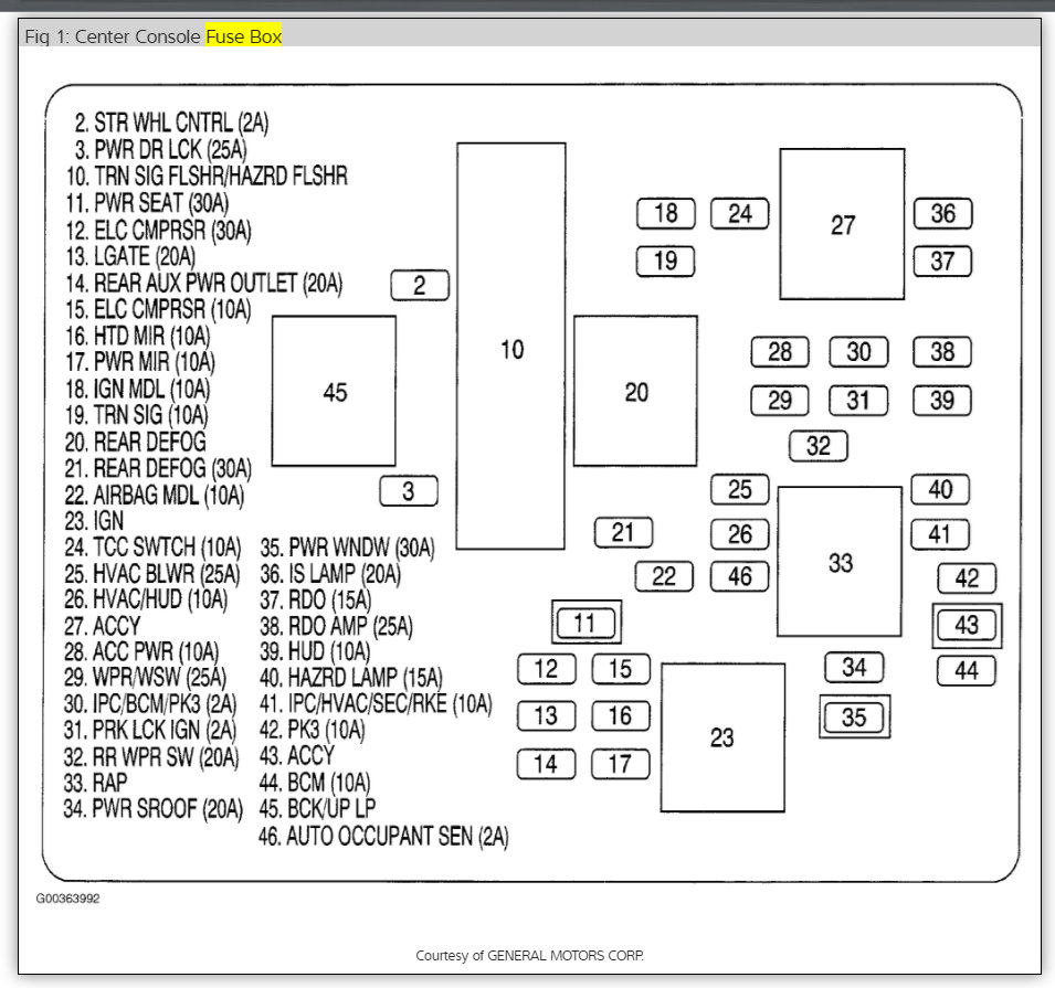

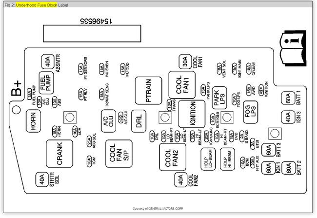

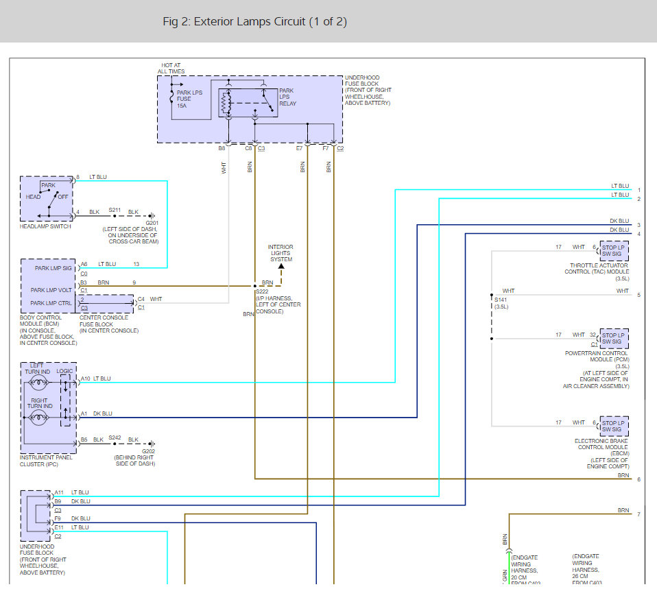

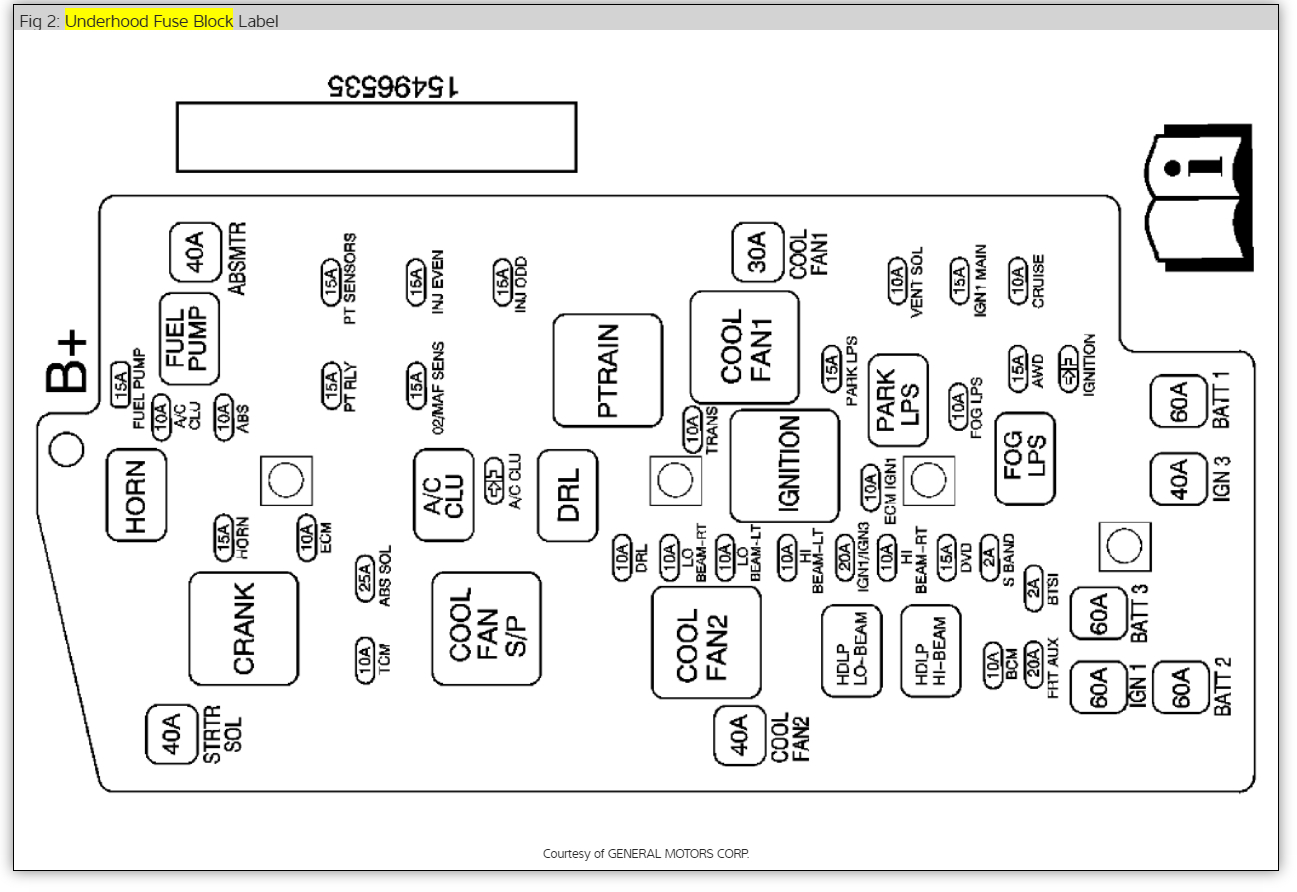

Where is the fuse for the brake lights located? nothing is listed on the list of fuses about brake lights.
Nov 4, 2017 at 12:08 AM
Experienced Mechanic
55,554 POSTS

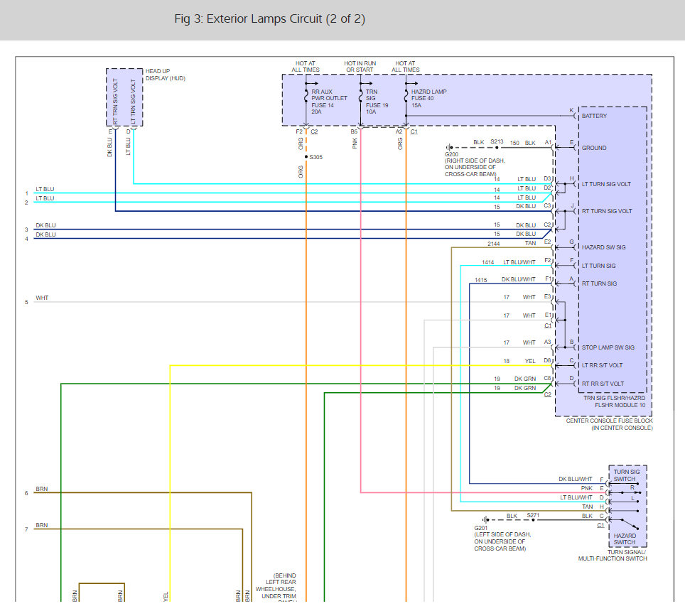

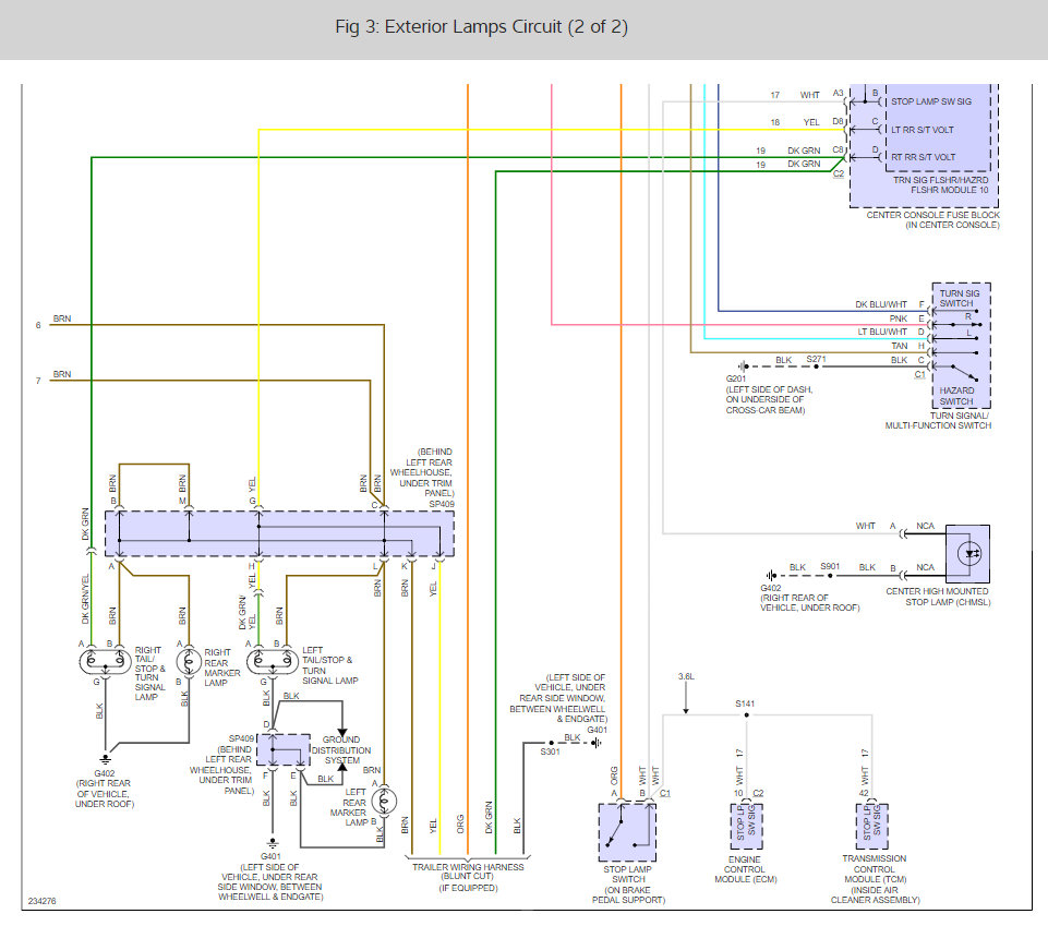

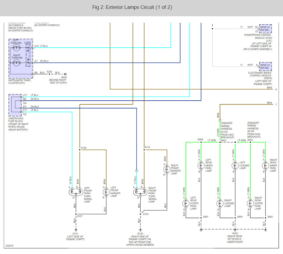

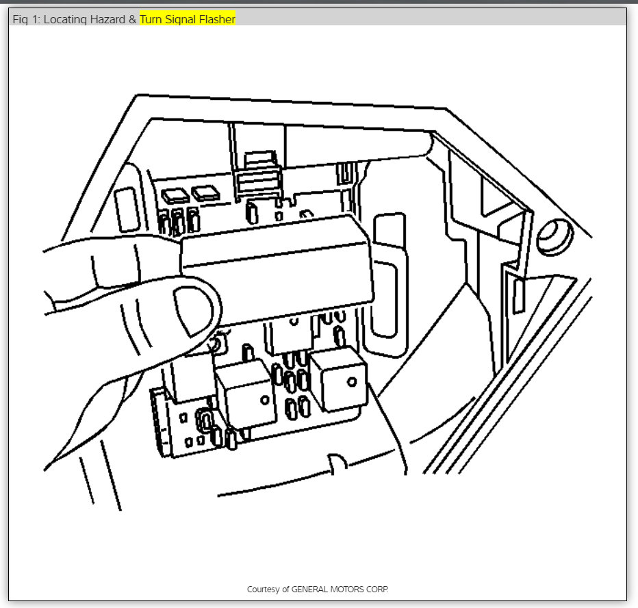

The problem is probably with the turn signal flasher module which control everything for the brake lights.
Here is a wiring diagrams and a guide so you can do a test to confirm:
Here is the location of the flasher as well and you should check all of the fuses:
