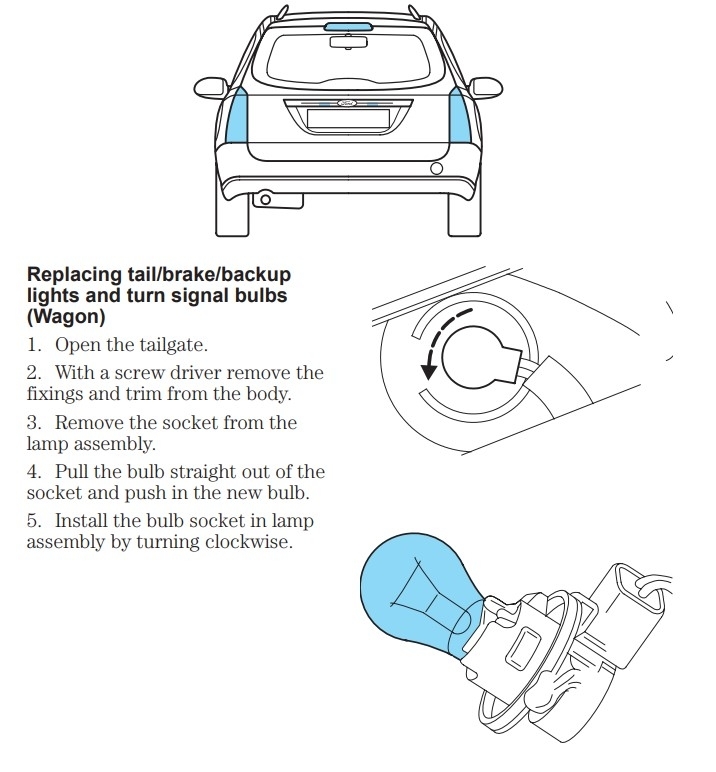

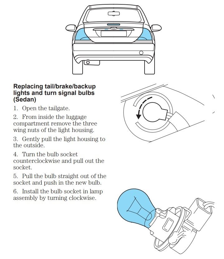

For your car the OE numbers for the rear brake lights and turn signals are 3157 bulbs. The reverse lights are either 3156 if it's the sedan or a 911 if it's the wagon or hatchback.

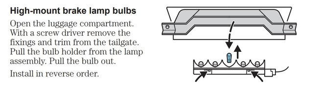

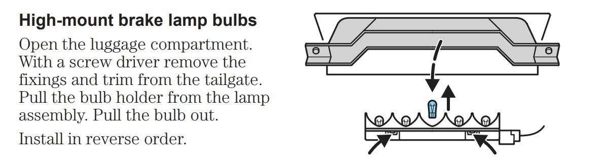

For the high mount brake light, it is a Wagner 17177, Phillips 12961 or equivalent.
Changing them depends on the vehicle, on the sedan the housing has to come out, on the wagon you remove the interior trim. The attached shows the process.
