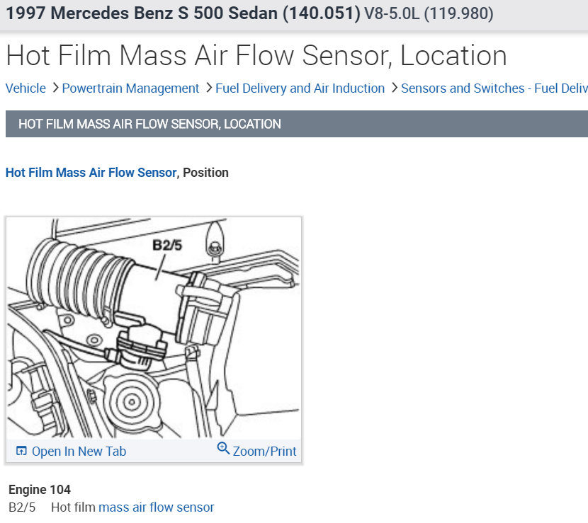

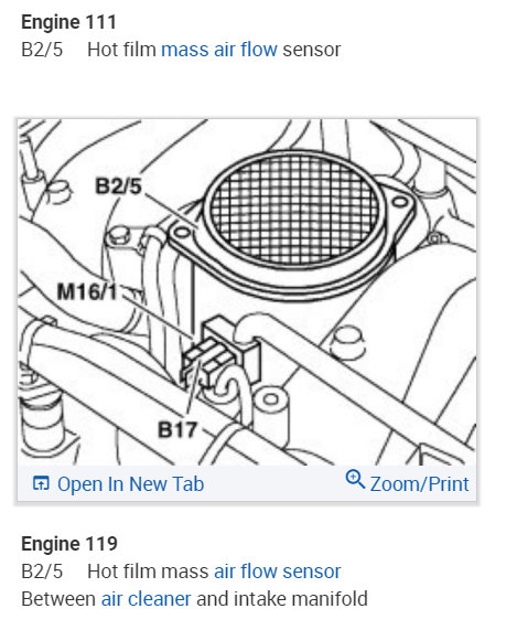

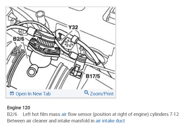

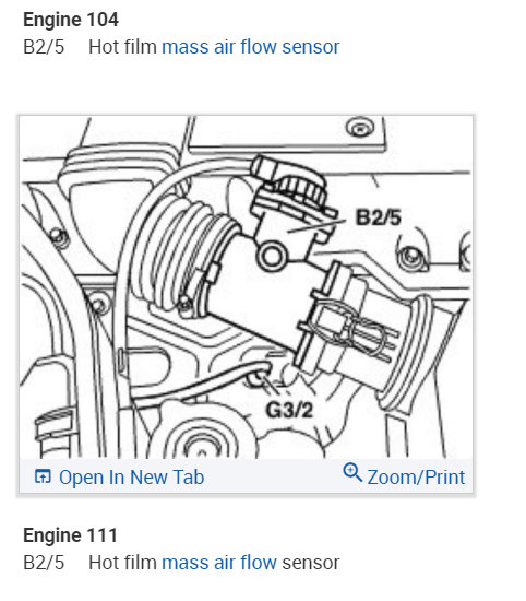

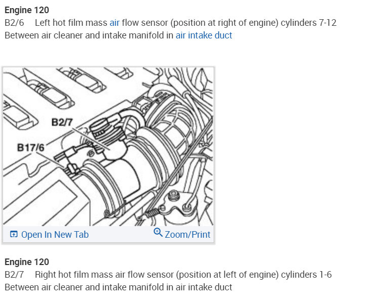

Does the engine seem to run okay? A bad MAF sensor can cause this issue as well. Here is a video and diagrams below to help you get the job done:
https://youtu.be/QOMiXhx2hbI
Mar 4, 2019 at 2:16 AM
GEORGE OBERMAYER
I can hardly see the writing on the diagrams, but I know my mass airflow sensor is on the throttle body right on top of the motor. I've replaced it already after I repaired the map sensor plastic tubing by putting a new hose on it longer. all of my dtc's are zero but I still have the brake light and then alarm any time that I throttle up or anytime at the rolling.
