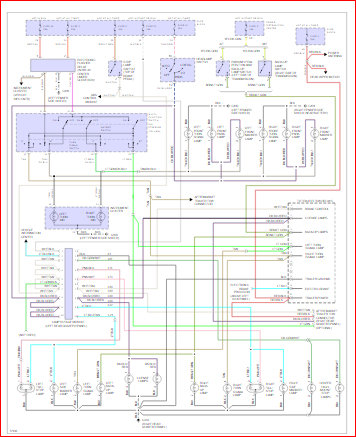

My driver side brake light does not illuminate when depressing the pedal. The passenger side and the third light both work. Fuse is good and I assume the brake light switch is good because the other lights work. Is it possible to jumper a wire from the other light to the driver aide and make it work? Tried testing but no luck.

Did you try replacing the bulb first? You might want to check the ground wire on that circuit side. Look for looseness/corrosion/etc. I have attached a wiring diagram for your truck and a few tutorials for you to view. Hope this helps and feel free to ask any questions if needed. Thanks for using 2CarPros.
