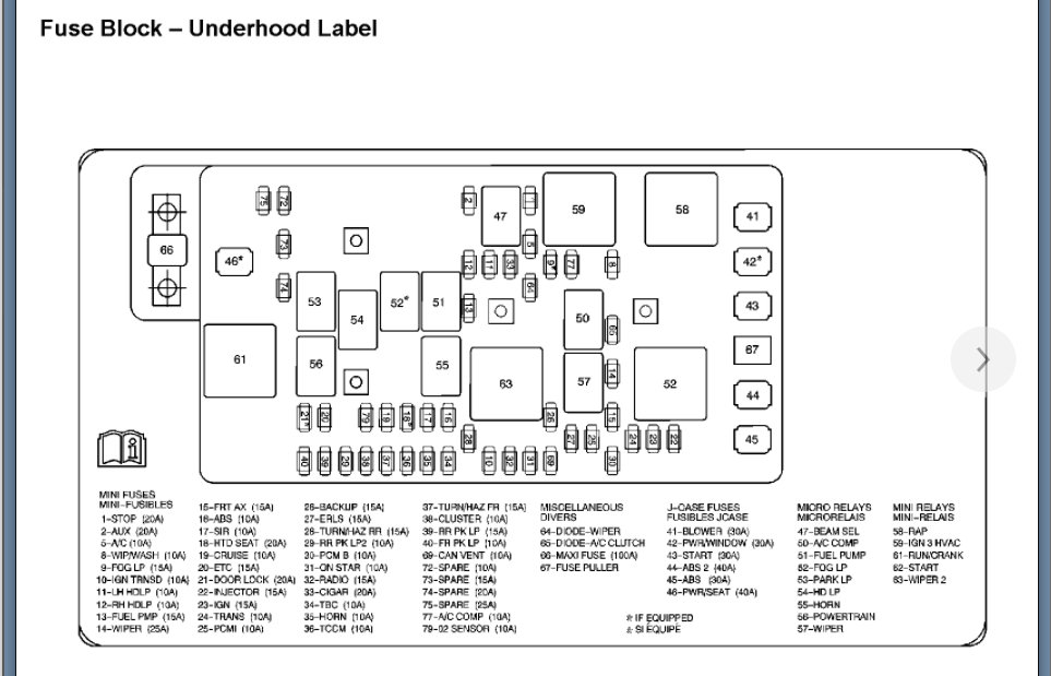

Left rear brake light not working but the running light works. I need to check the fuses where are they?

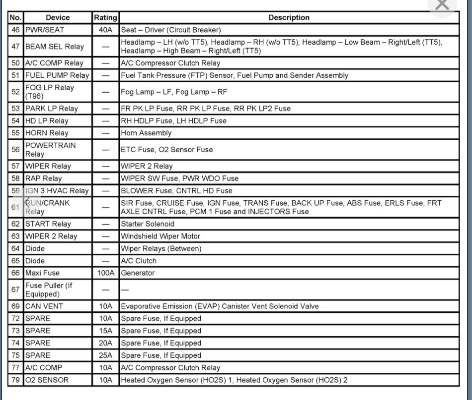

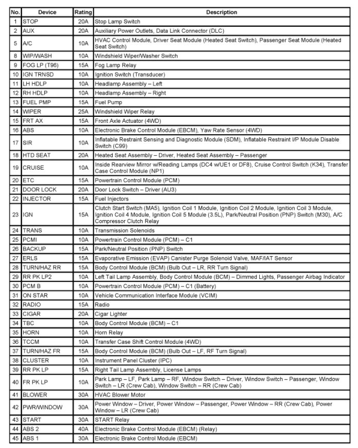

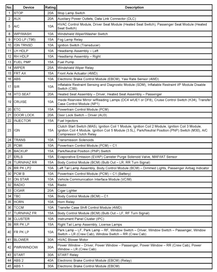

Here is a guide that will help with step by step instructions on how to test and replace the fuses:
Below is the info from the manual on the fuse location. Please let us know if you have other questions. Thanks
