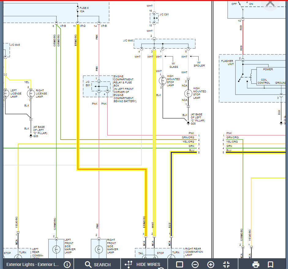

I replaced the right brake light's bulb and it still doesnt work. Whether I press the brake or turn on my headlights the right one won't turn on. The left one works fine. Any suggestions?
Sep 30, 2019 at 6:39 AM

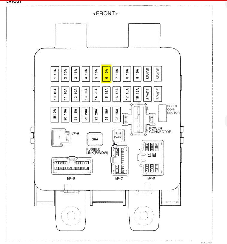

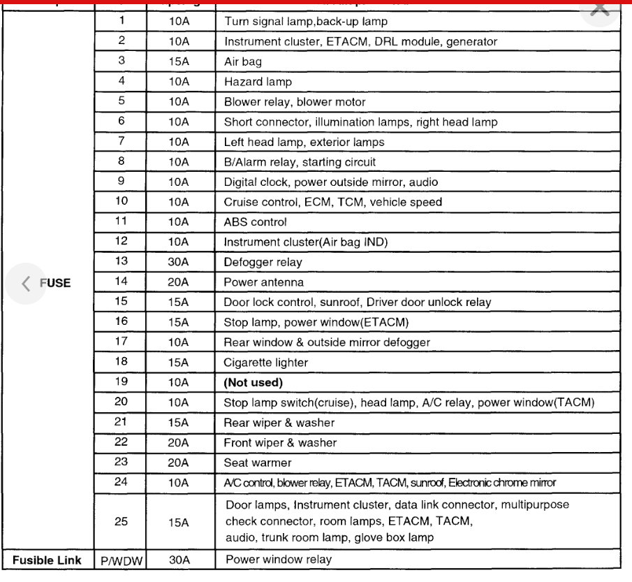

Just to clarify, the right side will not work on the front and rear? On the rear, the turn light and stop light don't work? If so, you need to check Fuse 6 under the dash on the left hand side. There is a fuse that controls each of these lamps. If this is not the case, please let me know exactly which lamps do not work.
Thanks
