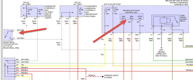

The bulbs are good. I replaced the brake light switch, checked the fuse, but i still have no brake lights at all. not the top little one nothing, but if I turn the big lights on those work in the back.

check the multiplex unit that may be the problem. it may be plug in or part of an assembly. This guide can help us with diagrams below.
https://www.2carpros.com/articles/brake-lights-not-working
Check out the diagrams (Below). Please let us know what you find.
