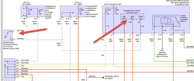

The bulbs are good. I replaced the brake light switch, checked the fuse, but i still have no brake lights at all. not the top little one nothing, but if I turn the big lights on those work in the back.
Jul 19, 2017 at 4:15 AM
HMAC300
  • 48,601 POSTS

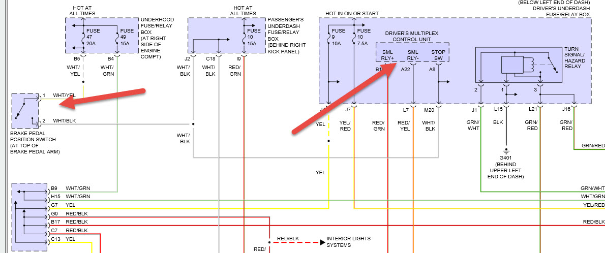

check the multiplex unit that may be the problem. it may be plug in or part of an assembly. This guide can help us with diagrams below.
https://www.2carpros.com/articles/brake-lights-not-working
Check out the diagrams (Below). Please let us know what you find.
