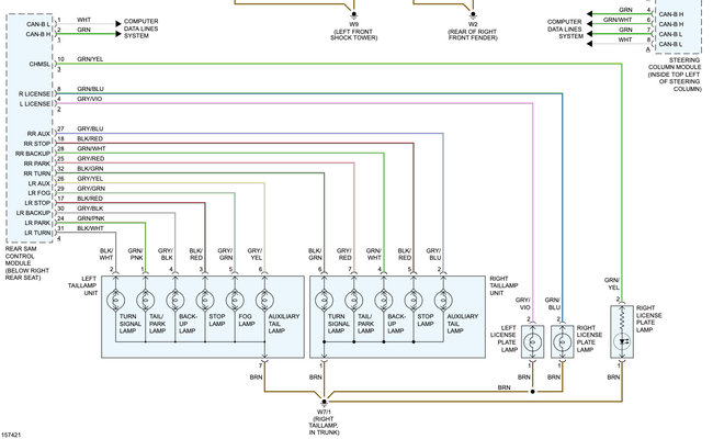

When i press the brake pedal my driver side brake light comes on then goes off.

TERRENCEJ
Yes, i have replaced all the bulbs and changed the tail lights with new ones. also the brake light that is acting up is ran off a circuit board not a bulb.

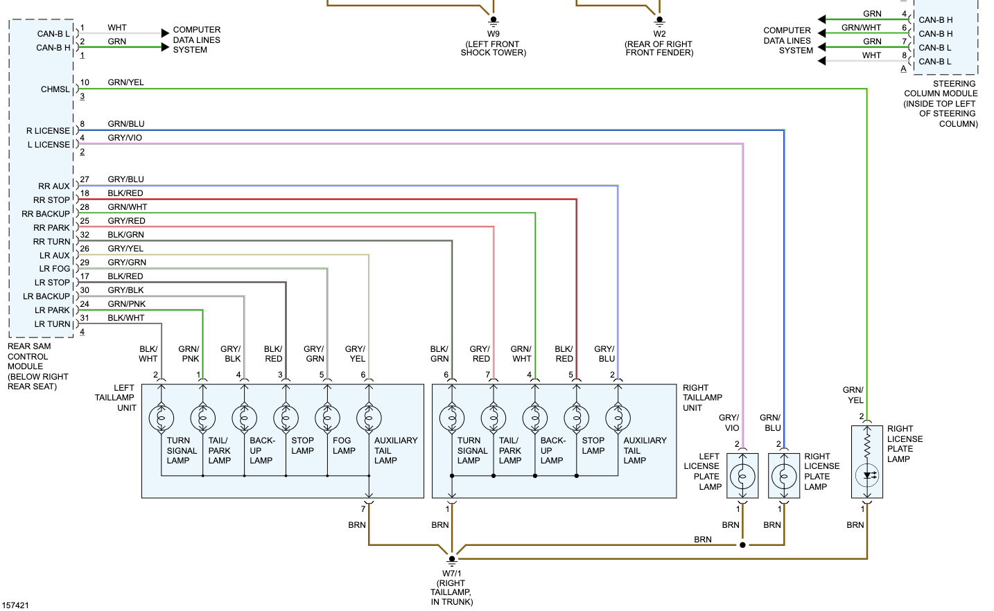

Hey TERRENCEJ,
I have attached the wiring diagram for the rear lights.
If the brake unit portion is an LED and you have already replaced the unit then you will have an issue with either power or ground to the brake light unit or a problem with the SAM module for the rear.
To begin i would get someone to operate the brake light and check for voltage between pin 3 and pin 7 on the light unit connector.
You will need a multimeter for this testing.
Let me know what reading you get when it initially comes on and then what it is with the pedal depressed but no light output.
Hope that helps.
The wiring diagram is attached to this message.
Regards, Joe
