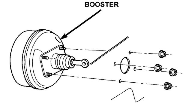

My brake light is on. I hear air escaping when I depress brake pedal, loud whoosh sound. Just replaced master cylinder last year and rear metal brake line yesterday because it was leaking. Is it the brake booster?

Good afternoon.
Yes, it does sound like the booster is the issue. Common issue for that noise.
REMOVAL
1. On RHD vehicles remove the coolant reserve/overflow tank. Refer to Cooling System.
2. Disconnect brake lines at master cylinder.
3. Disconnect wire at combination valve differential pressure switch.
4. Remove nut mounting combination valve bracket to booster studs and remove valve.
5. Remove nuts mounting master cylinder to booster studs and remove cylinder.
6. Disconnect vacuum hose from booster check valve.
7. Remove knee blocker under the steering column.
imageZoom/Print
8. Remove retaining clip that secures booster push rod to brake pedal.
Booster Mounting
imageZoom/Print
9. Remove nuts attaching booster to passenger compartment side of dash panel.
10. In engine compartment, slide booster studs out of dash panel, tilt booster upward, and remove booster from engine compartment.
11. Remove dash seal from booster.
