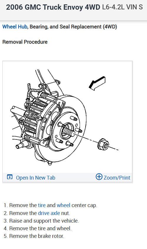

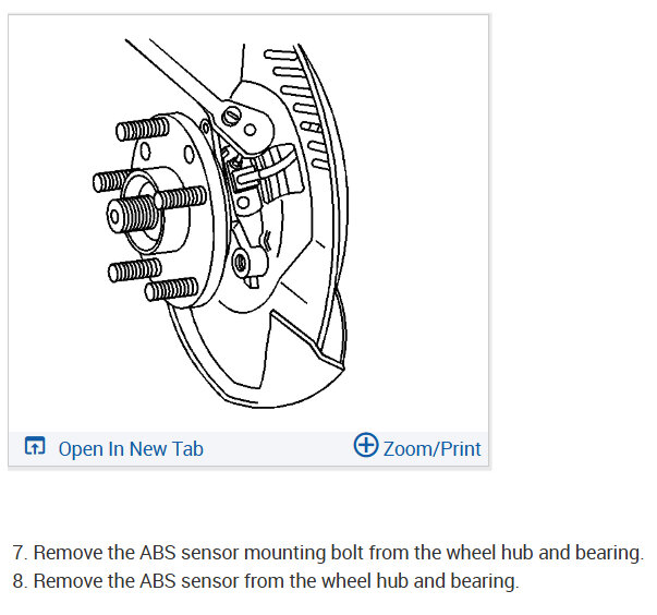

I am sorry to hear about your troubles, it sounds like the ABS system is kicking on which is common when one of the front bearing hubs is going out. do you hear a slight hum from the from end while driving? If so, this is a sign the bearing hub is bad. What happens is the ABS wheel speed sensor cannot read the reluctor wheel in the hub because it moves off center. Check out the images (below). Please let us know what happens.

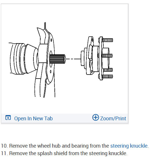

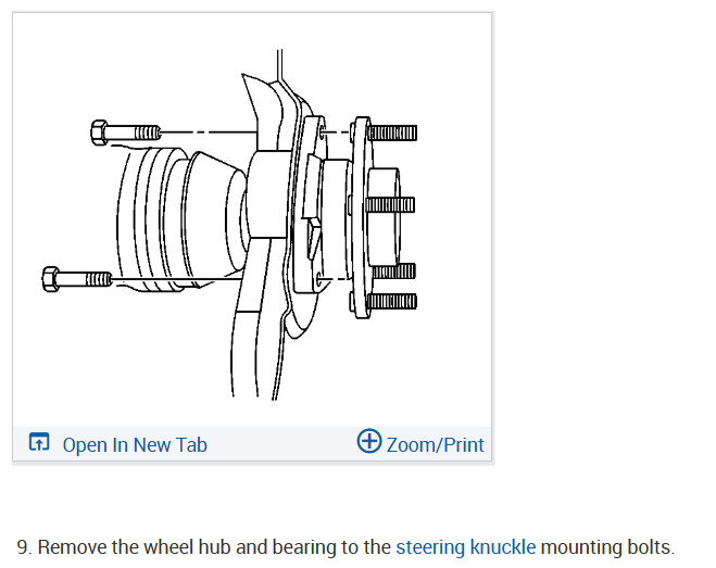

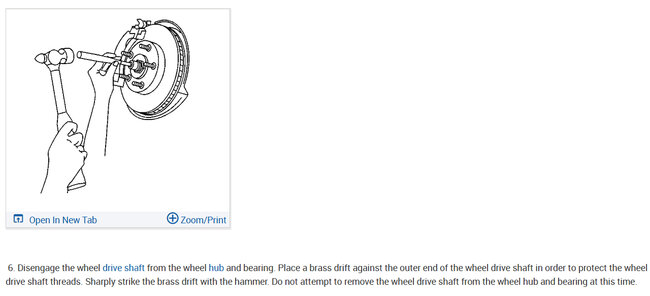

Okay, I would lift the front of the vehicle and grasp the top and bottom of the wheel to check for play, sometime when the bearing hubs go out, they don't make noise. This guide can help:
Please upload pictures or videos in your response of any problems so we can see what to help you with.
