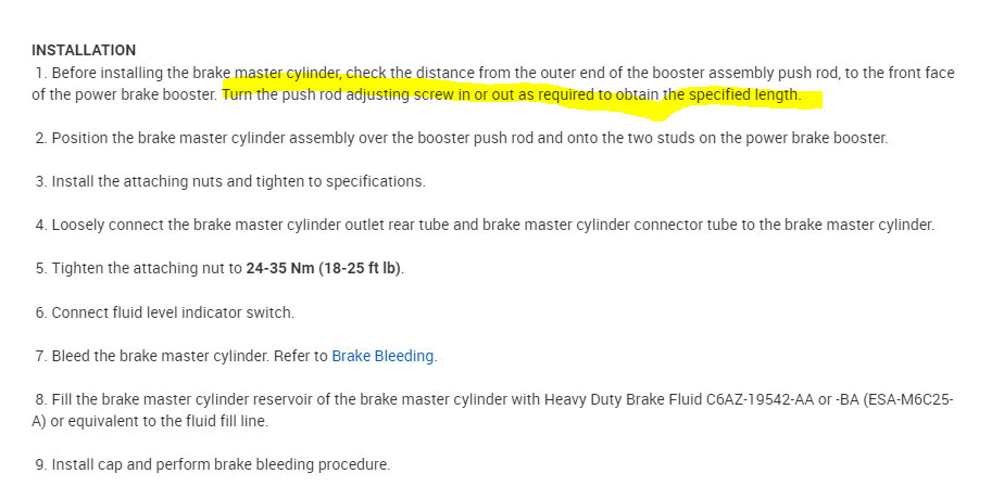

If you have replaced everything and they are doing this, something is likely causing them to slightly hang up. Do you notice it happens the longer you drive? I ask because if there is a slight drag, it will cause the brakes to heat up. As it heats up, the brake fluid expands and can cause the brakes to lock up.

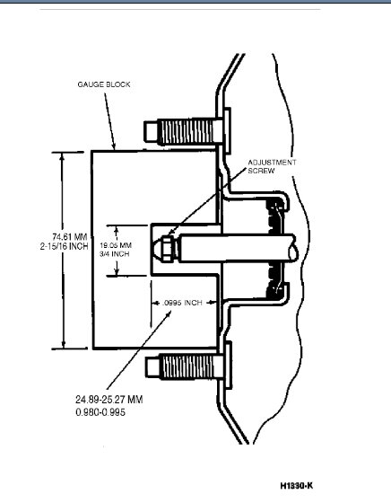

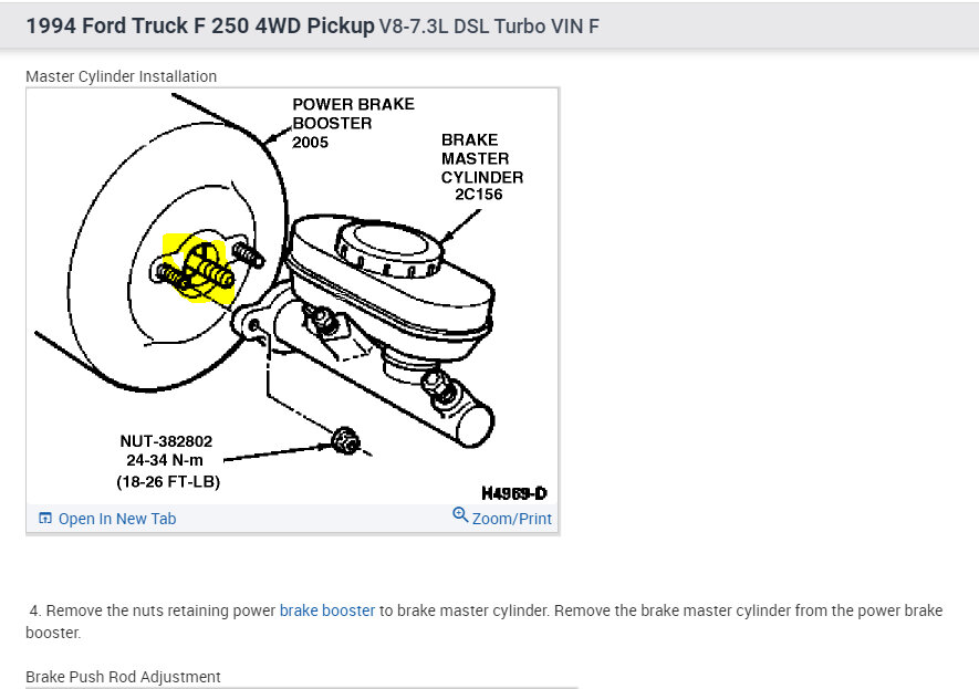

This leads me to a question. When you installed the new master cylinder, did you check the pushrod adjustment? If that is over extended, it can cause the brakes to drag.
Take a look at the directions below and let me know if this was done.
Dec 11, 2022 at 12:28 PM
