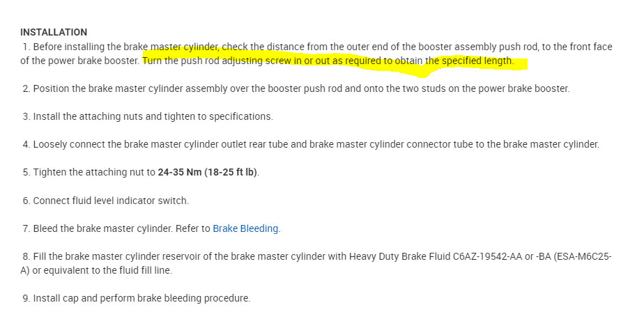

The brakes on my truck got extremely hot and locked up one day. i replaced everything on the brakes, including the master cylinder, brake booster, lines (except main lines running down the frame). Sometimes it will run fine and sometimes the brakes will hot and lock up. i have been dealing with this for over a month and i cannot figure it out. please help

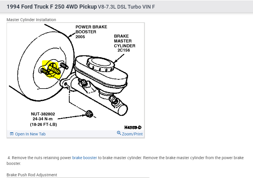

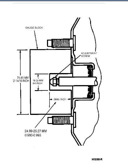

If you have replaced everything and they are doing this, something is likely causing them to slightly hang up. Do you notice it happens the longer you drive? I ask because if there is a slight drag, it will cause the brakes to heat up. As it heats up, the brake fluid expands and can cause the brakes to lock up.
This leads me to a question. When you installed the new master cylinder, did you check the pushrod adjustment? If that is over extended, it can cause the brakes to drag.
Take a look at the directions below and let me know if this was done.

Thank you for responding!!! For the most part it happens the more you drive but sometimes you can just go down the road. Also, it doesn't do it as badly when it's cold out. Yes, I have adjusted the push and am still getting the same result. Also, it's not always the same wheel locking up or getting hot, sometimes it's the front brakes or and sometimes it's one of the back ones. Not sure how hot it is too hot for the wheel to get. It varies from 90 to 220. I read on another post earlier about a park brake causing rear brake problems. My park brake wire is a little frayed. could that keep it from releasing all the way and causing my brakes to act crazy? I know this brake problem is about drive me crazy, lol.
