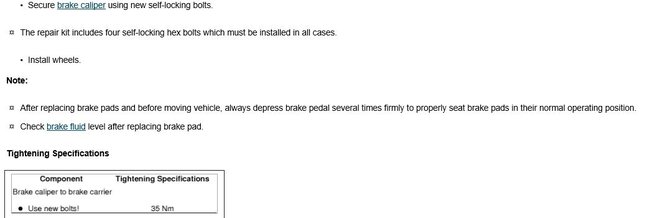

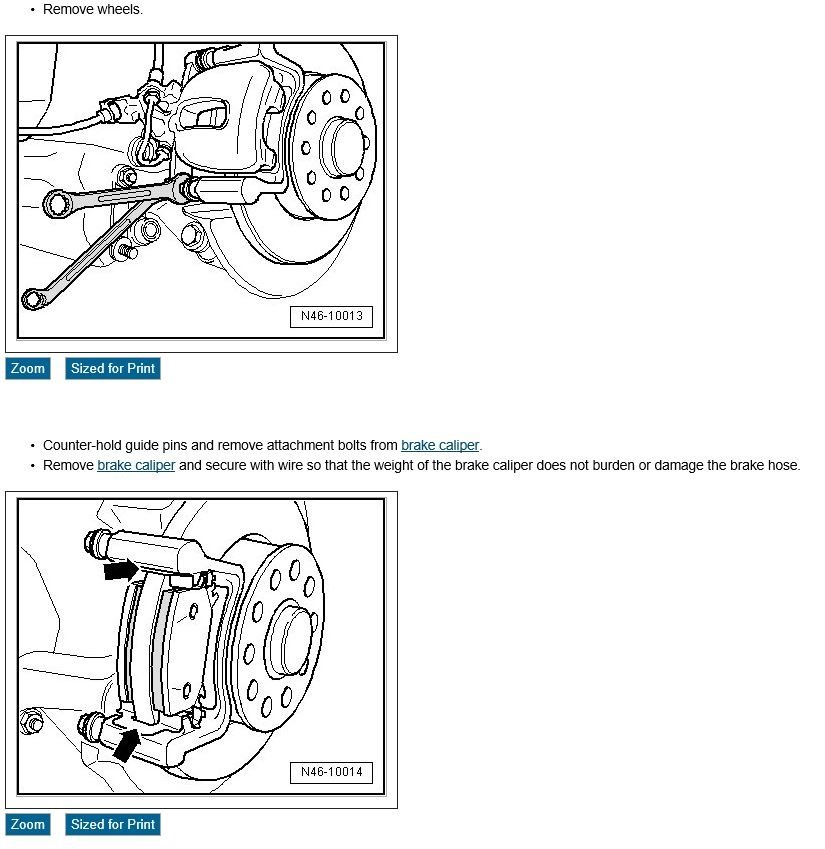

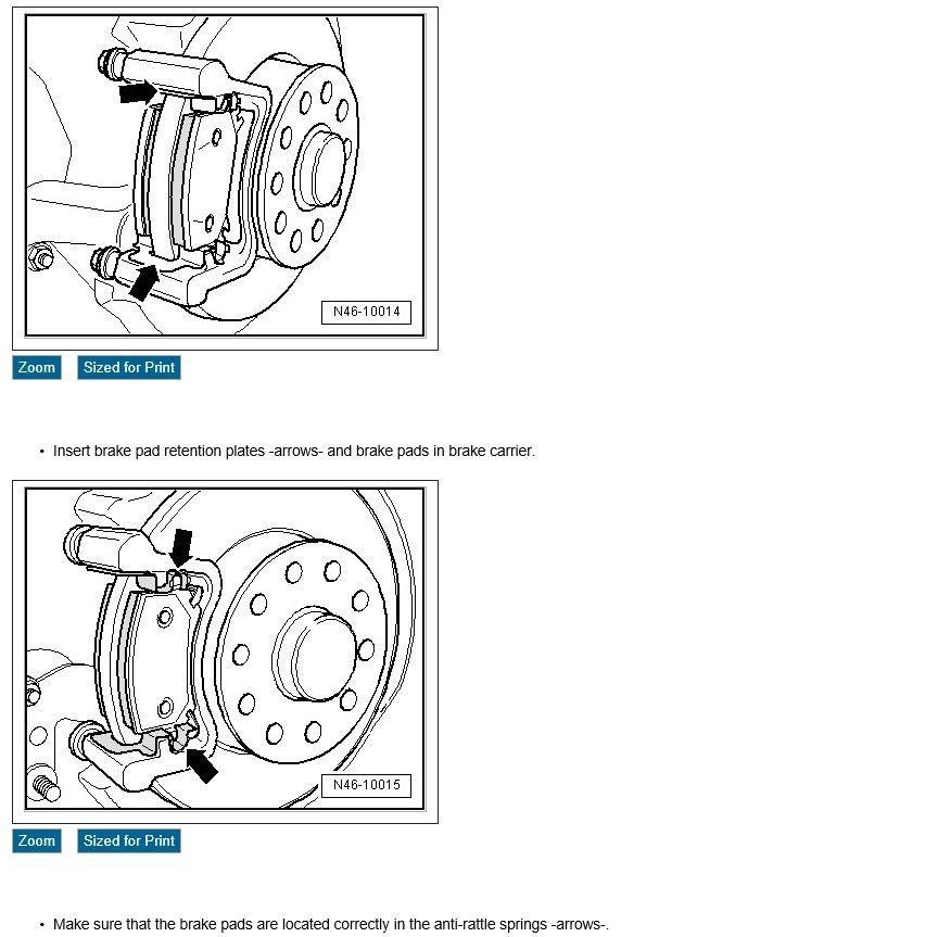

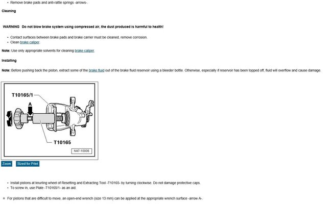

How did you adjust the caliper?
If you meant simply prying the warning tab back, then yes, it seems you are due for new pads.
