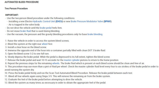

I recently had to replace my master cylinder. I've been flooded bled the brakes and still goes to the floor. I've also had to replace one caliper it was bled. everything on the system worked before and now I just can't get it to build any brake pressure.

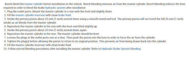

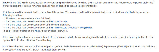

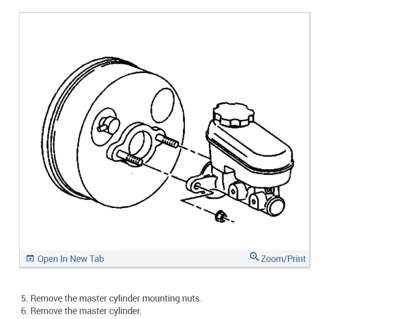

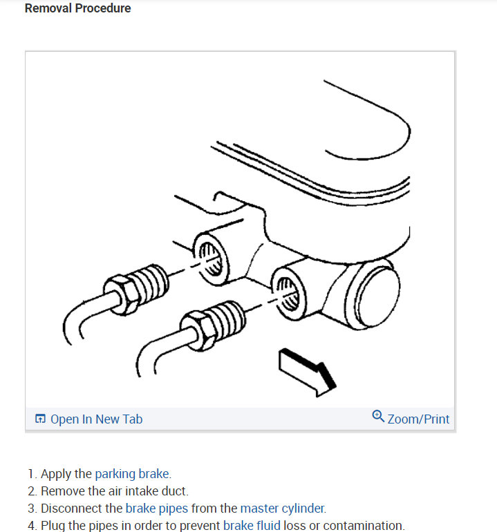

Good afternoon,
Did you bench bleed the master cylinder first before installing?
https://www.2carpros.com/articles/how-to-replace-a-brake-master-cylinder
You also need to do the automated bleed procedure for the ABS unit. You will need a scan tool that can perform this procedure. Without it, you cannot get the air out of the unit.
https://www.2carpros.com/articles/how-to-bleed-or-flush-a-car-brake-system
https://www.2carpros.com/articles/brake-pedal-goes-to-the-floor
I attached the procedure below.

Here's what I've done in order:
New Master cylinder was bench bled.
Installed new calipers, both were iffy at best. New lines to front calipers.
Bled entire system as per your service guide. Manually,then tried vacuum bleeding. Still no pressure. Replaced Master cylinder again. With new unit. Followed same bleeding process. Nothing. Used my Tech2 scanner to do automated bleed then vacuum bled entire system again. Still nothing. I'm completely stumped. In 30 years of being a mechanic I've never had one do this. I have no DTC codes,brake light is out as is abs warning light. And yes they have been checked to make sure they light. I'm at the end of my knowledge.

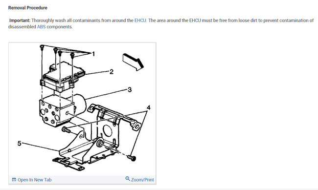

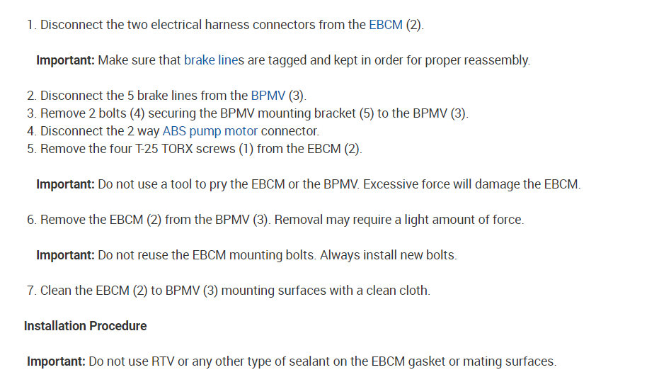

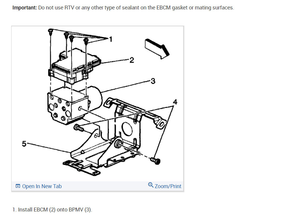

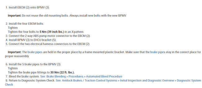

Okay, took the time to try your idea. Clamped off the rubber line helped some. Pedal still goes down quite a ways but it doesn't go to the floor. I have access to a know good ABS unit from a 2000 bravada parts car. Its has the 2 not the K in the 11th VIN position. Both were made in Moraine. Which makes a big difference on parts I've learned the hard way. Is it worth trying if so what's the do and don't on this vin stall. Never had the pleasure of changing the thing.
Jun 21, 2021 at 5:33 AM
Sure. Remember, it will need to be flashed to your car's VIN number.
I attached the procedure for the replacement below for you. Make sure you do the automated bleeding again when you are done.
https://www.2carpros.com/articles/how-to-replace-a-abs-controller
