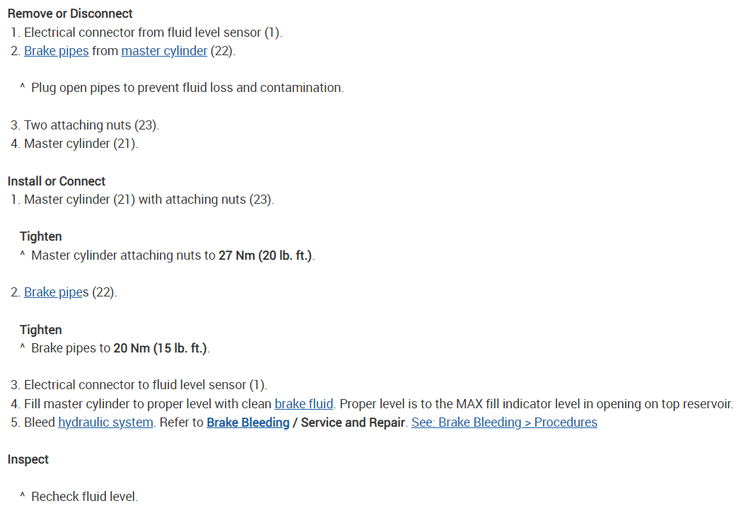

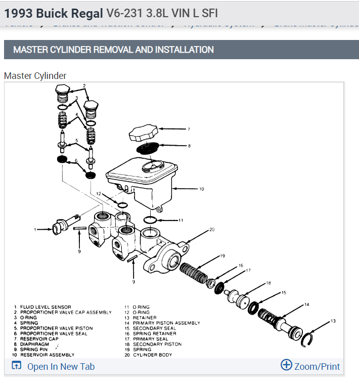

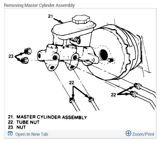

Here is a guide to help walk you through the steps with instruction in the images below to help you with your car:
https://www.2carpros.com/articles/how-to-replace-a-brake-master-cylinder

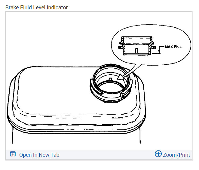

Because this master cylinder has four ports you may need to plug the two lower ports for bleeding or use four bleeder tubes. Check out the images (below). Please let us know what happens.
