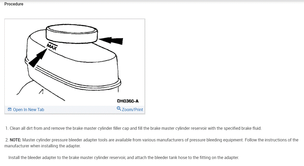

Replaced front pads, rotors, calipers, ABS pump and master cylinder. I bled everything; brake pedal goes to the floor but when I pump the pedal the brakes work. Where should I look next?
Apr 19, 2022 at 10:55 AM
  • 110,251 POSTS

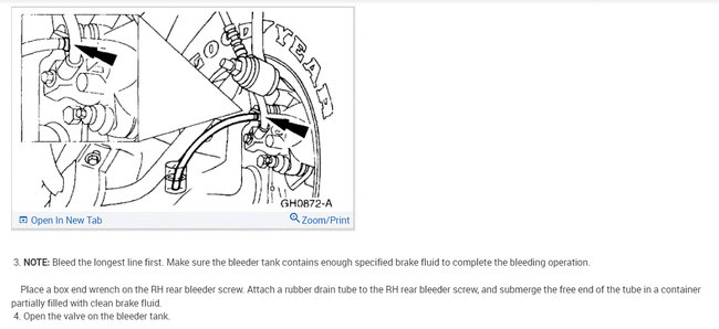

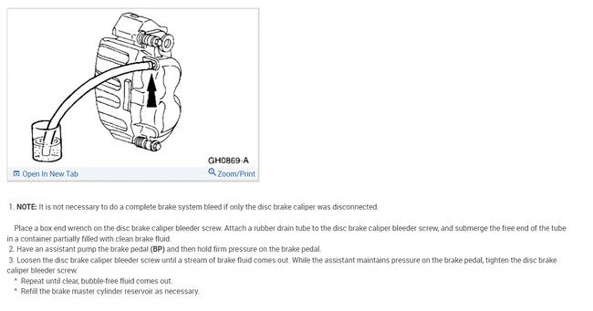

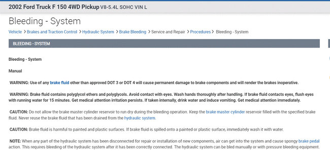

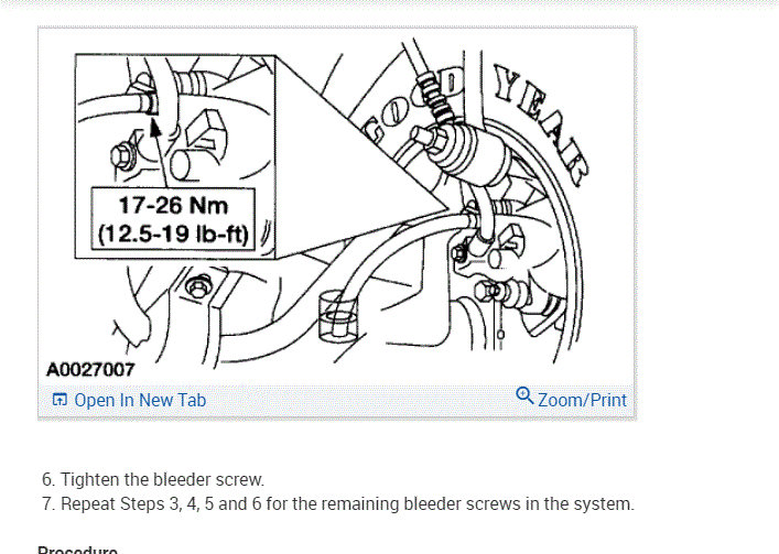

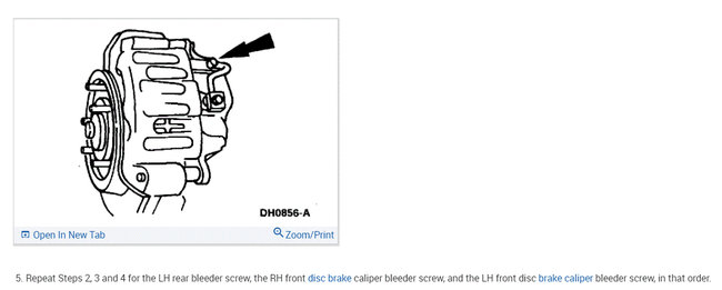

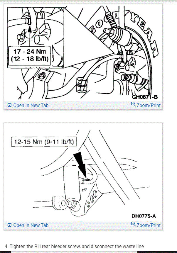

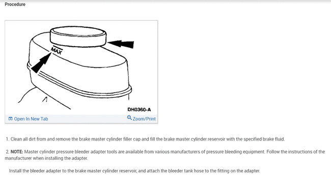

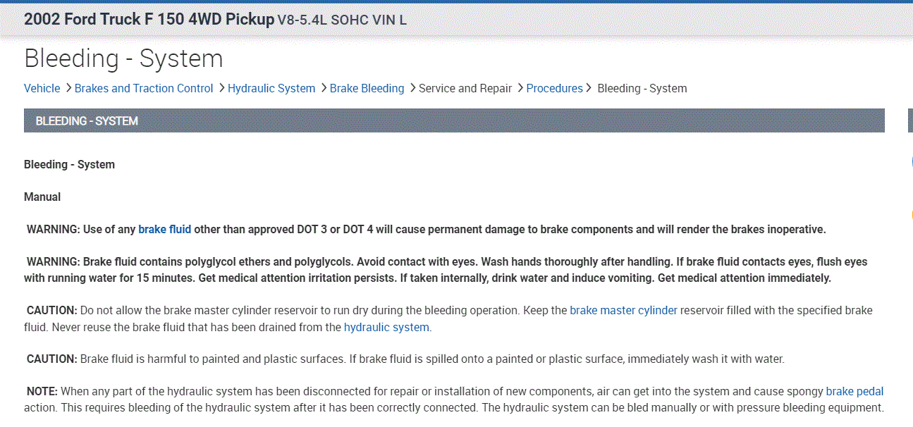

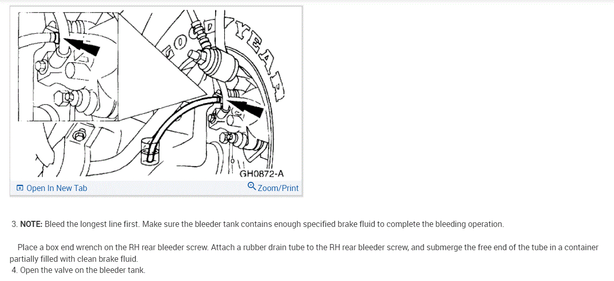

First, was this the issue prior to replacing the components? Also, I want you to do something. Turn the key off and pump the brake pedal to make it solid. Hold a steady amount of pressure on it and see if it slowly goes to the floor.
Also, I attached the bleed procedure from my manual. Take a look through it and let me know if there is anything you may have missed.

Okay, then it's unlikely there is a problem with the new MC. I suspect you still have air in the system. When you start the vehicle, you get the power assist which allows the pedal to reach the floor.
Did you bench bleed the new MC? Also, when bleeding, did you follow the directions listed above?

Yes, I followed the instructions on the bench bleeding the master cylinder. The only other thing I haven’t done is bleed the brakes while cycling the ABS pump. I also bled the brakes according to the instructions you posted twice before I asked any questions about what else could be wrong.

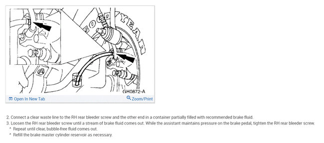

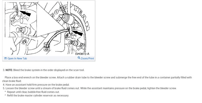

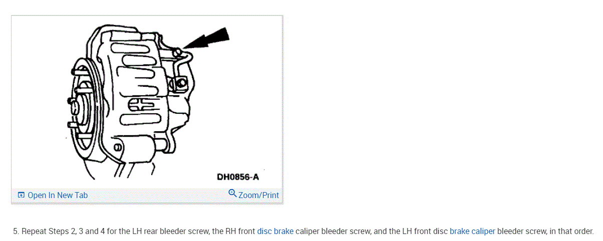

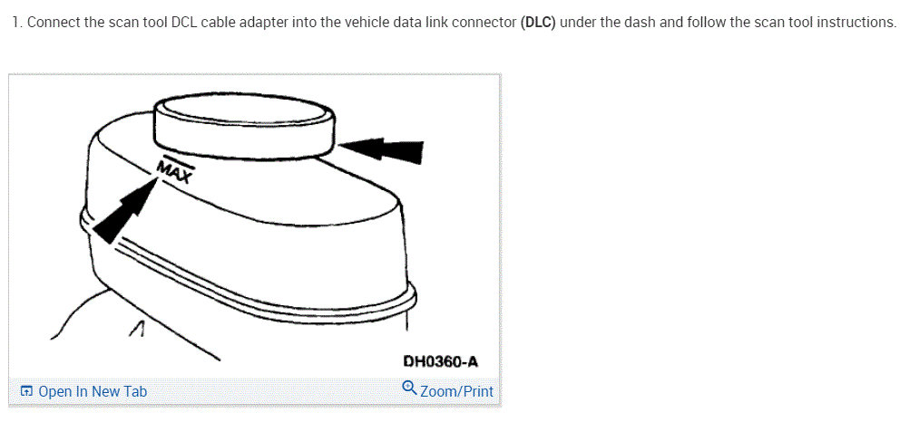

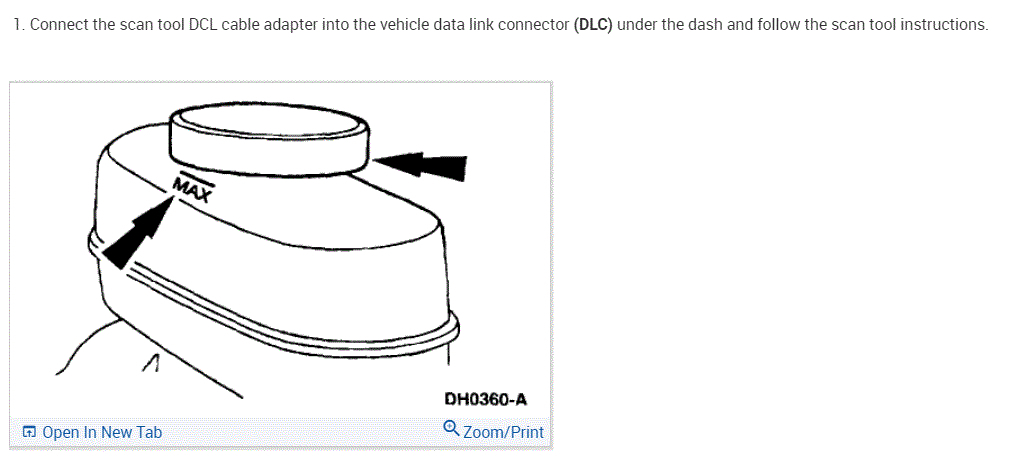

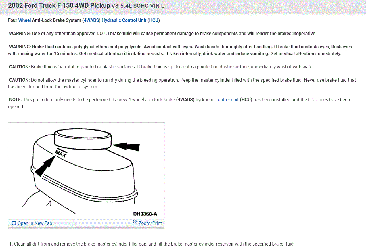

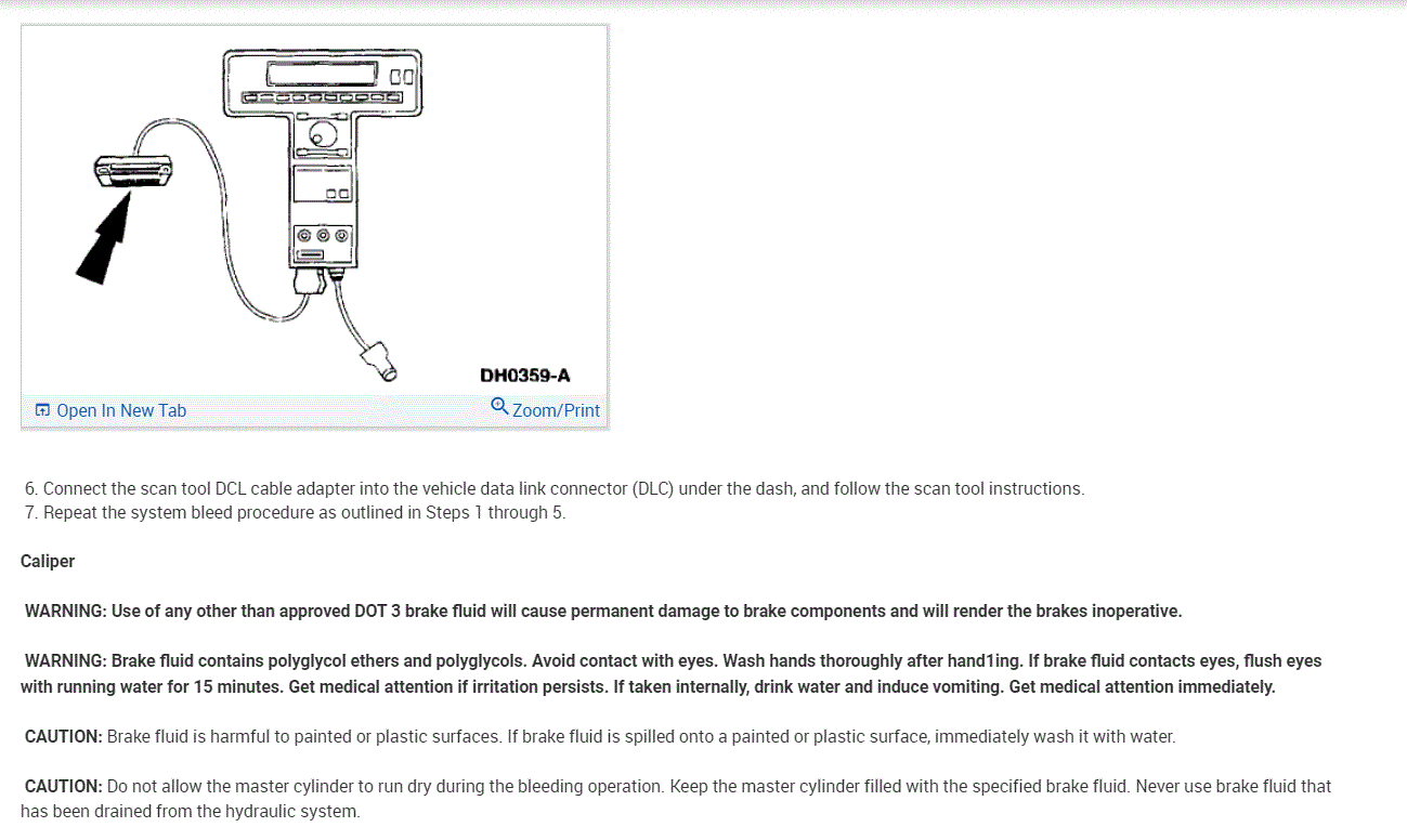

I suspect that is where there is air in the system, the ABS.
I attached the directions for bleeding the ABS. It requires a scan tool that can communicate with the ABS module.
Take a look through them and let me know if it is something you can have done or get the scan tool to do yourself.

My son has a scan tool we’re going to do it this weekend.

We bled the ABS pump and that didn’t change anything. At this point the only other thing is I’m wondering if I bought a master cylinder that is bad. After I replaced the Master Cylinder, I have a brake light on the dash that I didn’t have before. I’m going to return the one I installed and get another one to see if this is the issue.

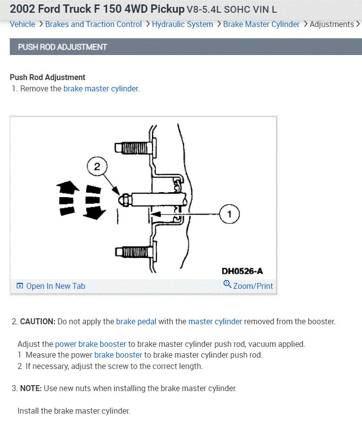

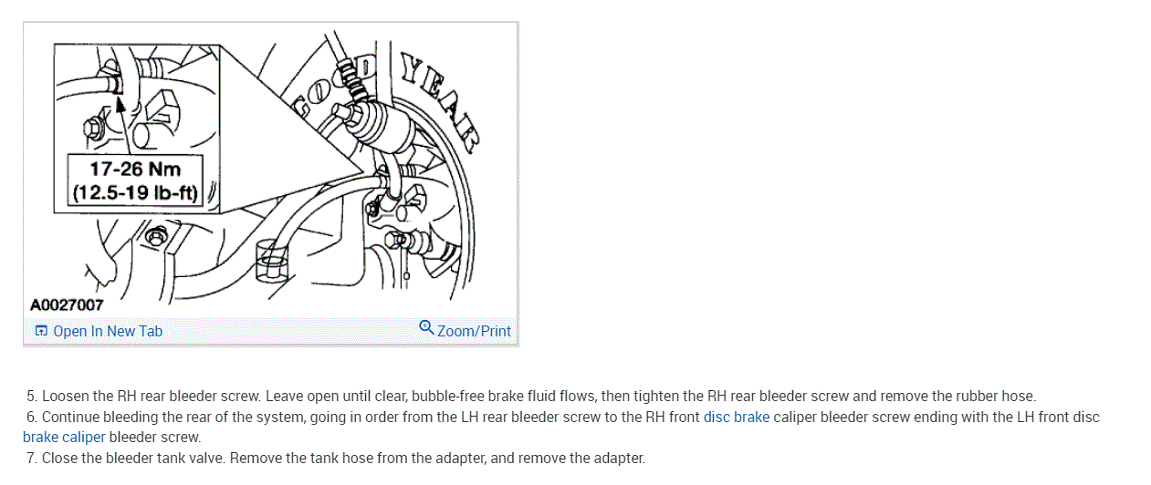

If there are no leaks and everything is bled, the only other thing I can think of is if the pushrod between the MC and the booster is out of adjustment.
I attached directions for adjustment below. Check this before returning the Master Cylinder.
Let me know what you find.
See pic below.

I checked the length of the push rod, and it is good. I then replaced the master cylinder. The brake light also went away. I also found the vacuum line to the power booster had a hole in it and replaced that. I need to bleed the brakes again, but the pedal still seems to go right to the floor when I first step on it. When I pump the pedal a few times it comes up and works close to normal. If bleeding the brakes doesn’t solve the issue, I’m not sure what to do next.

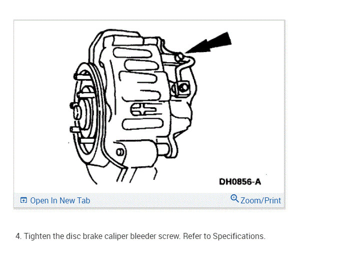

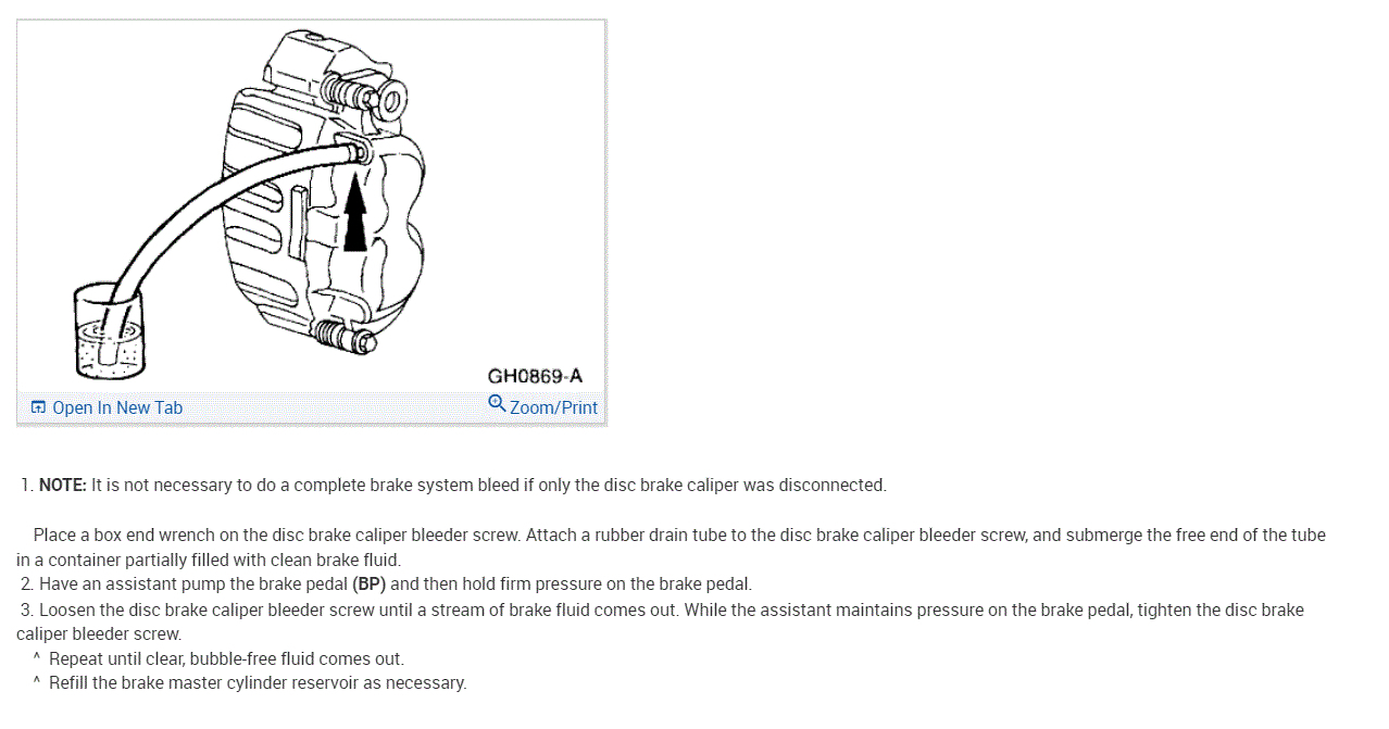

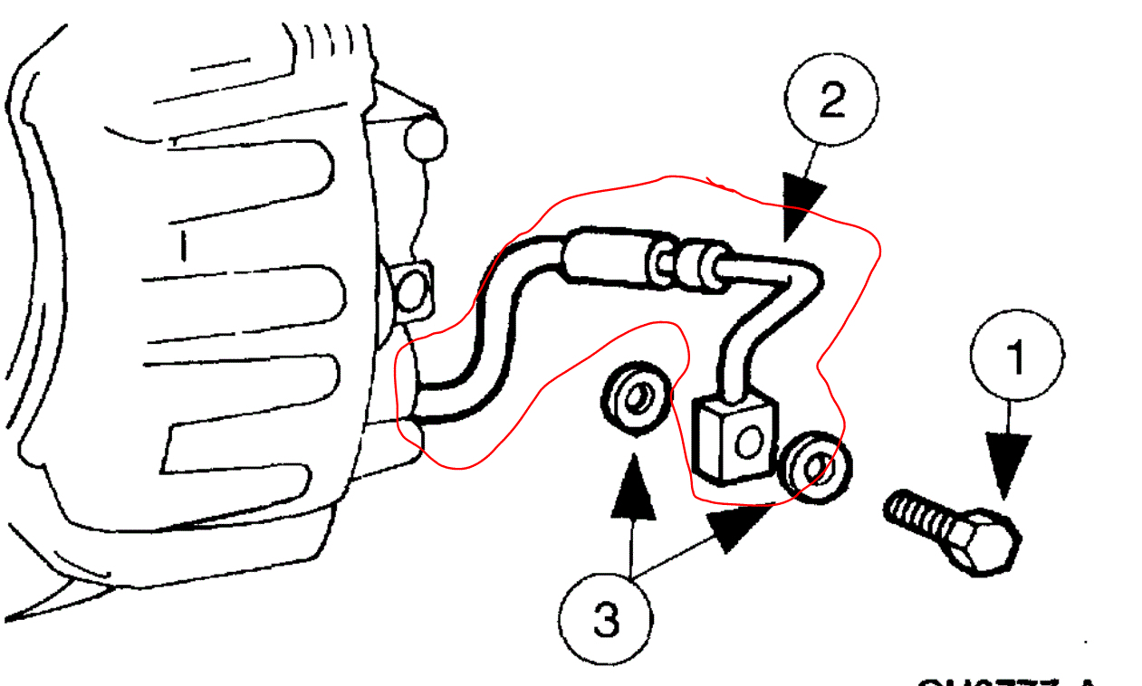

Thanks for the update. When you bleed it, make sure to also perform the automated bleed.
Also, and don't laugh, make sure the rubber brake hoses at the calipers aren't expanding when you apply the brakes. I've seen it happen twice in my life, but it can happen.
See pic below.

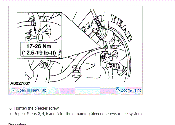

It’s still a little spongy I was talking with some who asked me if I was sure I had the calipers on the correct side after checking I think I switched them. I have the bleeders facing down and from the pictures they should be facing up.
May 3, 2022 at 8:54 AM
  • 110,251 POSTS
Absolutely that is the problem. You can't get rid of the air if the bleeder is pointing downward. It sounds like you found the problem. I know it can happen but never thought to mention it because you had done so much work, I assumed they were correct. Well, that is what happens when one assumes.
