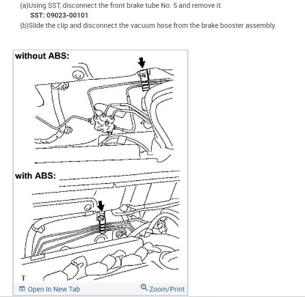

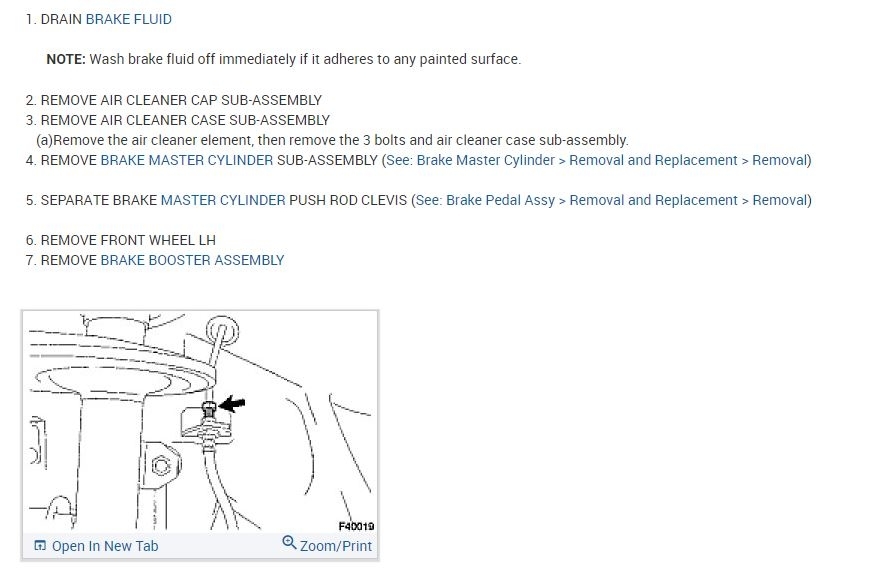

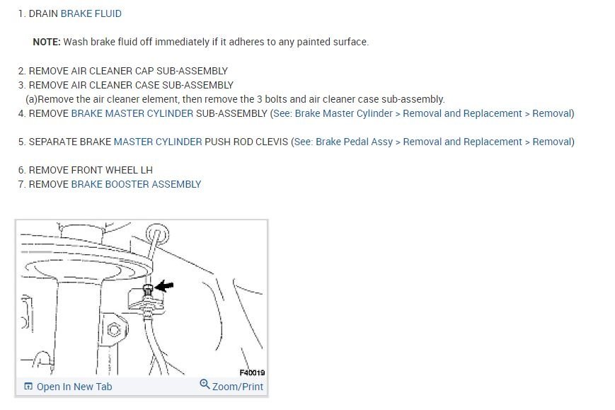

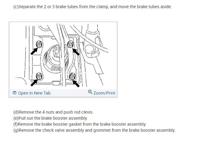

The hissing from the booster means the booster is leaking vacuum and must be replaced.
I attached the procedure with pictures below for you to view.
