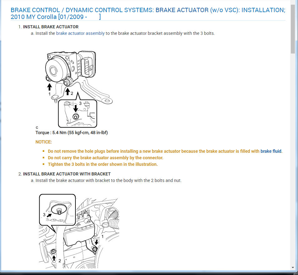

When I would apply the brakes while turning, a grinding noise would occur and I feel it tint he brake pedal. Can you help me replace the ABS module? Thanks
Sep 7, 2018 at 2:18 PM
Below you will find a guide that will help with this replacement:
https://www.2carpros.com/articles/how-to-replace-a-abs-controller

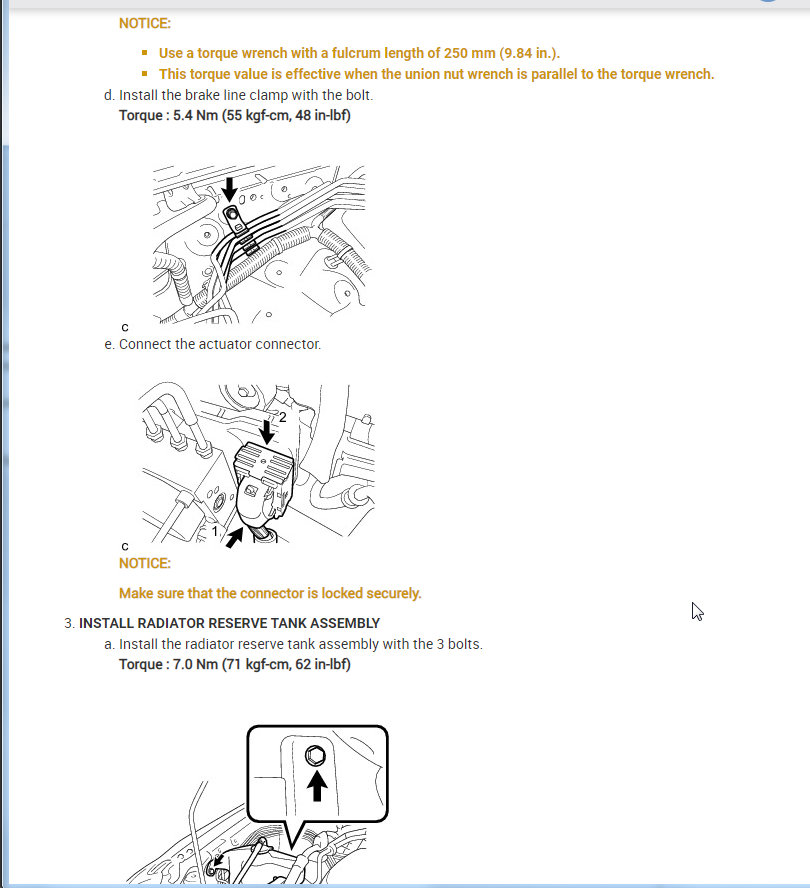

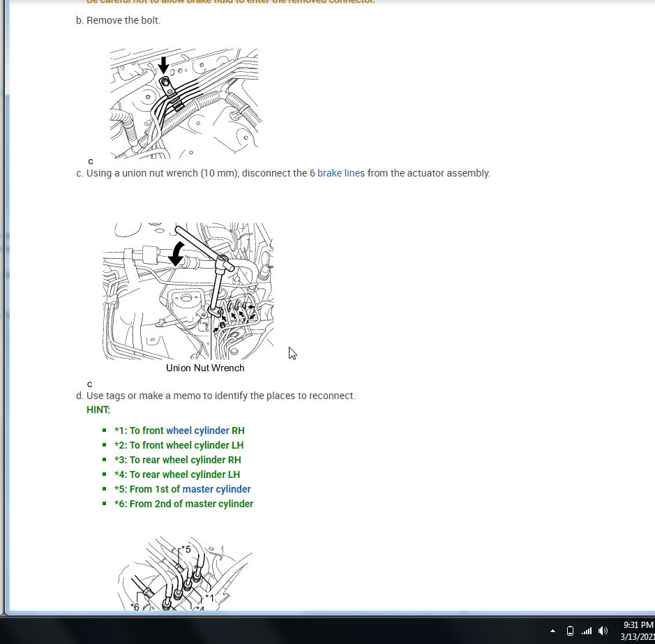

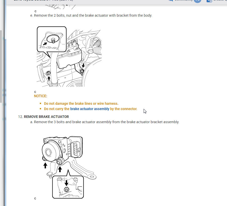

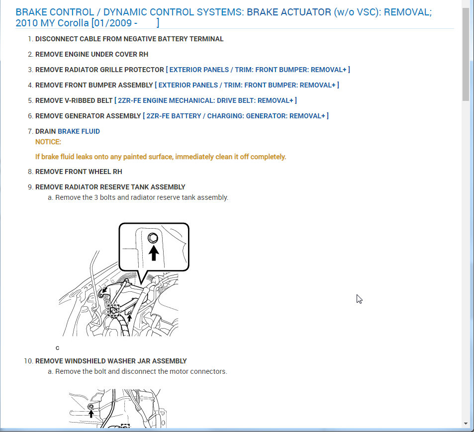

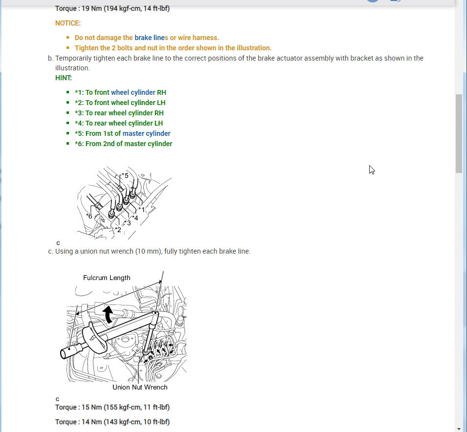

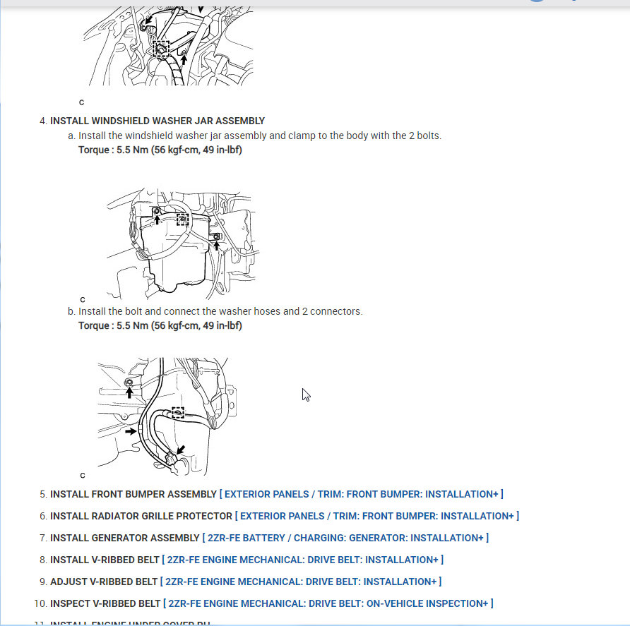

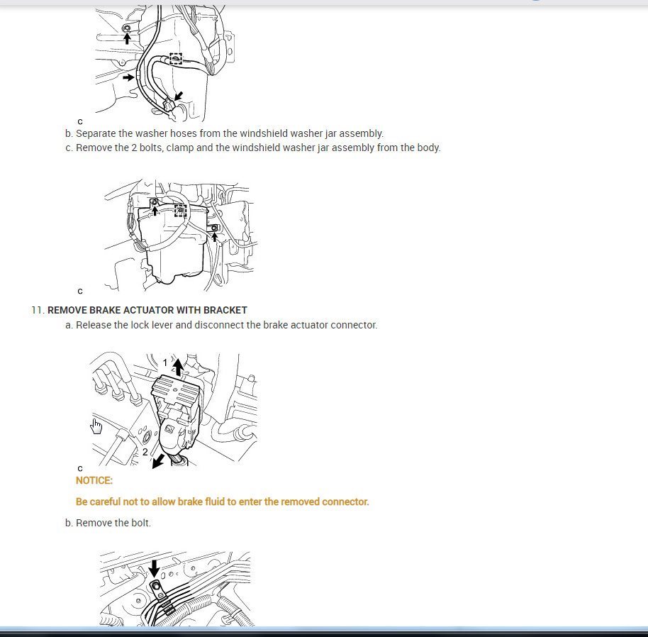

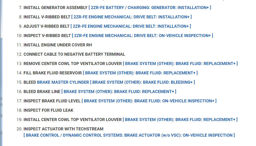

Below you will find the process on how to replace this from the manual.
Please run through this material and let us know if you have other questions. Thanks
