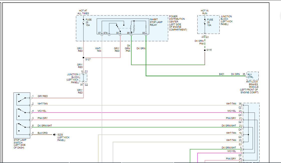

#25 brake fuse keeps blowing after pushing brakes. They light on for a split second then off. Fuse is blown. Took taillight off, wires look good. Does have trailer lights hook up.

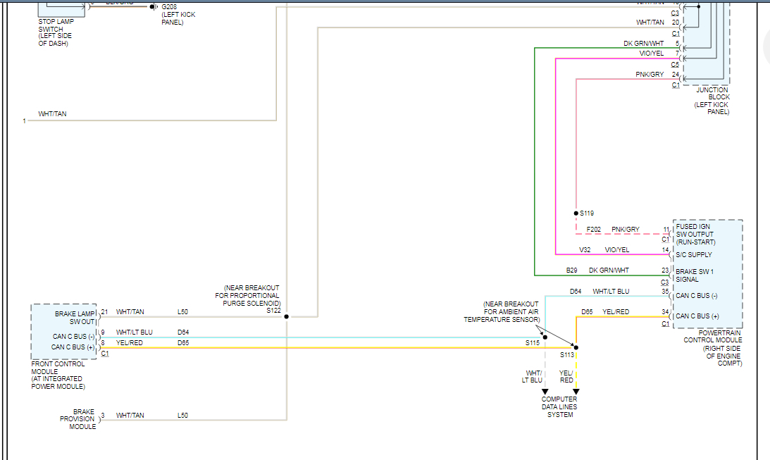

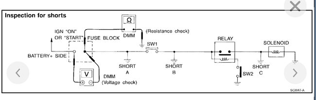

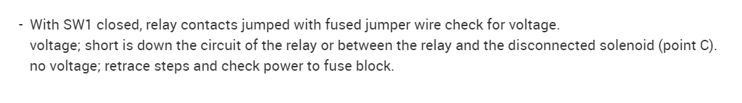

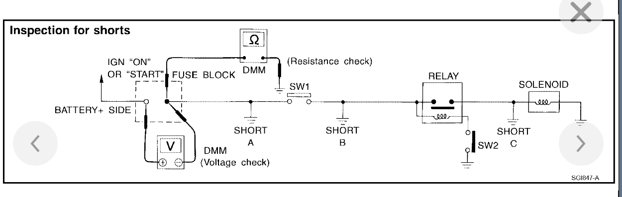

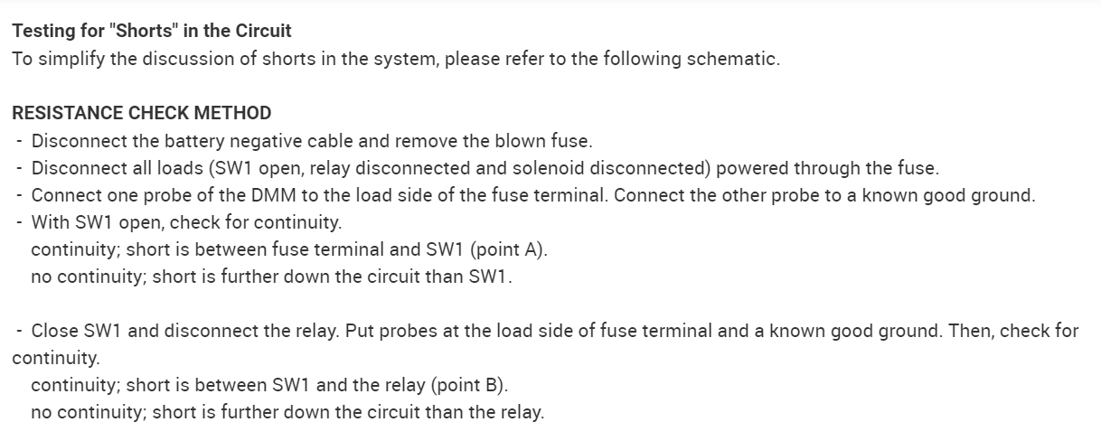

The fuse for the brake lights keeps blowing because you have a short to ground somewhere in the circuit that the fuse is protecting. In the diagrams down below I have included the wiring diagram for the brake circuit which includes fuse 25 and a guide on how to track down a short to ground in an automotive electrical circuit. You will need to use a Digital Multi-meter [DMM] to do this so I have also included a link to a guide on how to use one, if you are unfamiliar with the tool down below:
Please go through these guides and get back to us with what you are able to find out.
