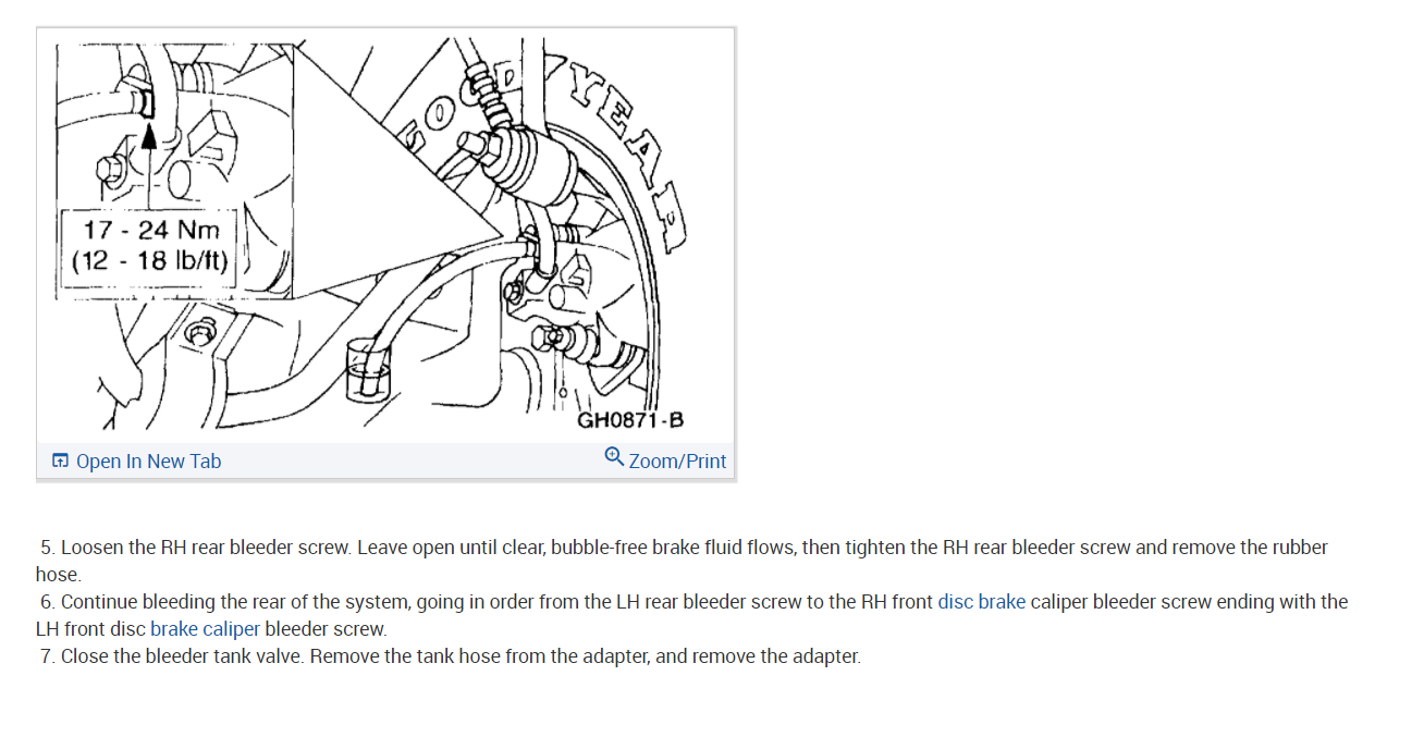

Replaced all brake components front and rear, master cylinder and brake booster on my van listed above e150, but i have a very soft pedal that goes to the floor when engine is running. also fluid is squirting out of the reservoir when the cap is off. i have bled the system a bunch and at all four wheels its a steady stream of fluid with no air being present. is this a bad master cylinder?
Apr 15, 2021 at 2:46 AM
Good afternoon,

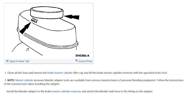

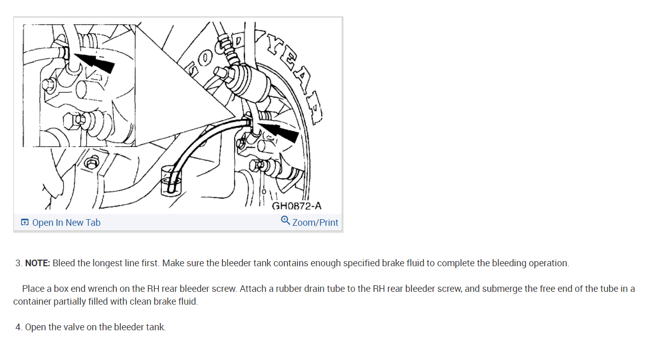

No, this is normal for having the cap off.
https://www.2carpros.com/articles/how-to-bleed-or-flush-a-car-brake-system
I attached the bleeding process for you below.
