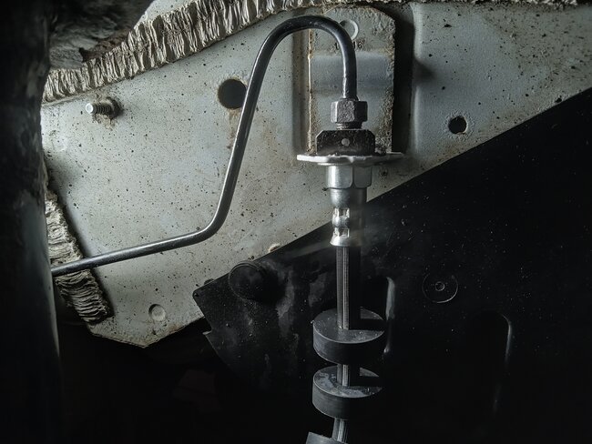

I replaced the front brake flex hose. brake fluid is seeping at the fitting between the hard line coming from the brake master cylinder and the flex hose. how to fix . i heard there is washer that i can put it at the bubble flare. if so where to buy

If you mean it is between the hard line and the fitting on the rubber line, Tighten the line nut down farther to compress the line tighter. The seal is formed as the line compresses into the seat inside the fitting, normally you tighten them until you achieve a leak free connection. If the line won't seal then take it apart and look at the seat in the line and the flare on the hardline, if you reused the hardline it may take more to seal because it was already deformed to seal in the old fitting. More than once I've had to reform the bubble on that style fitting because it was not able to seal.

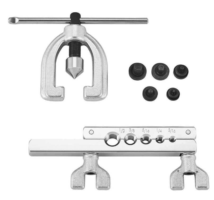

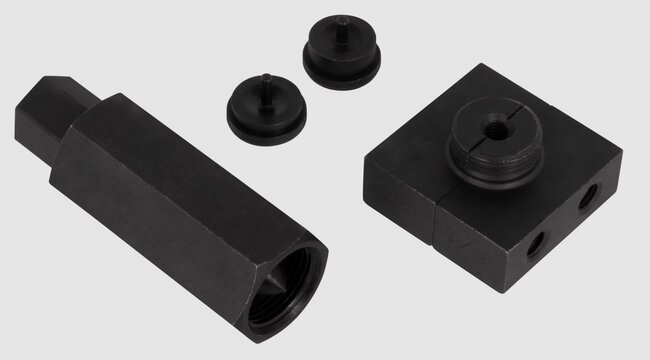

They are normally a one time use because the initial flare is slightly oversized and when installed they get crimped into the smaller size that seals them. However you can be fortunate and just tightening it down a bit stops the leak if the parts are close in fit. As far as the flare goes, a bubble flare is much easier than a double flare. The problem is usually having room to put the flare tool like the first image in place, however there are flaring tools that you can get as a loaner tool that look like the second image that are much easier to use. You just need the tools to tighten the tool in place and rotate the anvil part to make the proper flare.
