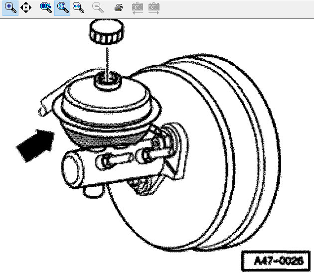

I was draining the fluid out of my brake fluid reservoir, and half is inaccessible.
It has a baffle. Does it drain? How to you drain and refill if at all?

You need dot 4 type brake fluid about 1 liter(33.8 oz), remove all 4 wheels, open the brake fluid reservoir fig 1.
note: the brake fluid reservoir must be kept adequately filled to prevent air from entering the brake system through the reservoir.
use US 1116 brake bleeder tool.
connect the tool on the brake fluid reservoir and switch on. the sequence described below must be followed for all four brake calipers.

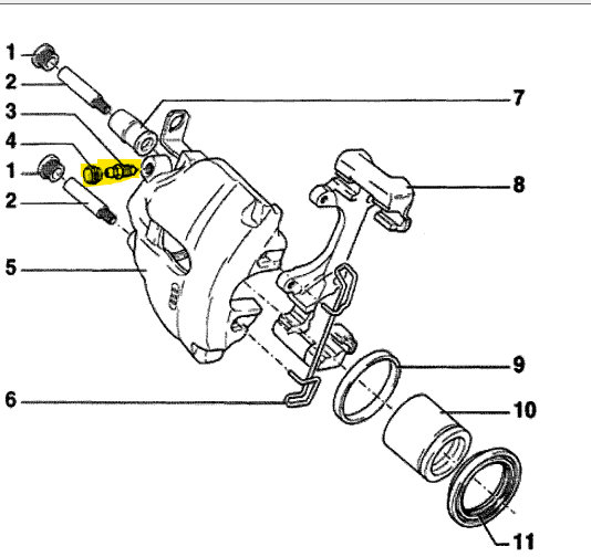

fig 2 front caliper bleed screw location.

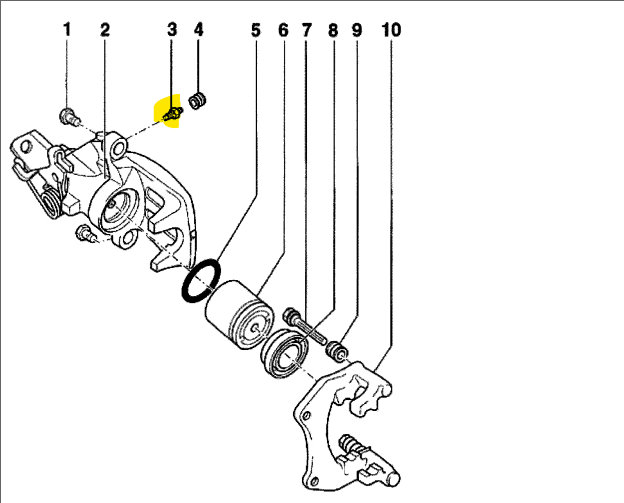

fig 3 rear caliper bleed screw location.
