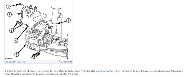

Brake fluid leaking at banjo bolt in caliper
2008 DODGE CARAVAN
150,000 MILES • 3.8L • 2WD • AUTOMATIC
KRISTEN LEANNE
Just put on new brake line, new calipers, new rotors, new brake pads. Brake fluid is leaking at banjo bolt and appears to be coming out of the caliper side.
Jul 25, 2021 at 2:57 PM
Good evening,
Did you replace the copper washers for the line? If you did not, they need to be replaced. They are 1-time use washers. They crush only one time.
If you do not tighten it enough, it will leak.
