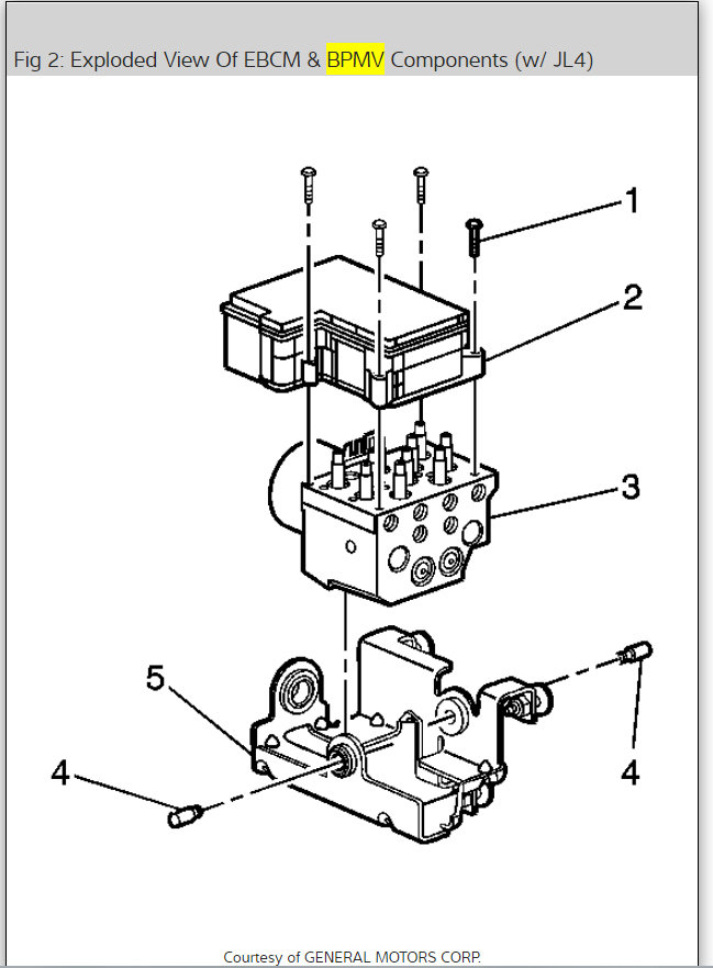

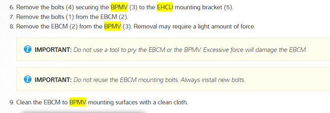

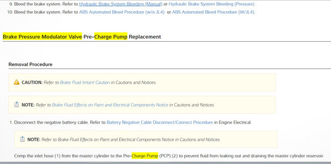

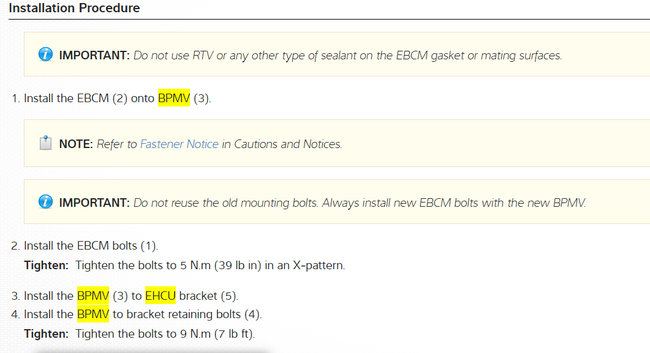

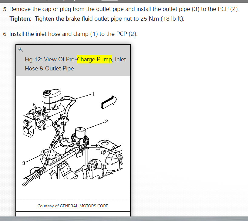

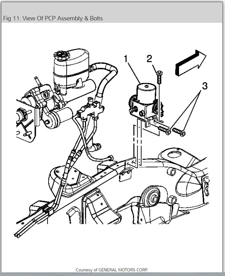

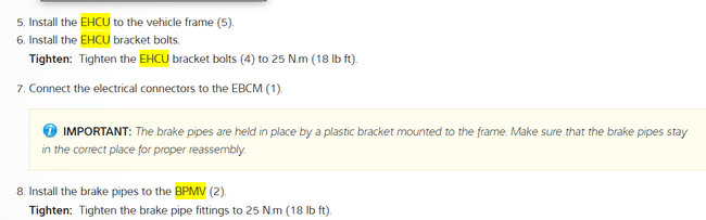

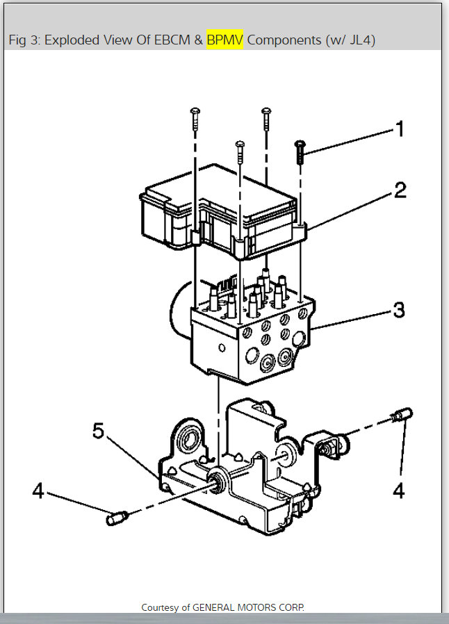

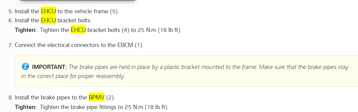

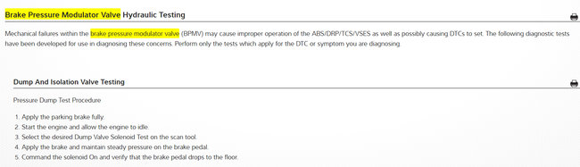

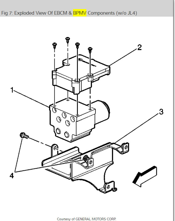

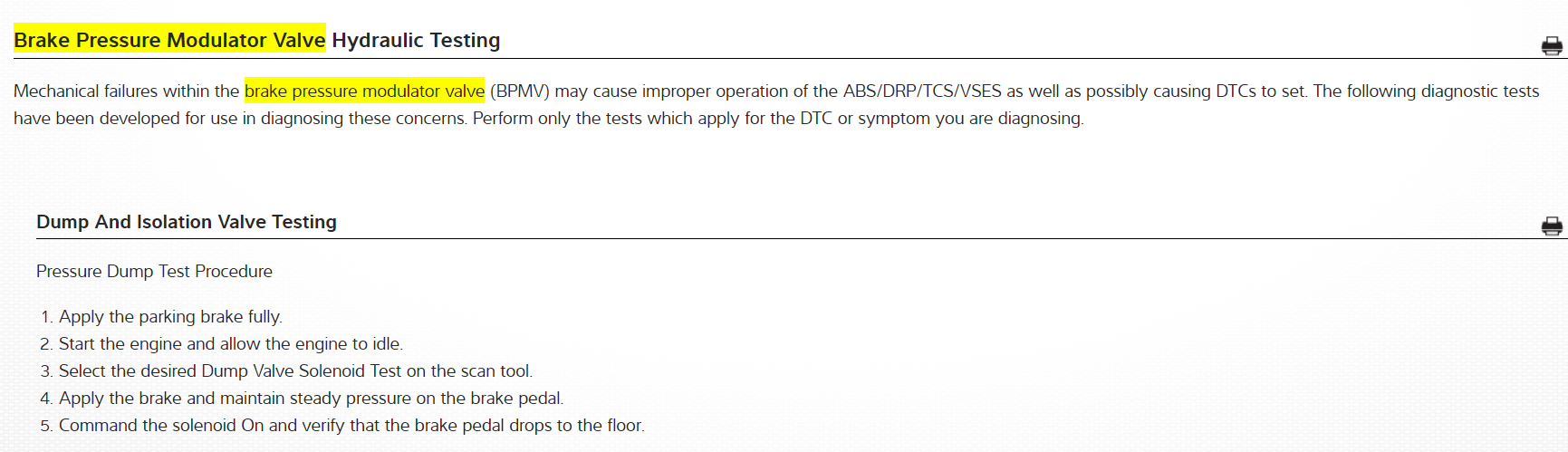

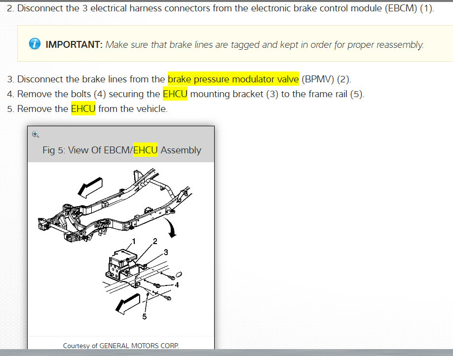

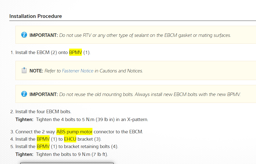

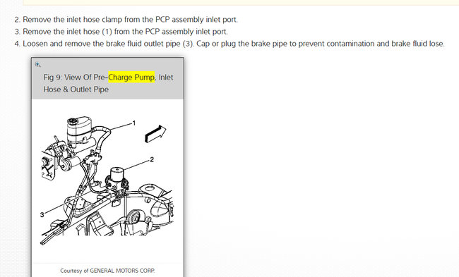

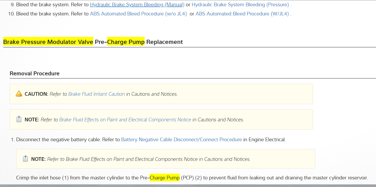

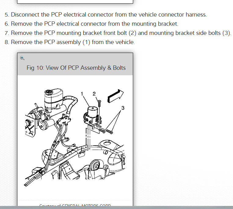

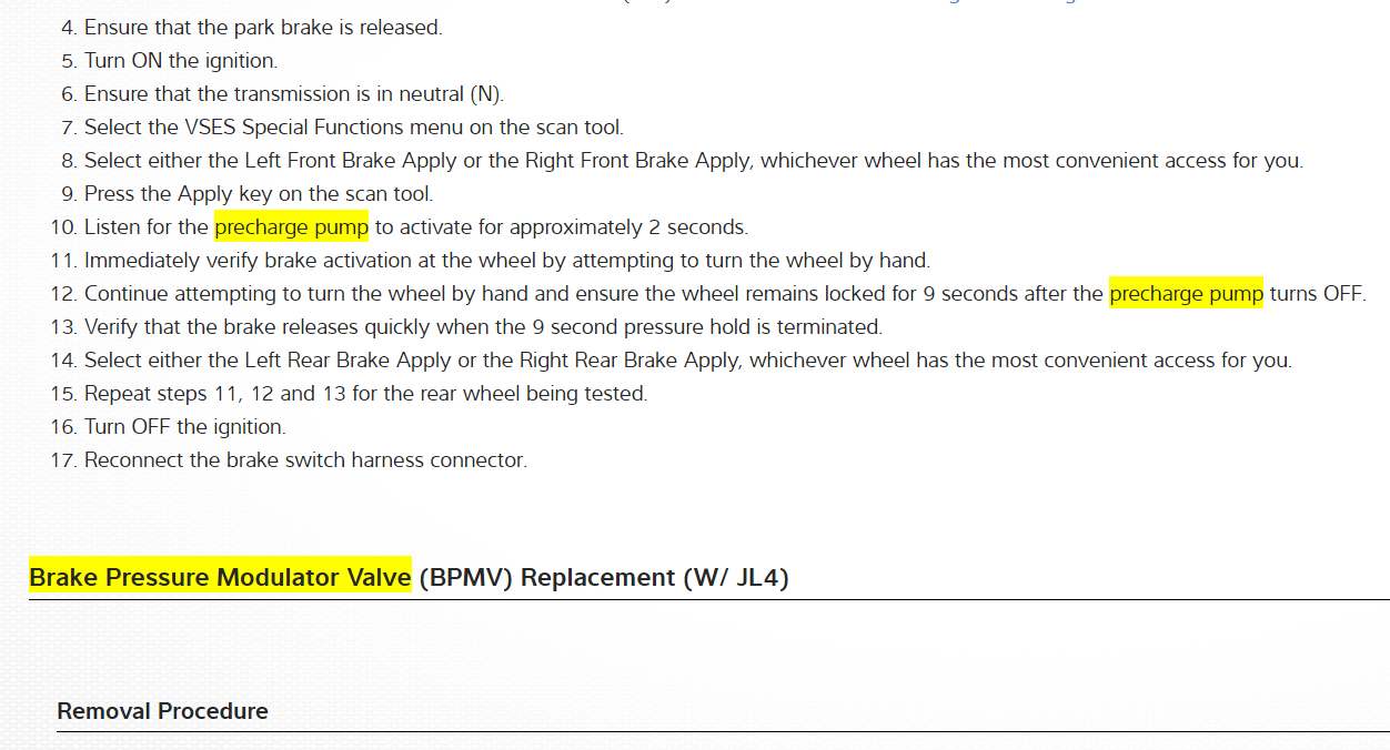

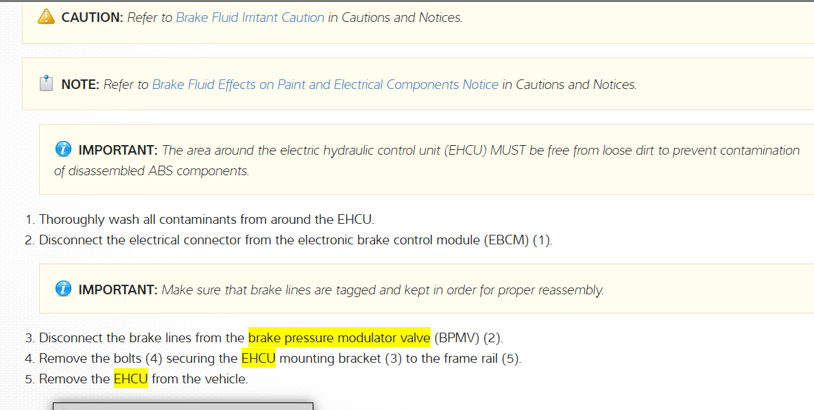

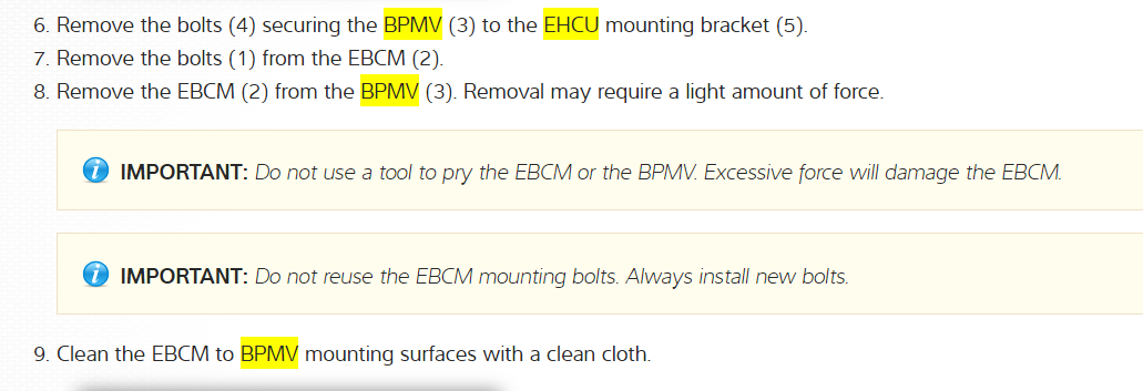

Fluid is leaking from ABS computer module under drivers side. Will changing the module fix leak? I watched YouTube video on how to change it. But it only shows top of module being replaced. Can entire fixture be replaced or do i need to keep looking for leak from elsewhere else?
Feb 27, 2019 at 8:49 AM
SCGRANTURISMO
  • 4,897 POSTS

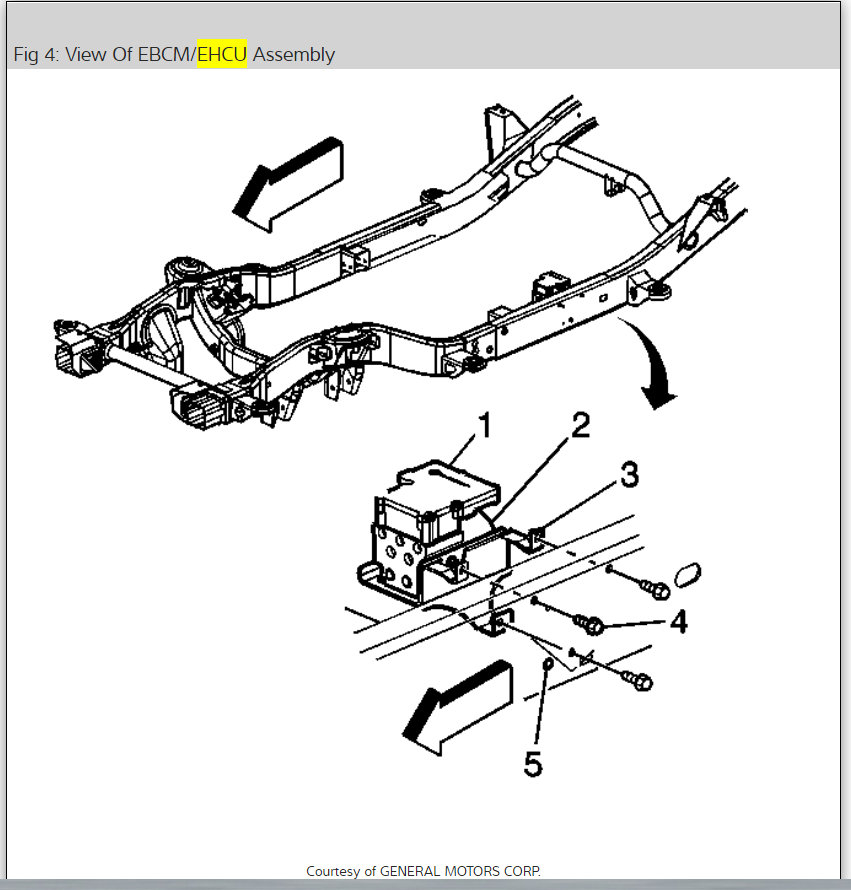

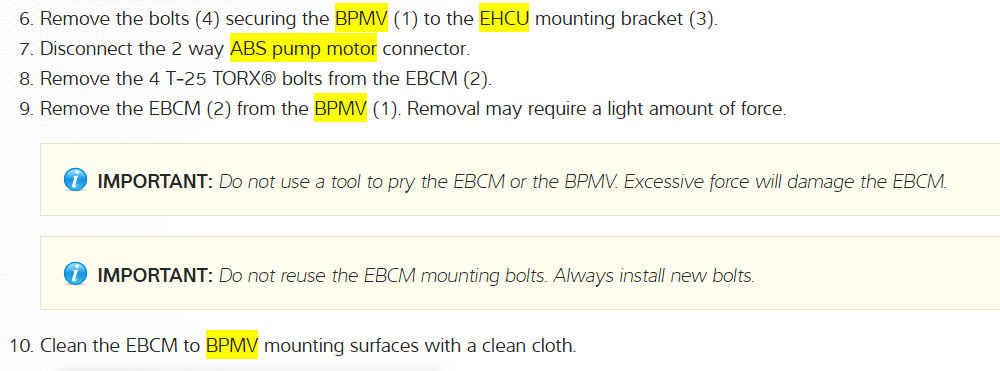

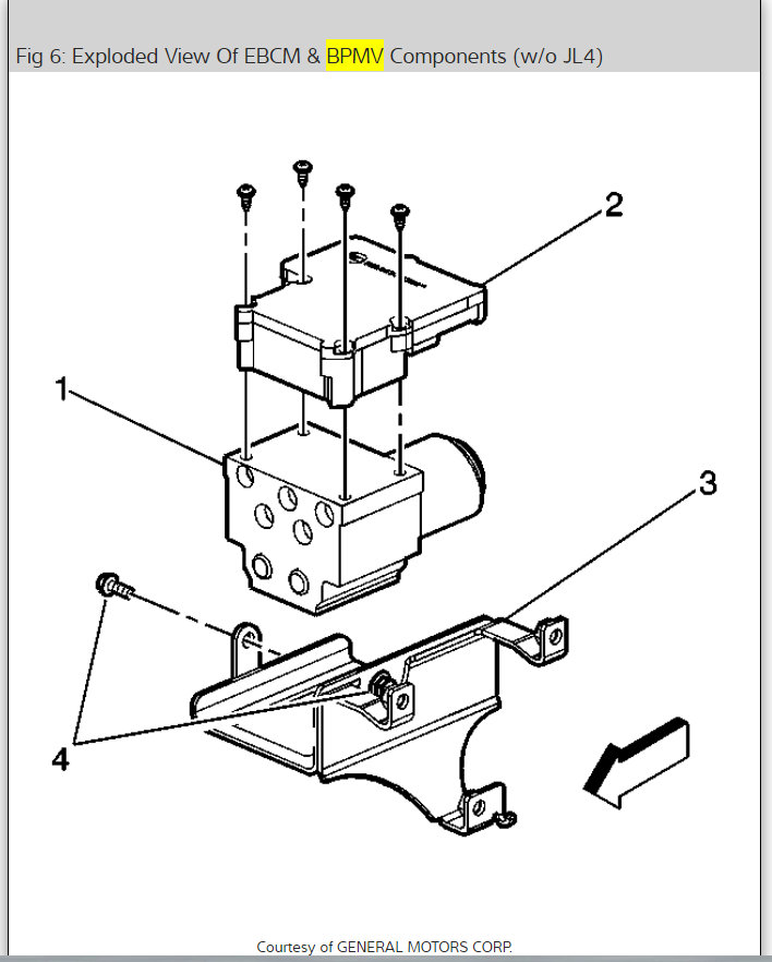

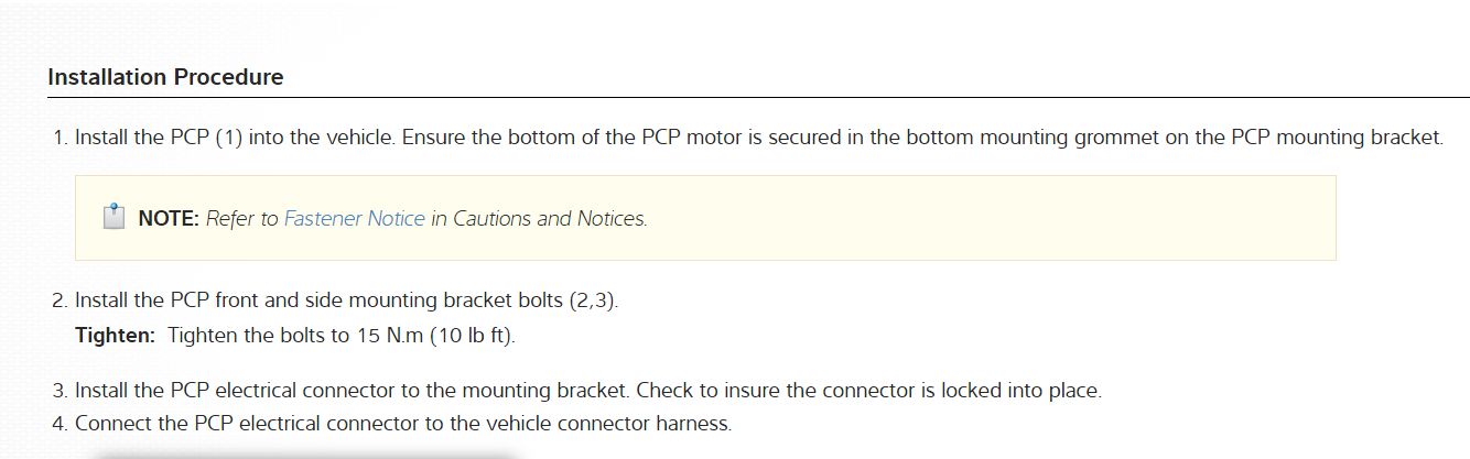

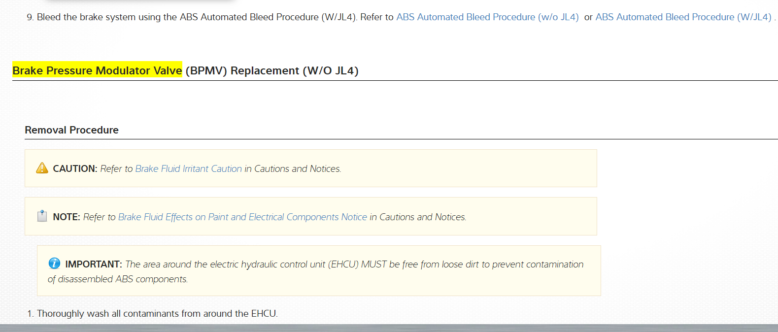

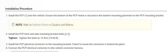

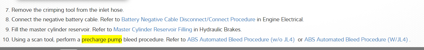

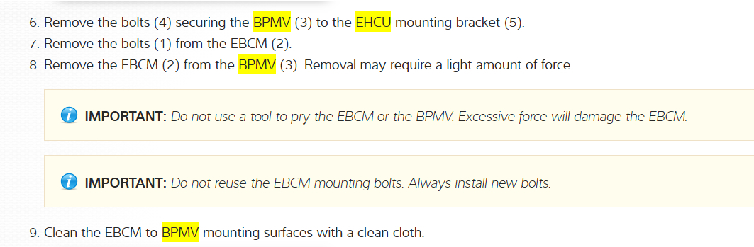

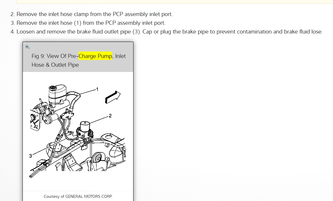

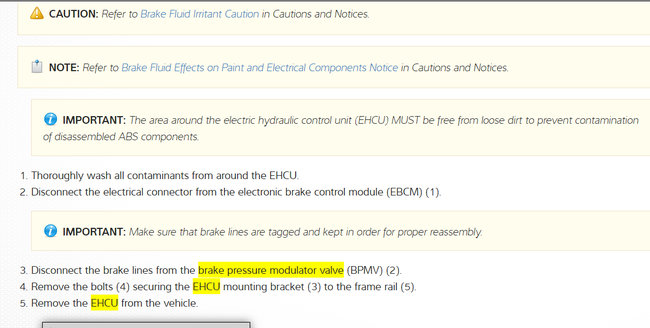

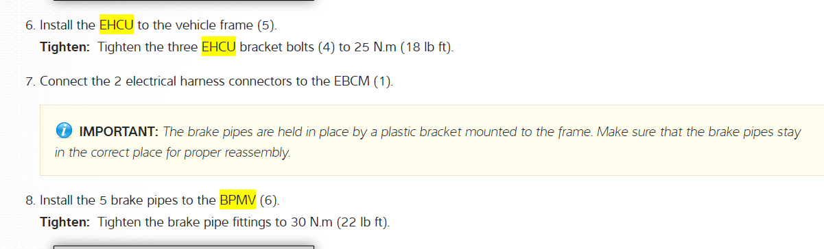

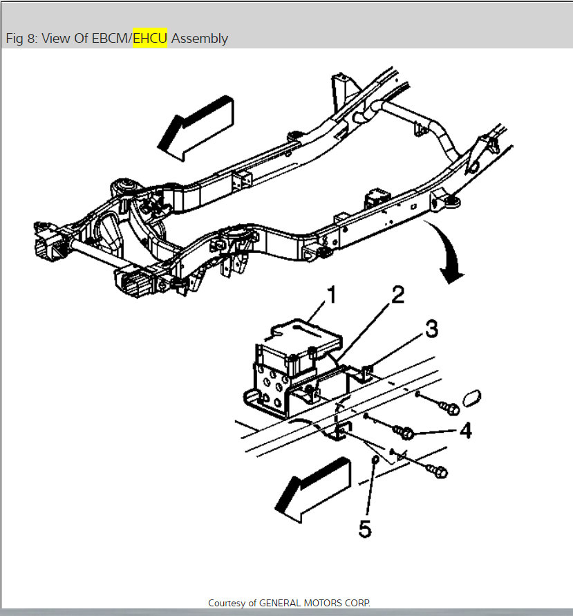

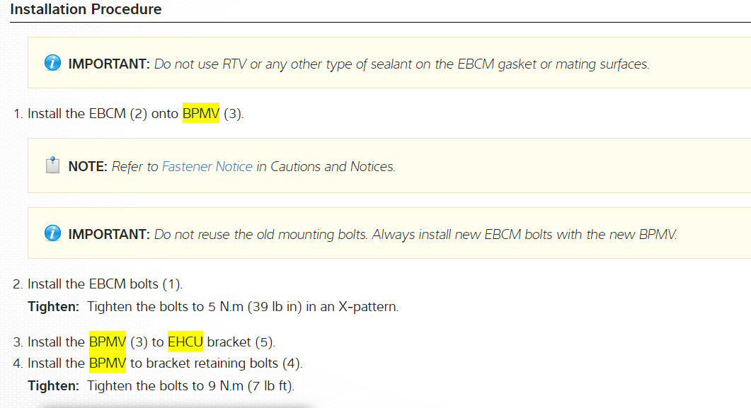

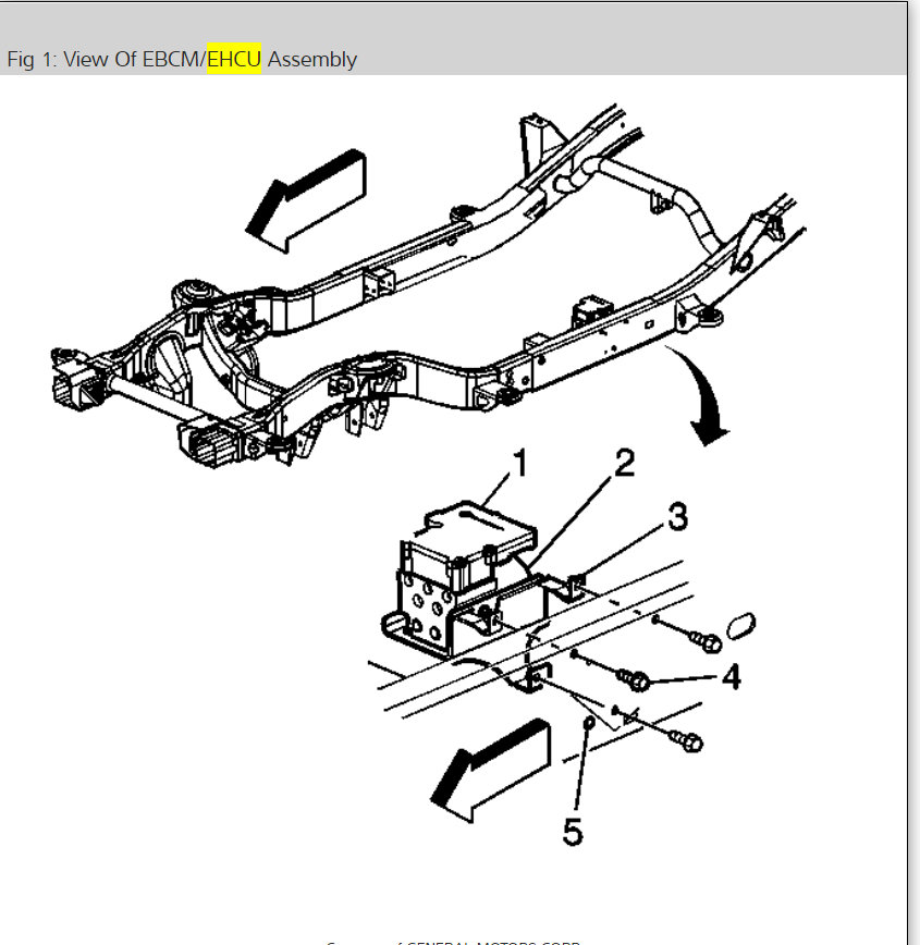

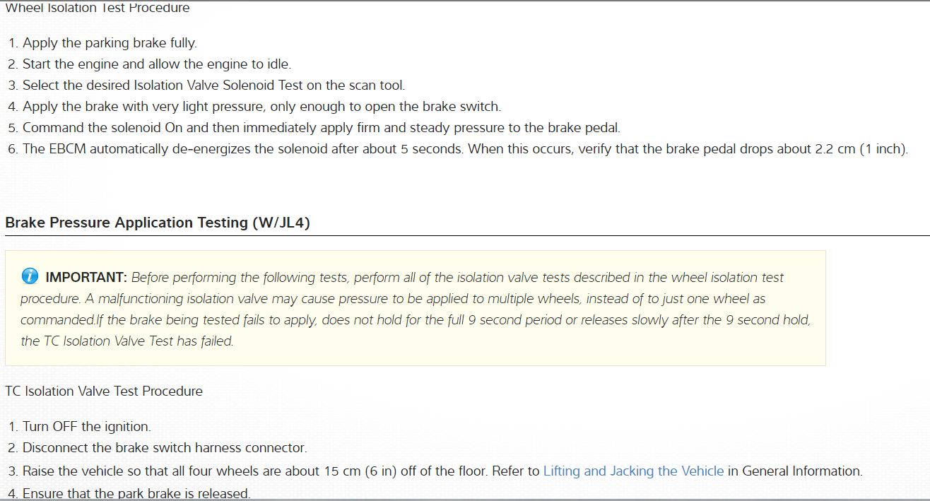

I have included the information that you requested in the diagrams down below. Please go through them and get back to us if you have any more questions or are unclear on something. Also let us know how it goes.
Thanks,
Al,ex
