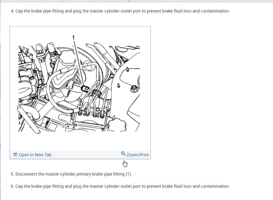

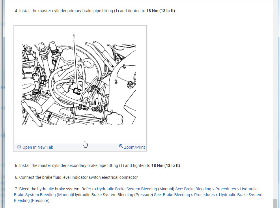

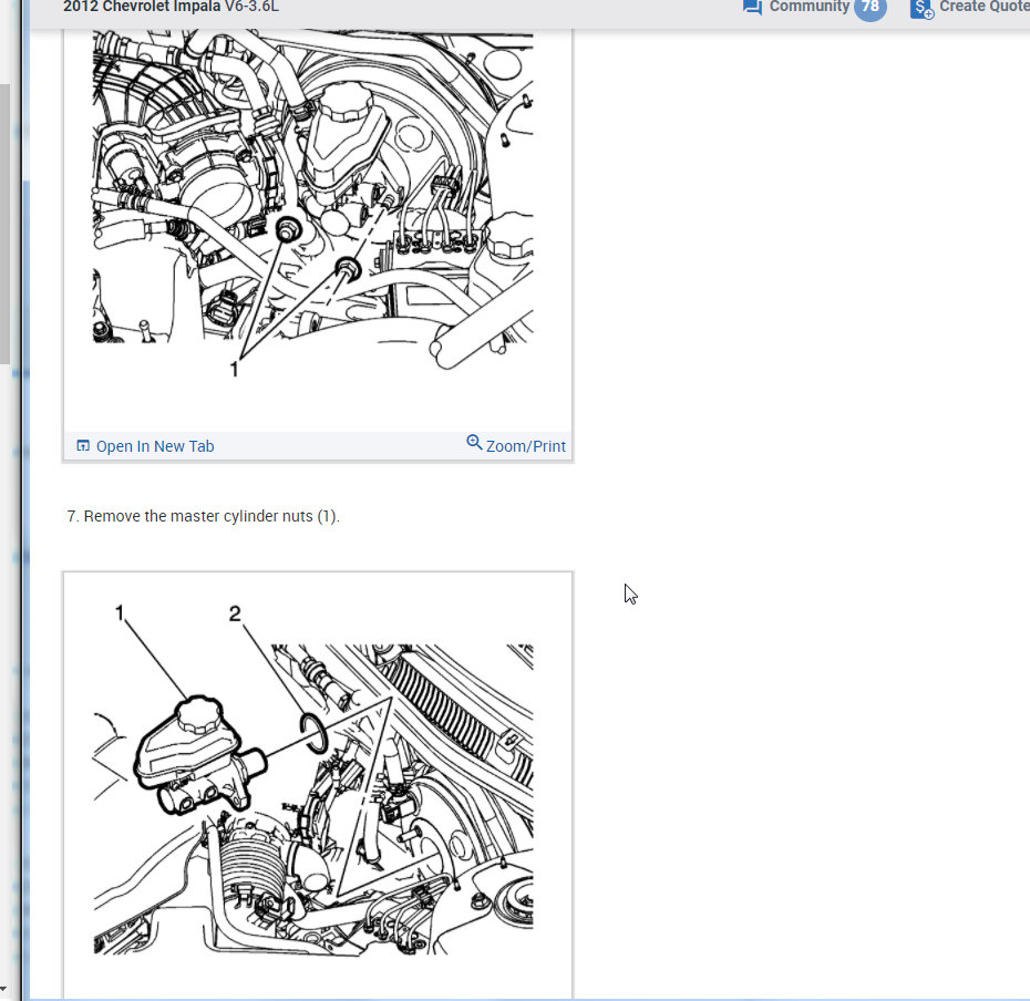

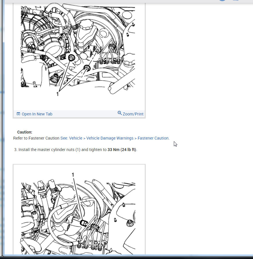

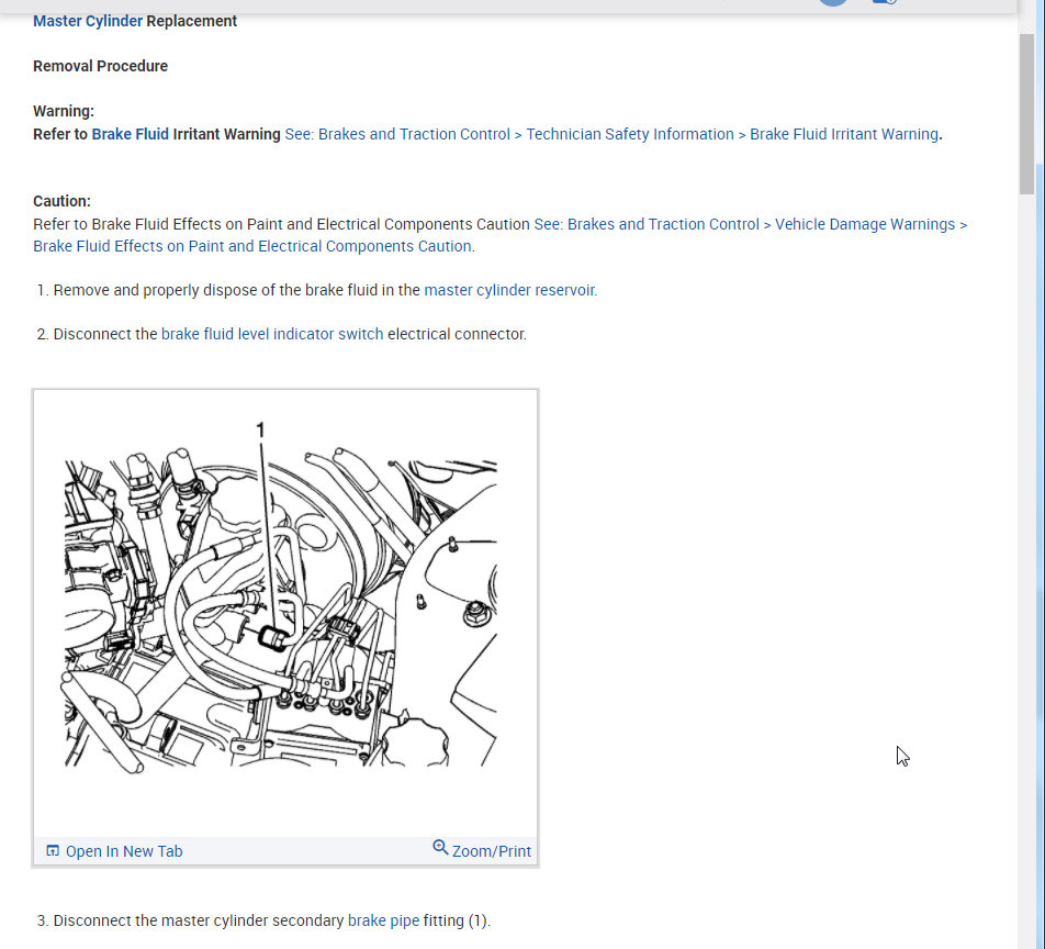

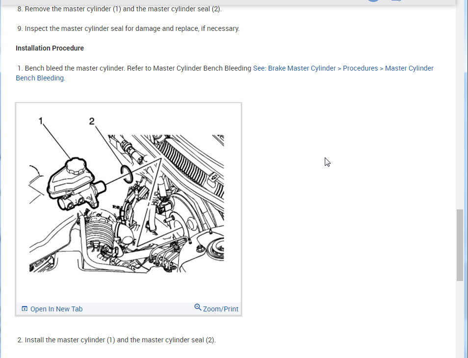

Unfortunately it sounds like it needs to be replaced. Here is a guide that will help with this:
https://www.2carpros.com/articles/how-to-replace-a-brake-master-cylinder
Plus a guide that helps with bleeding the brakes as this will need to be done as well.
https://www.2carpros.com/articles/how-to-bleed-or-flush-a-car-brake-system
Below is the process from the manual on how to replace this. Let us know if you have other questions, Thanks
