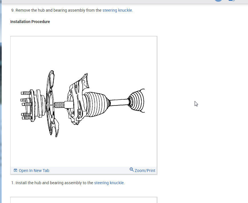

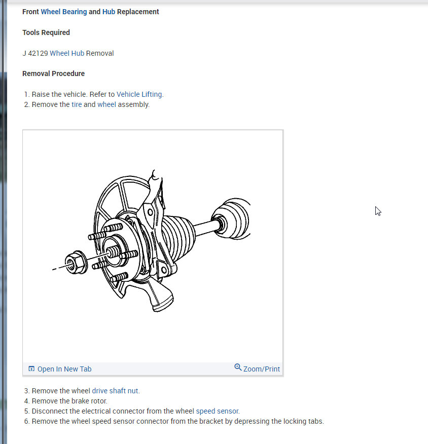

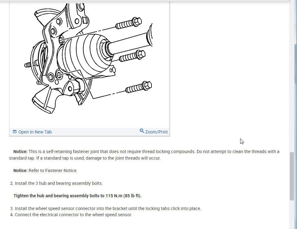

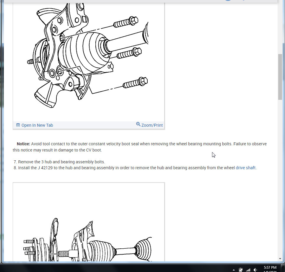

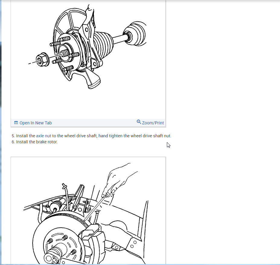

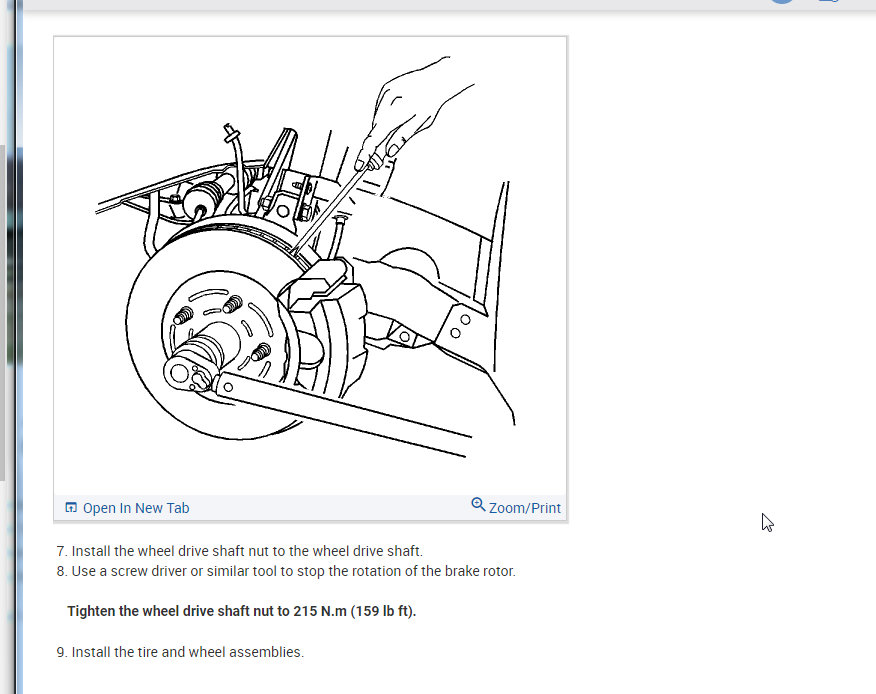

Here are a few guides that will help with this:
https://www.2carpros.com/articles/abs-wheel-speed-sensor-test
https://www.2carpros.com/articles/how-to-replace-an-abs-wheel-speed-sensor
Below you will find the process from the manual that will help with this as well. Please let us know what questions you have. Thanks
