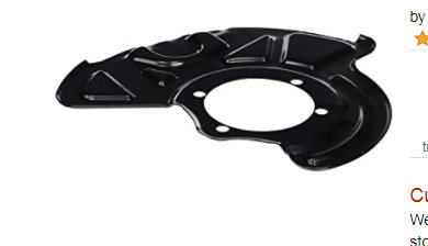

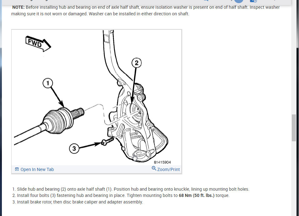

I noticed my car didn’t have a driver's side brake dust shield so I ordered one online, but it didn’t come with any bolts. don’t i need bolts for this and if so do you know what size and where I can find them?
May 17, 2021 at 9:21 AM

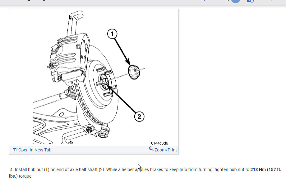

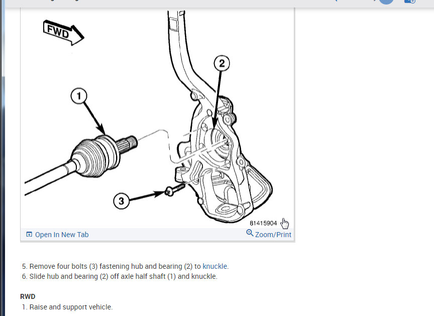

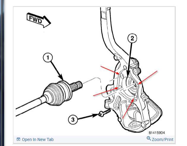

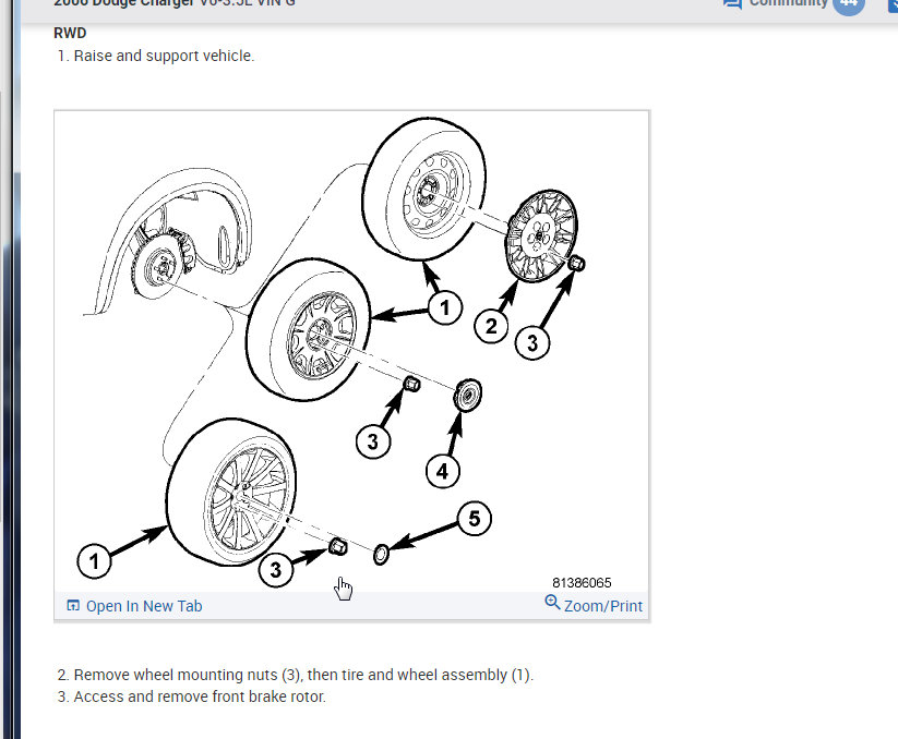

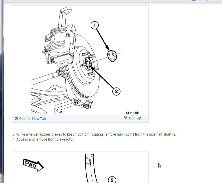

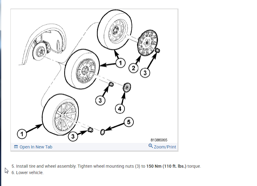

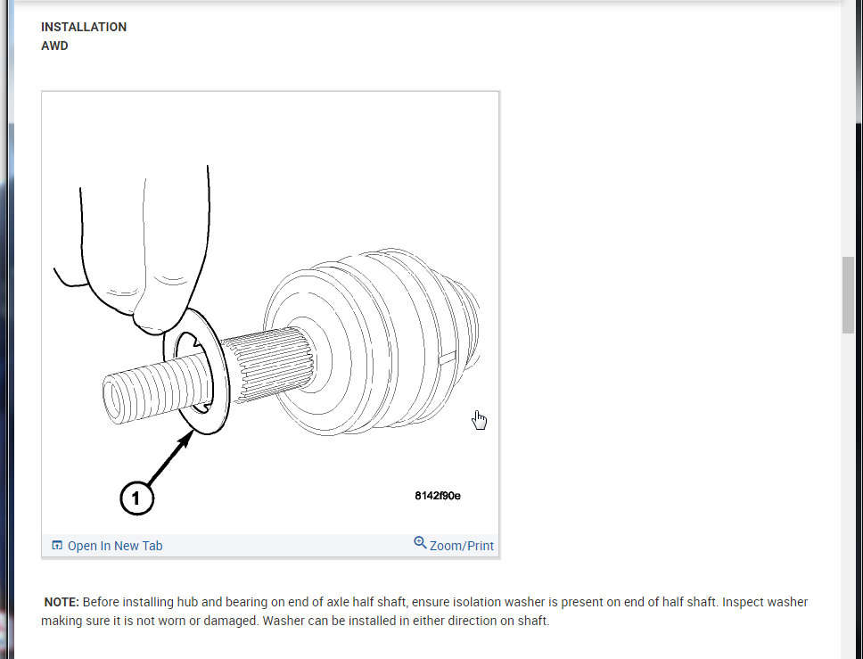

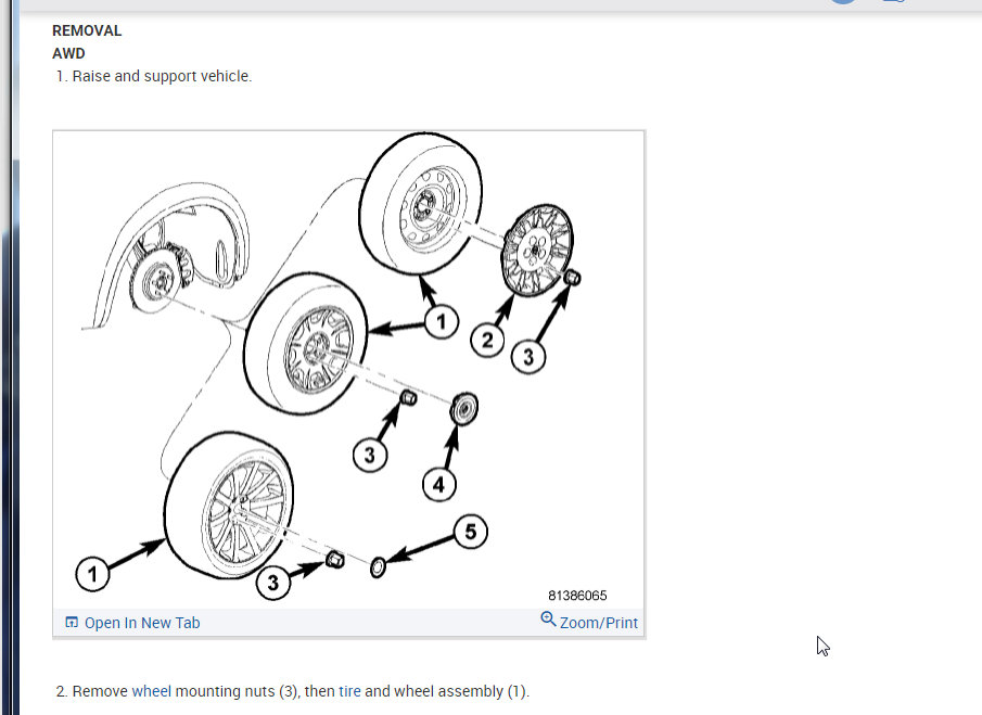

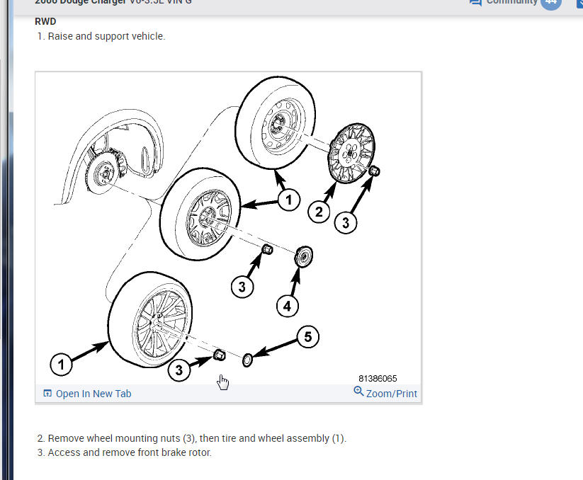

No there are no bolts that come with it. The 4 holes that are in the backing plate are where the bolts that hold the hub in place go through.
So you need to remove these 4 bolts and put the backing plate in and then put the bolts back in.

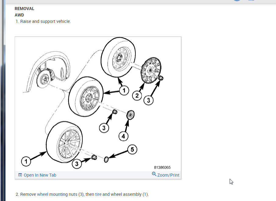

I included the process below for the hubs you will see in the pictures the 4 holes in the plate and the 4 that I point to with red arrows.
Please let us know if you have other questions. Thanks
