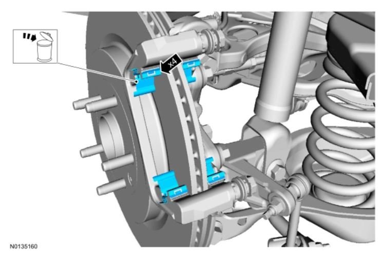

Bought the vehicle listed above from the dealer. Drove it 400 miles and the back wheels are black with brake dust and the front wheels are shiny clean. The parking brake is not dragging. I showed the dealer and was told it was normal, I do not believe them.
Feb 6, 2021 at 8:58 PM
Good morning,
That is most likely from the brand of brake pads that were installed on the rear brakes.
If they were non metallic or much cheaper brand than required, they will produce all that dust.
I would replace the pads with a good quality brand.

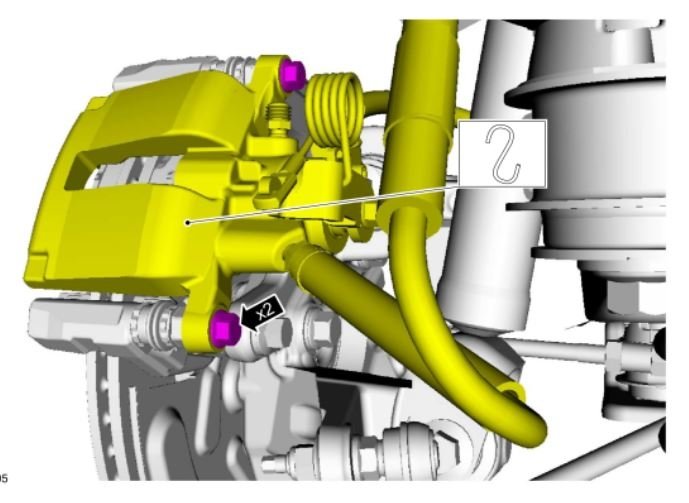

NOTICE: Care must be taken when servicing rear brake components without disconnecting the parking brake cable from the brake caliper lever. Carefully position the caliper aside using a suitable support or damage to the parking brake cable end fittings may occur.
NOTICE: Do not allow the caliper to hang from the brake hose or damage to the hose may occur.
NOTE: Use hand force and a rocking motion to separate the brake caliper from the brake pads.
Remove the bolts and position the brake caliper aside.

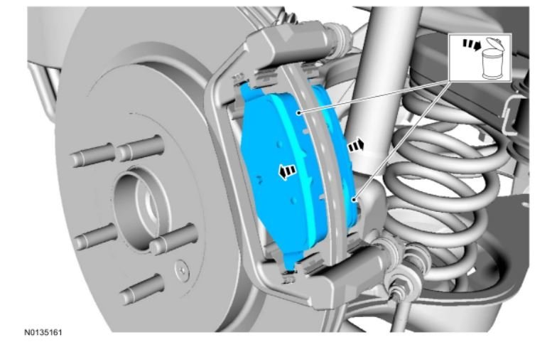

NOTICE: Brake pads with adhesive on the insulator are one-time use only. When the brake pads are separated from the brake caliper, new brake pads must be installed to prevent brake noise and shudder.
NOTE: For 13.5 in (345 mm) brakes, note the orientation of the inner and outer brake pads for reference during installation. Outer brake pads will have OTR stamped on the top of the backing. Inner brake pads (Police vehicles only) will have INR stamped on the top of the backing.
Remove and discard the brake pads.
Remove and discard the brake pad clips.
