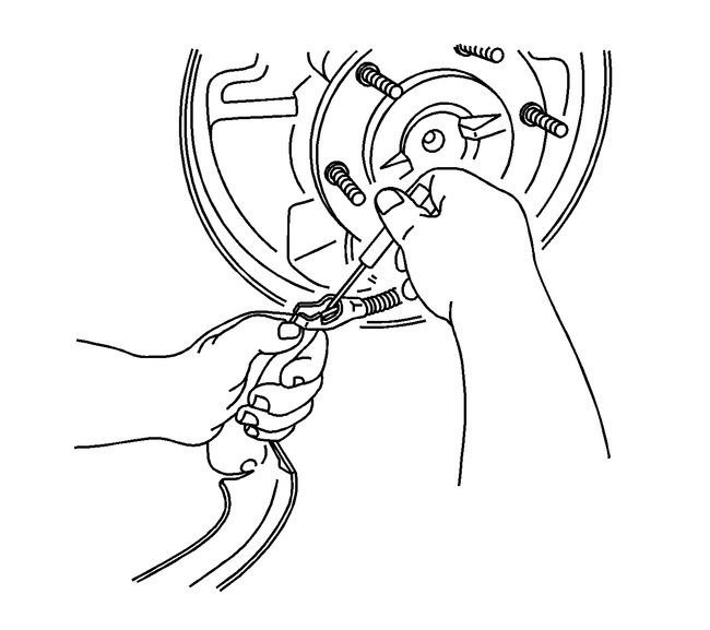

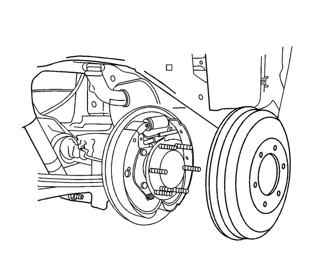

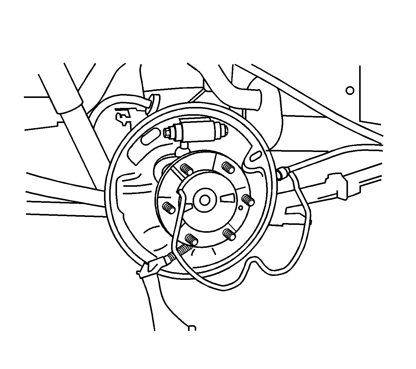

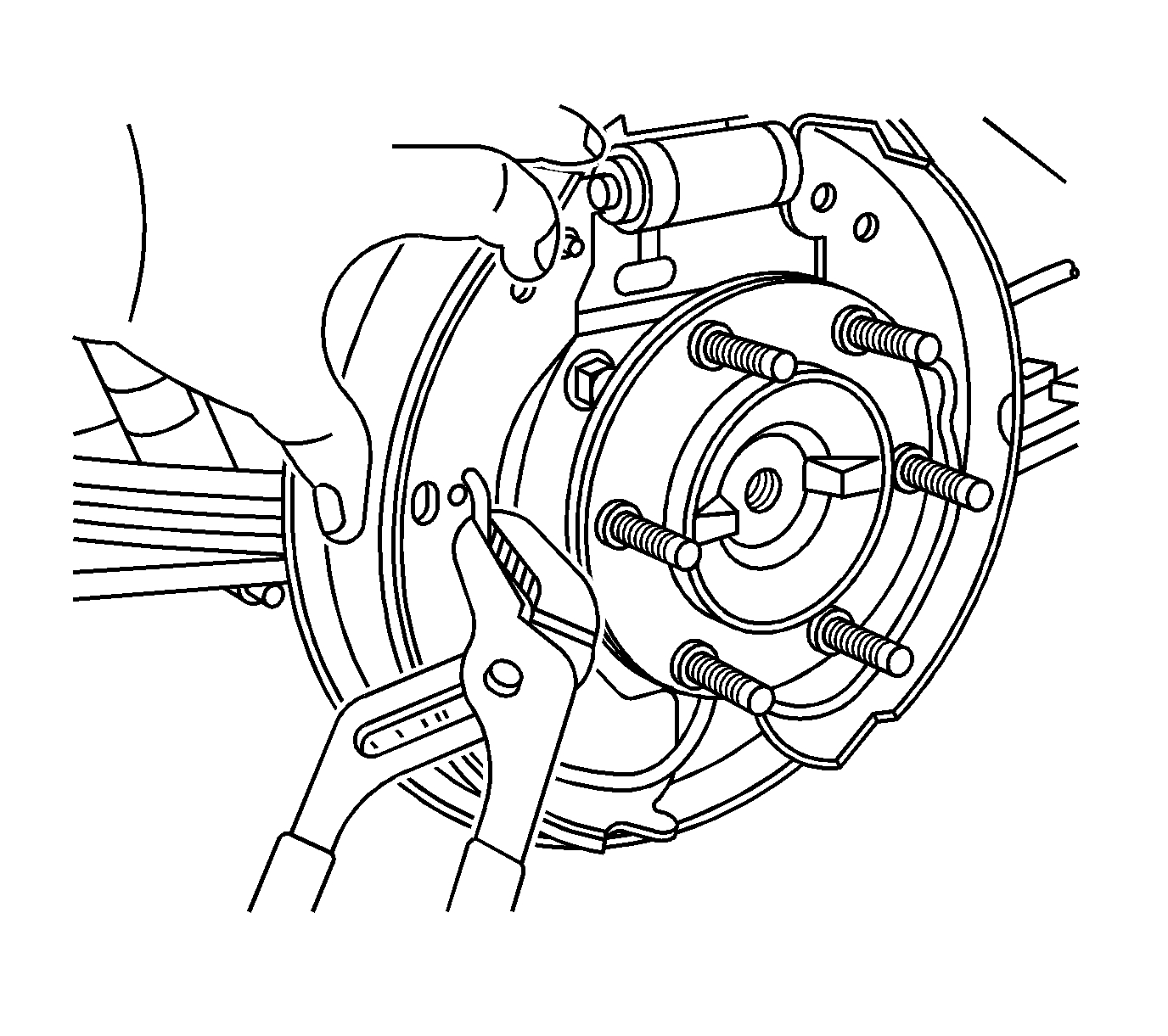

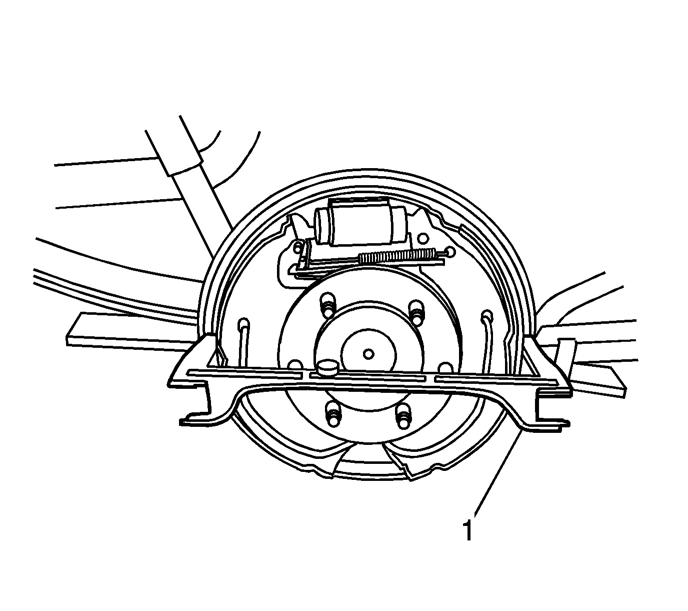

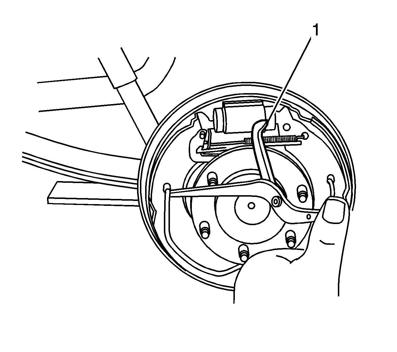

Looking for some help. I took the old brake drum completely part down to the back plate and wheel cylinder, and then reinstall all new shoes and hardware. I managed to get the e brake on and the hardware. But once I went to put the drum back on it wouldn't go over the shoes? Any idea? Also how would I know if my wheel cylinder is bad? Thanks in advance. I love mechanics but I'm new to it don't really have any mentors.

As far as a wheel cylinder, they will leak when bad. Now the brake drum. Did you fully turn down the self adjuster? Also, are the new brake shoes centered?
Here is a link that explains how in general drum brakes are repaired:
https://www.2carpros.com/articles/how-to-replace-rear-brake-shoes-and-drums
_____________________________________
Here are the directions for removal and replacement. Take a look through them to see if you missed anything. Most often, the adjuster isn't turned in the entire way or the parking brake cable may note be fully seated. All attached pictures correlate with the directions.

pic 1
1. Raise the vehicle. Refer to Vehicle Lifting.
2. Remove the rear brake drum assembly.

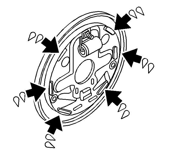

3. Using denatured alcohol, clean the rear brake shoes.

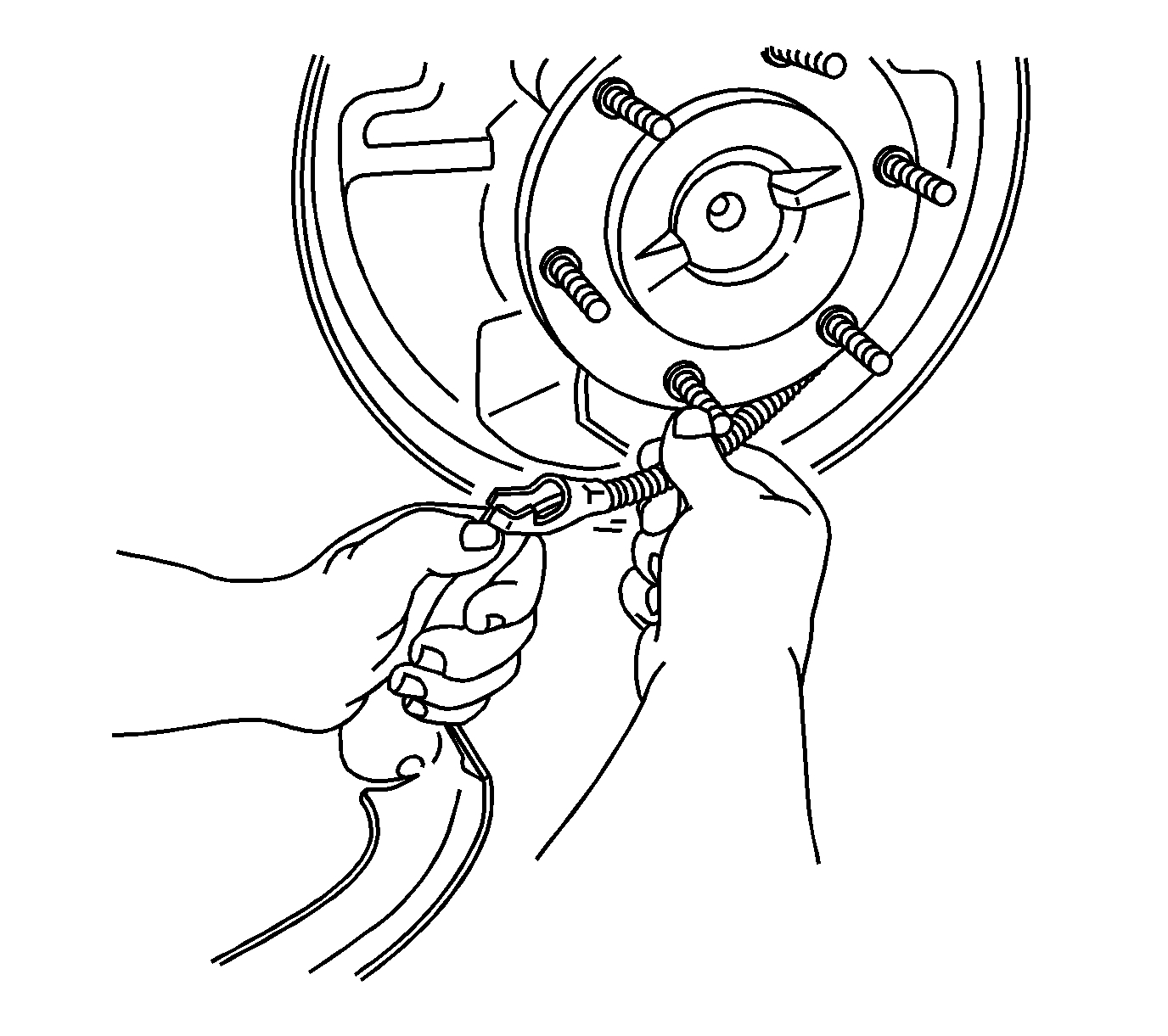

pic 2
Important: Before removing the brake return spring, adjust the brake shoes to the lowest position. This will reduce the tension on the retractor spring.

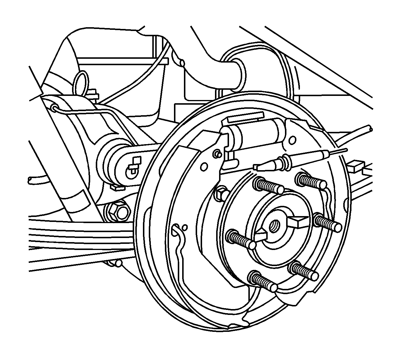

4. Remove the adjuster assembly.

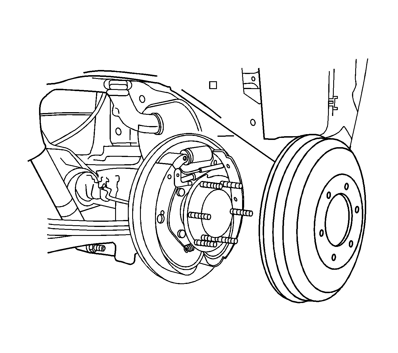

pic 3

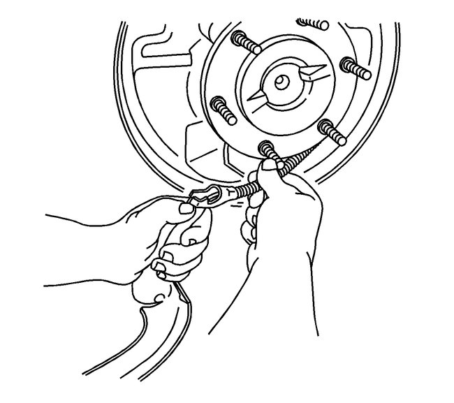

5. Using a pair of channel locks, remove the retractor spring from the secondary brake shoe.

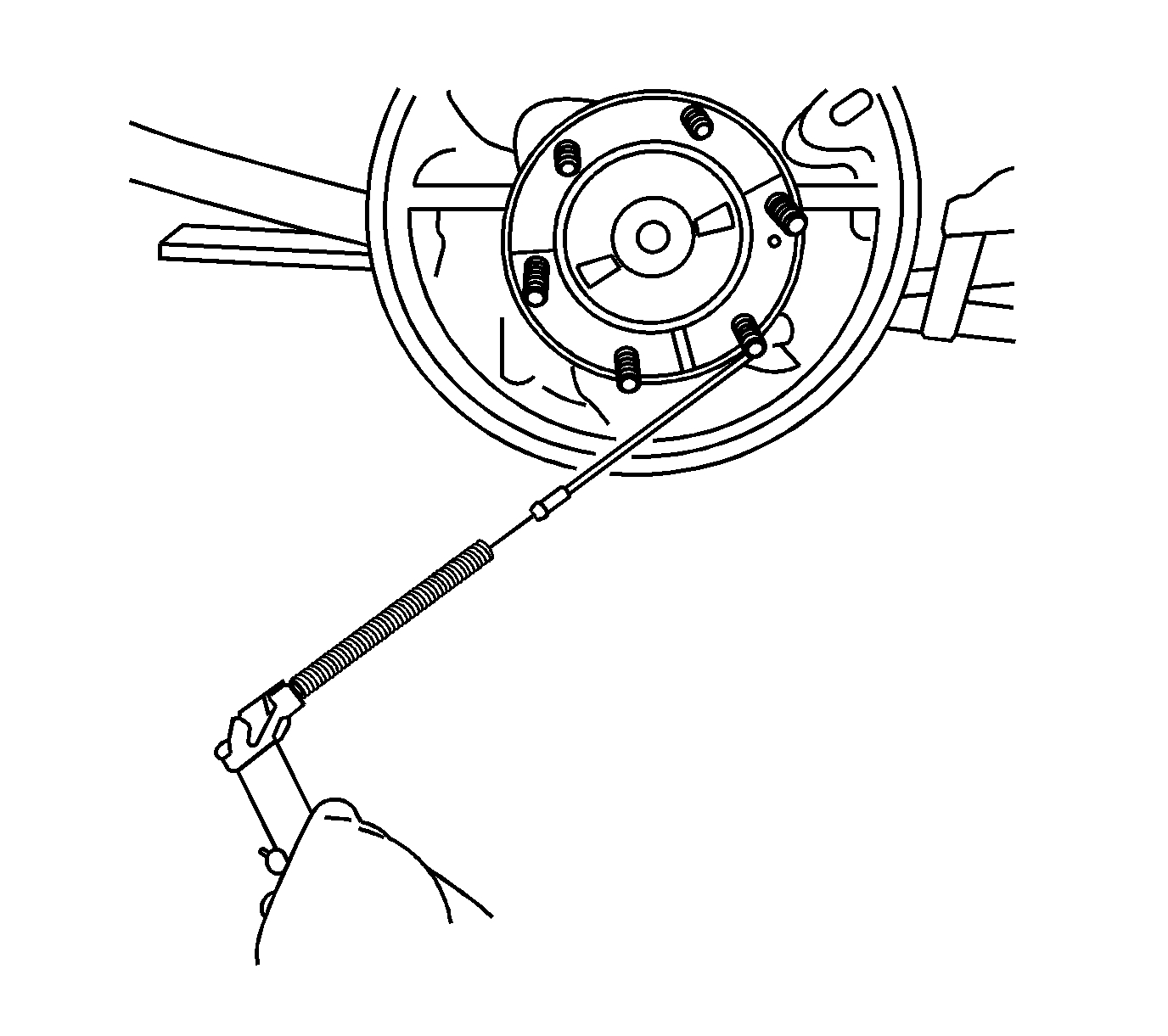

pic 4
6. Remove the secondary brake shoe from the backing plate.

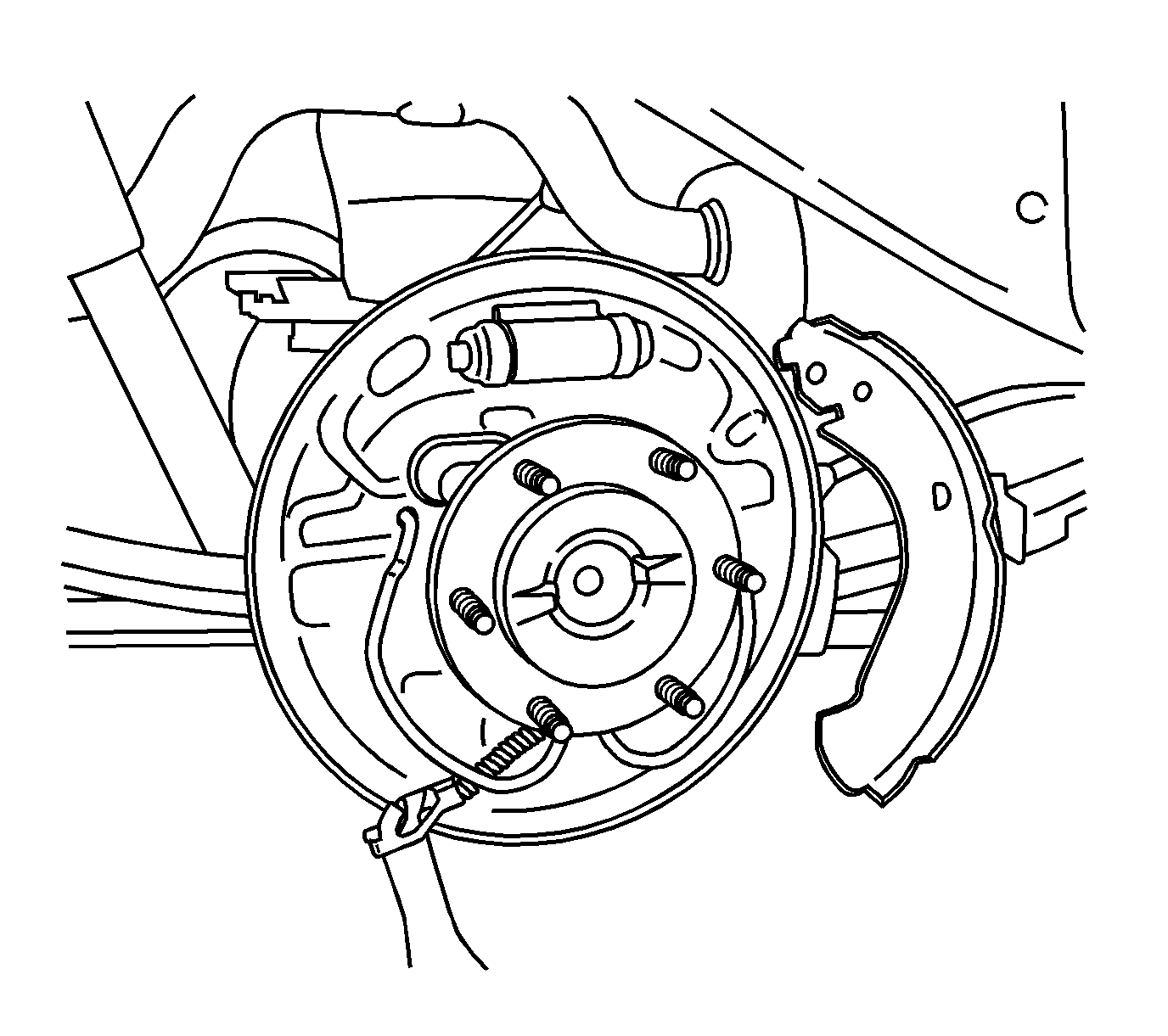

pic 5

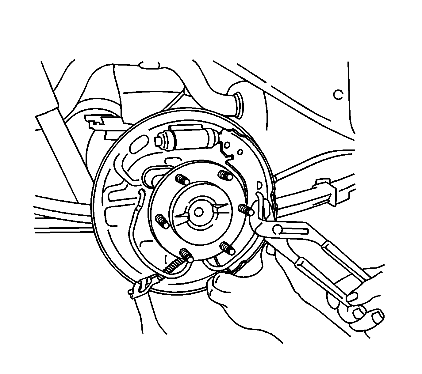

7. Using a pair of channel locks, remove the retractor spring from the primary brake shoe.

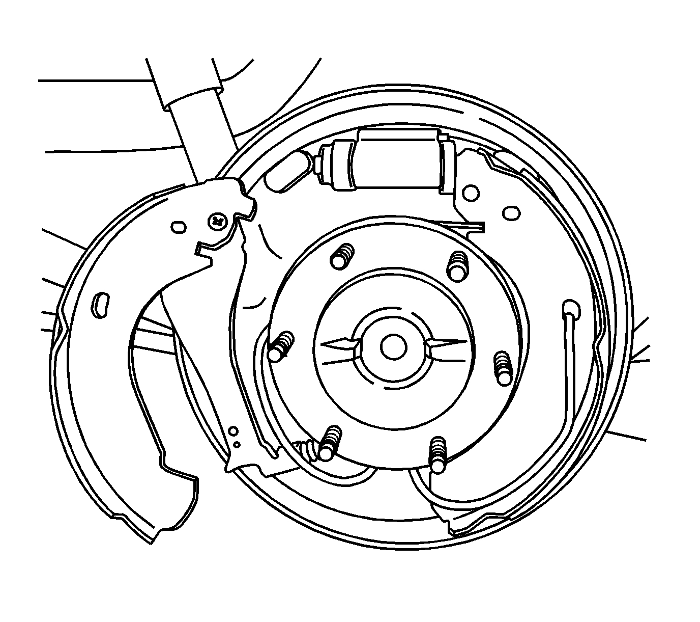

pic 6
8. Remove the primary brake shoe from the backing plate.
pic 7
9. Remove the return spring.

9. Install the rear brake drum.
10. Lower the vehicle.

Let me know if this helps. Also, you asked about a bad wheel cylinder. I said they will leak when bad. They can also freeze up and not move. In that case, there will most likely be rust on the inside of the brake drum where the shoes would normally touch.
Feel free to ask questions if you have any.
