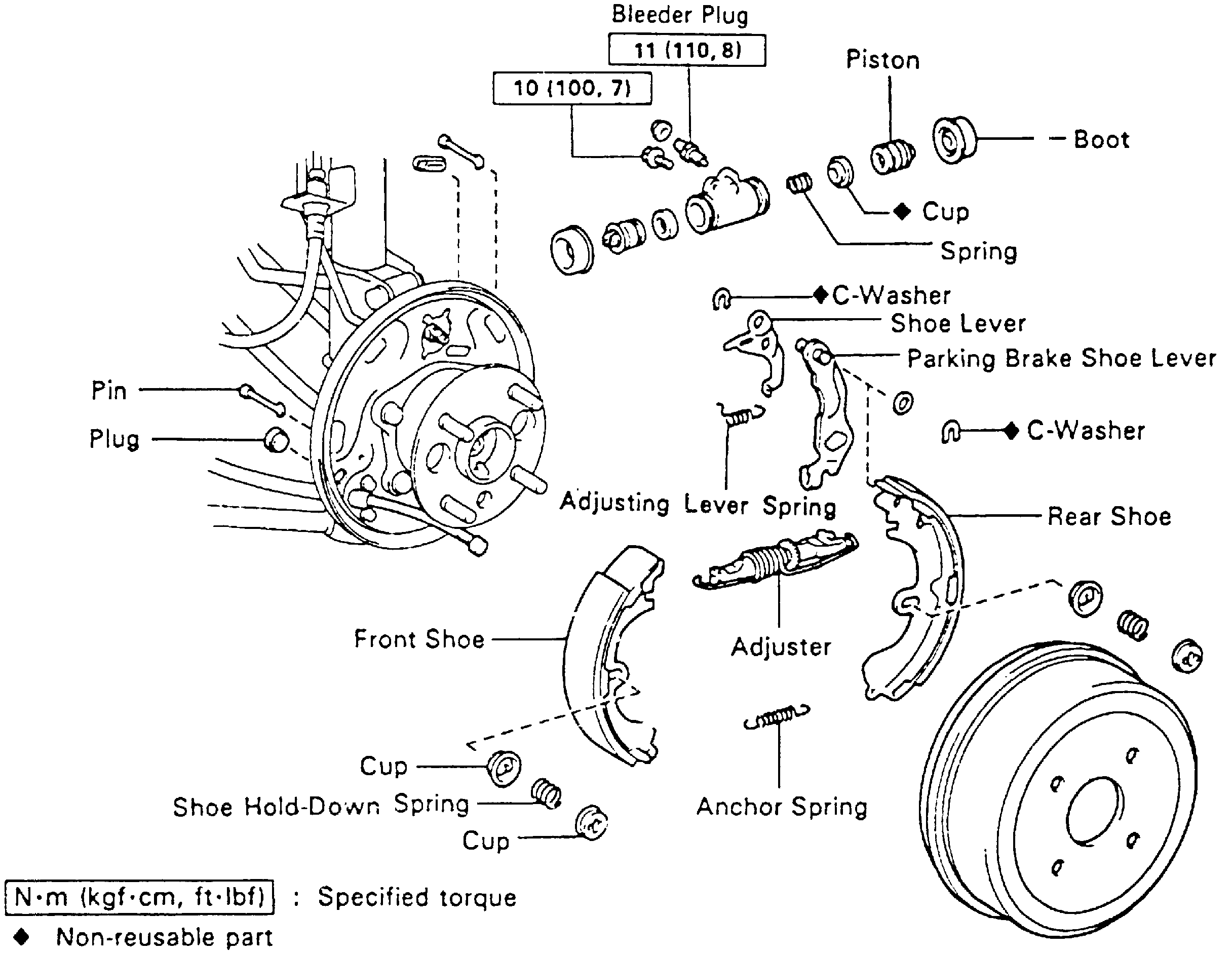

Here are the directions specific to your vehicle. The attached pictures correlate with these directions.
_______________________________________---
Removal
1. Raise and support rear of vehicle, then remove wheel and tire assembly.
2. Remove brake drum. If brake drum cannot be remove easily, insert a suitable screwdriver through hole in backing plate, then push automatic adjuster lever away from adjuster and back of adjustment tension.
3. Disconnect return spring, using a suitable tool, then remove front shoe hold-down spring, retainers and pin.
4. Disconnect anchor spring, then remove front brake shoe and anchor spring, Fig. 10.
Fig. 10 Exploded View Of Type 6 Drum Brake Assembly.
picture 1
5. Remove rear shoe hold-down spring, retainers and pin, using suitable a tool, then disconnect parking brake cable from anchor plate.
6. Disconnect parking brake cable from lever, then remove rear shoe with strut.
7. Remove adjusting lever spring, strut and return spring from rear shoe.
8. Remove C-washer, then the shims, parking brake lever and automatic adjusting lever from rear shoe.
9. Position a suitable container to catch fluid, then disconnect brake line.
10. Remove two attaching bolts, then the wheel cylinder.
11. Remove two boots, two pistons, two piston cups and spring from wheel cylinder.

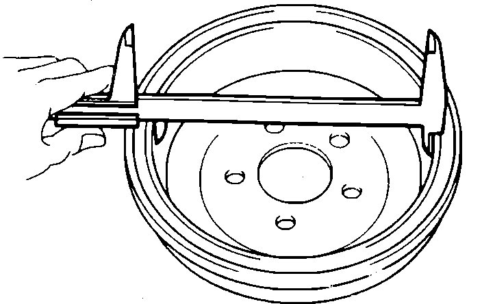

1. Measure brake drum inside diameter. Inside diameter should be 7.87 inches, Fig. 2.
Fig. 3 Measuring Brake Drum Inside Diameter

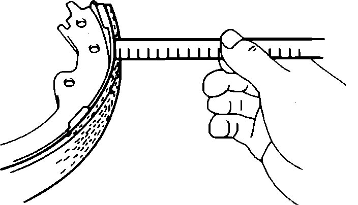

2. Measure brake shoe lining thickness, Fig. 3. Minimum thickness should be .04 inch.
Fig. 4 Measuring Brake Shoe Lining Thickness

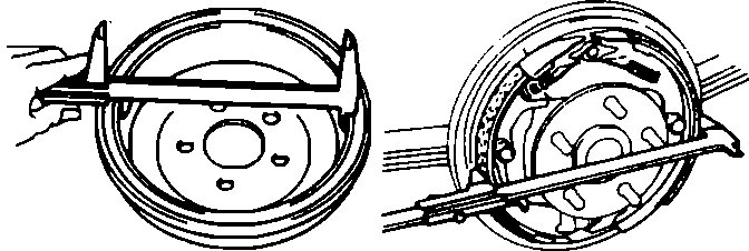

Fig. 5 Measuring Clearance Between Shoes & Drum
picture 5
16. Remove drum, then check for proper clearance, Fig. 4. Clearance should be .024 inch. If clearance is not as specified, check parking brake system.

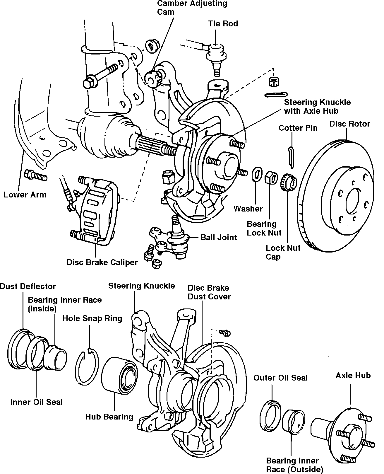

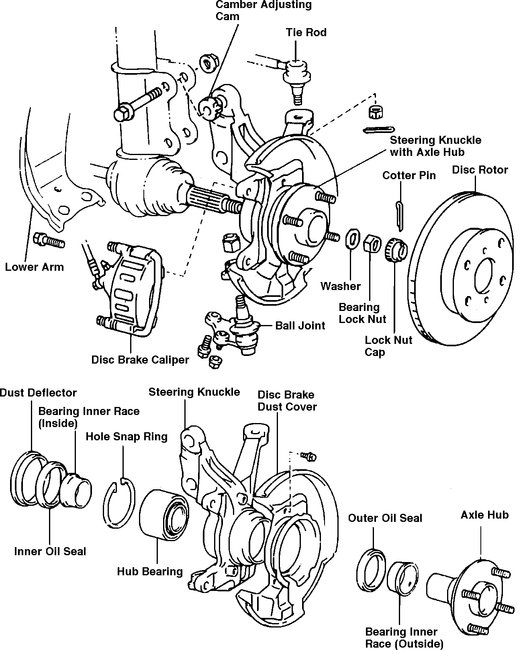

The last pic I attached shows the front brake and hub assembly. There is a bolt that holds the axle in the hub. Is that what you are referring to?
