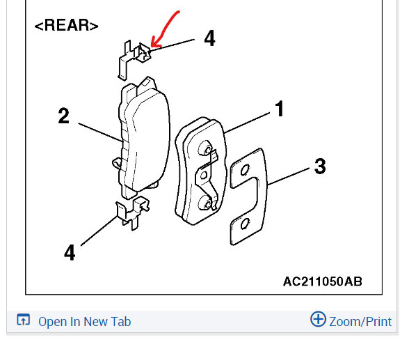

Brake disc repair, the rear left brake pad has slipped out and broke one of those clips?
190,000 MILES • 3.6L • V6 • 4WD • AUTOMATIC
BRJZLE89

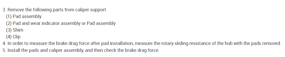

I just put Wagoner OEX brake pads on front and back on my vehicle listed above SE, AWD, but the other day my rear left brake pad has slipped out and broke one of those clips can I just buy a Duralast brake disc repair kit to fix it since I have aftermarket brakes or will it not work.
Feb 7, 2024 at 12:09 PM
  • 55,658 POSTS

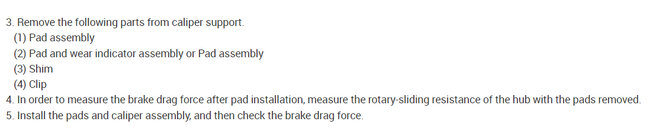

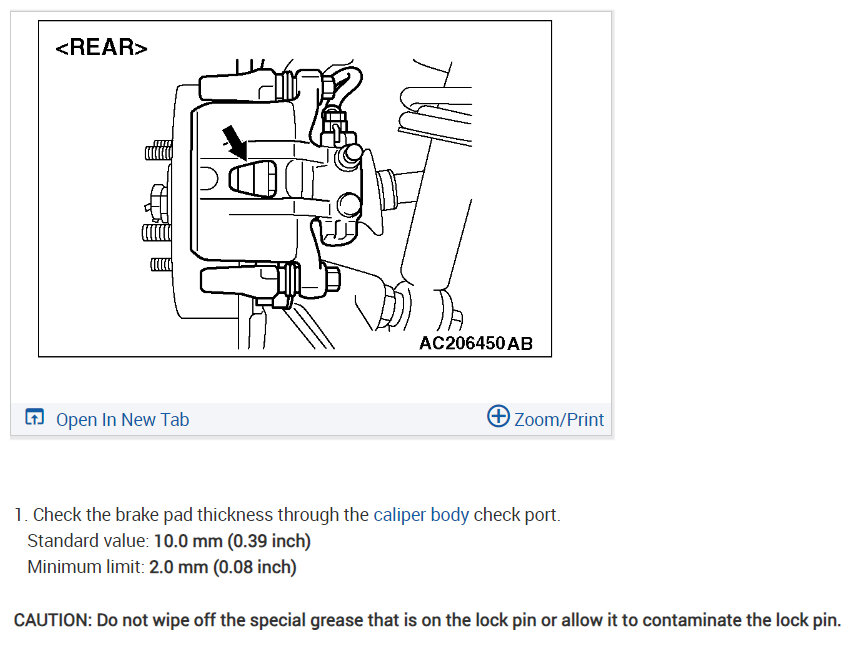

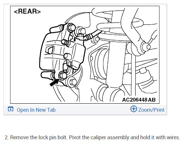

aftermarket brakes should not be a problem, but can you upload an image of the brakes so I can see? I uploaded some images and instructions on the rear brake pads and clips needed. Check out the images (below). Please let us know what happens.
