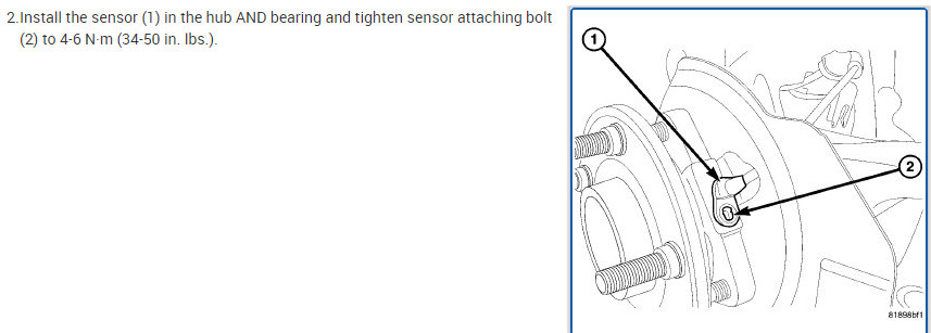

I need to replace the right front ABS wheel speed sensor
2010 JEEP WRANGLER
150,000 MILES • 4.3L • 6 CYL • 4WD • AUTOMATIC
CHUCK451
This is more of a question of how something may happened. My vehicle has an ABS light it says I need to replace the right front ABS wheel speed sensor
Oct 22, 2016 at 1:01 AM
DANNY L
  • 5,648 POSTS
Hello, I'm Danny.

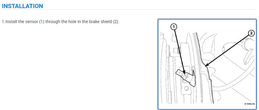

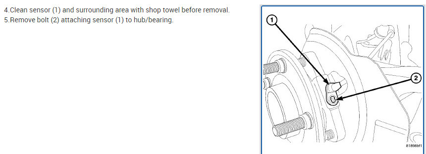

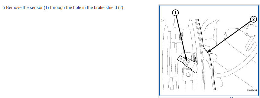

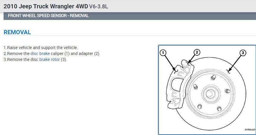

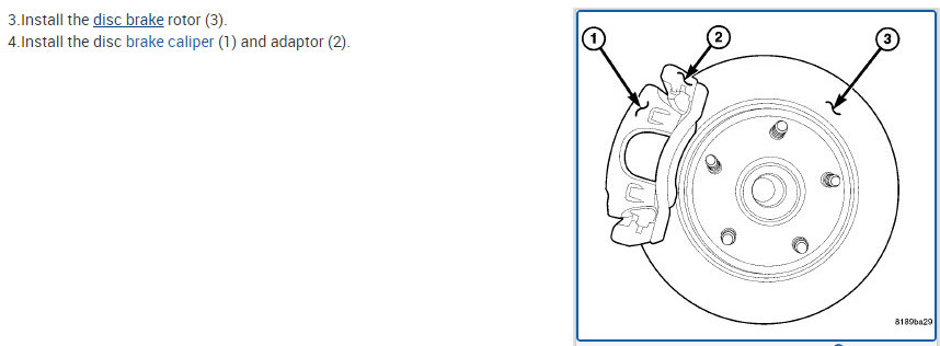

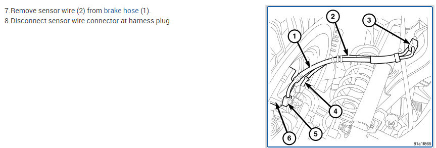

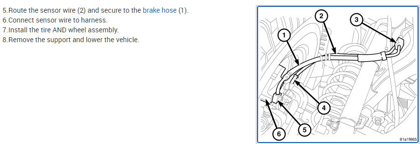

Here is the information you requested. This is a tutorial for you to view on how to replace a wheel speed sensor:
https://www.2carpros.com/articles/how-to-replace-an-abs-wheel-speed-sensor
I've attached picture steps below on how to replace the wheel speed sensor on your vehicle. Hope this helps and thanks for using 2CarPros.
