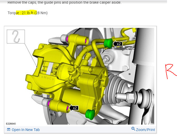

I was wondering if you’re able to provide torque specs for the front and rear brake caliper bolts and caliper bracket bolts.
The vehicle listed above is an SEL model, AWD.

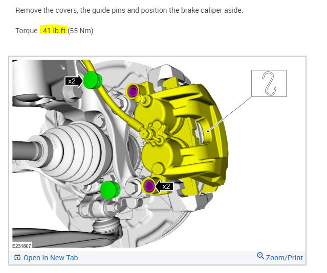

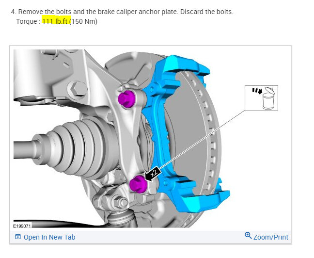

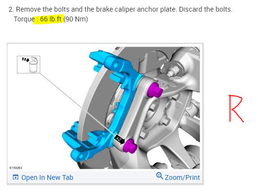

The only way I was able to find them was by going through the procedure.
I highlighted the torque specs for all that you mentioned. The last two pics, with an R on them, are for the rear.
