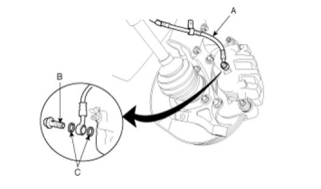

How do you get the brake line off the rear caliper?

The hose should have a "banjo bolt" that secures it to the caliper. Each side of the hose will have a copper crush washer that goes on the bolt. I'll post more info below.
The bolt is B and washers are C in the picture below. The bolt should be torqued to 20lb ft.

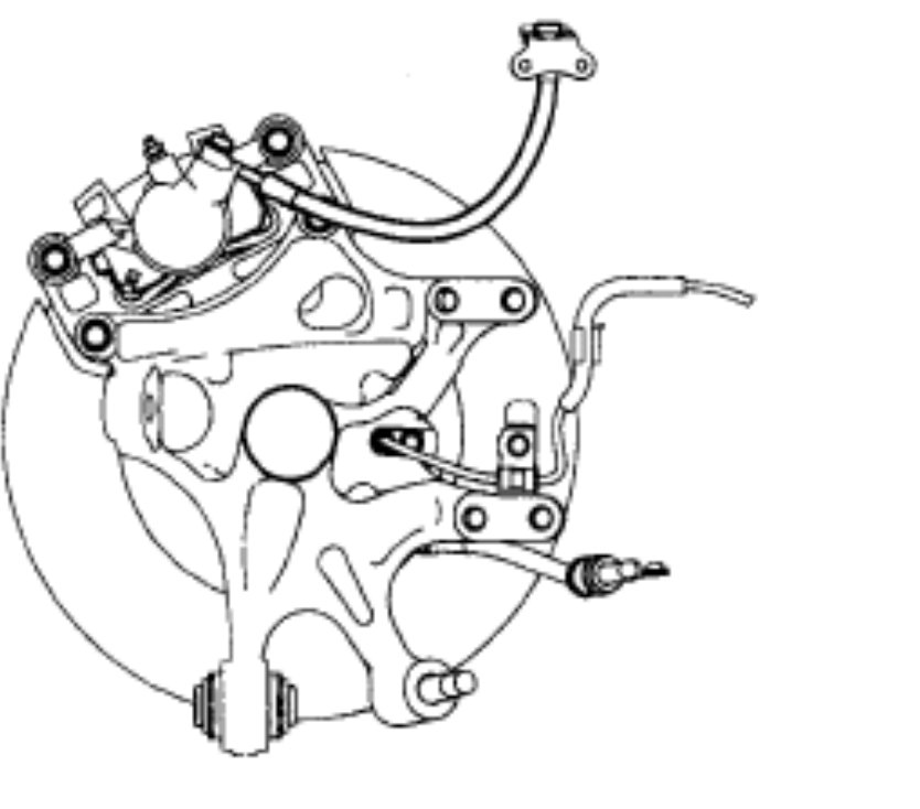

There will be a banjo bolt securing the rear brake hose to the rear caliper.
You will simply need to undo the banjo bolt and remove the hose.
A picture below shows the rear caliper and hose.

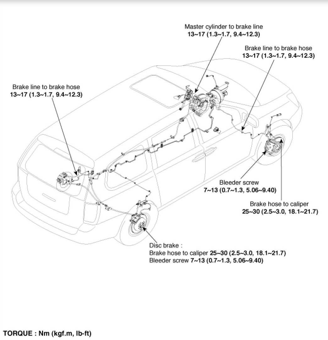

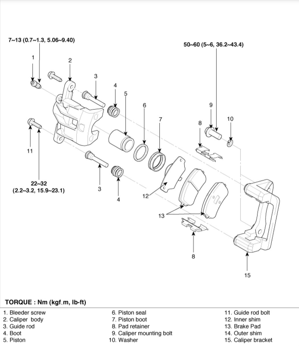

I have also attached diagrams with the tightening torques for the hose and caliper bolts.
