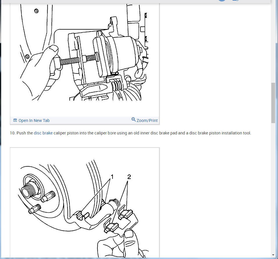

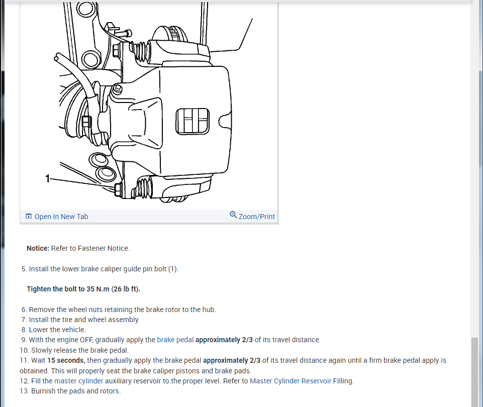

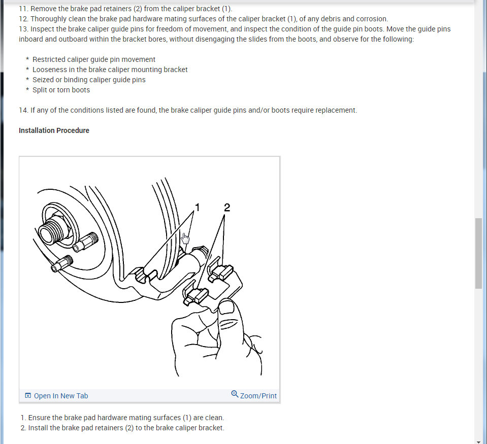

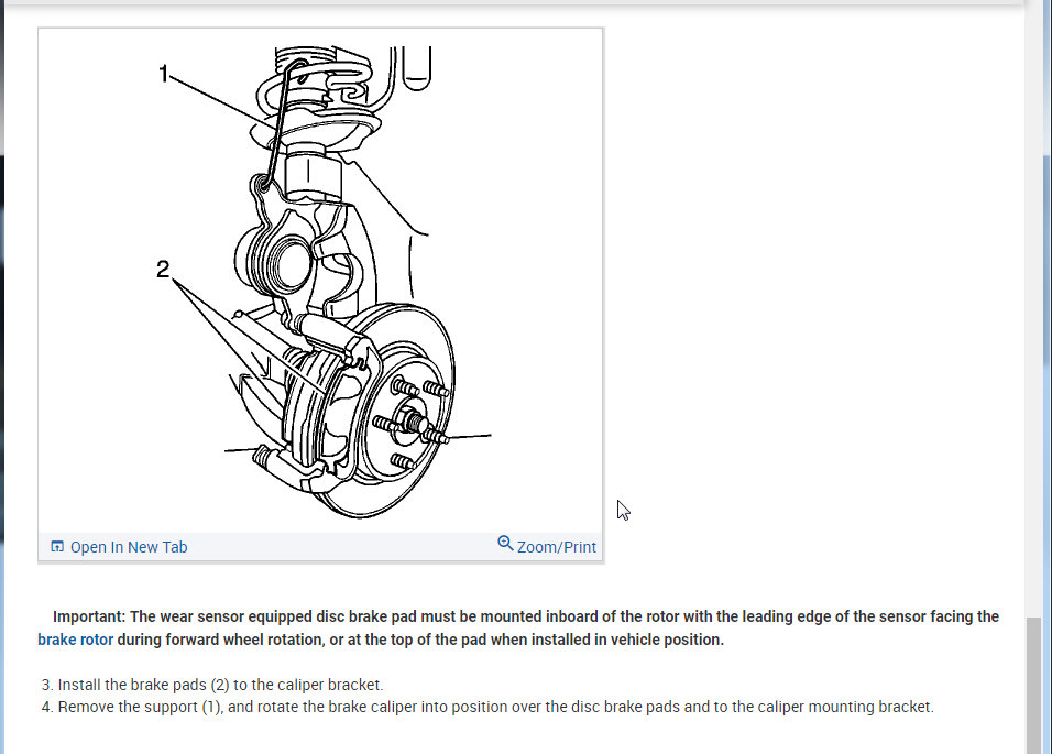

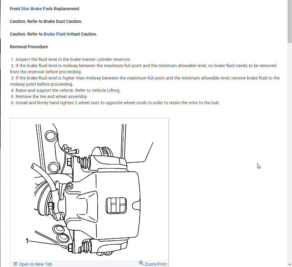

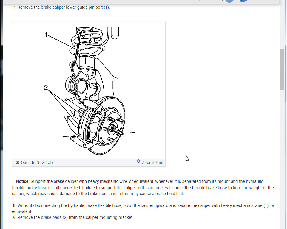

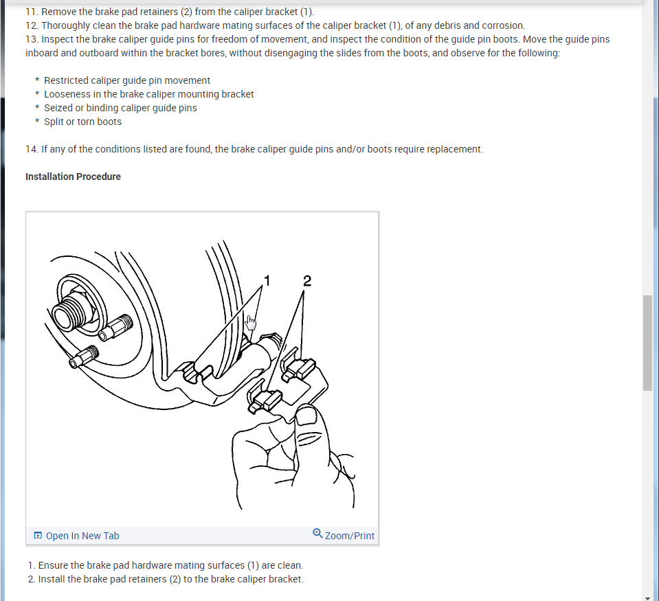

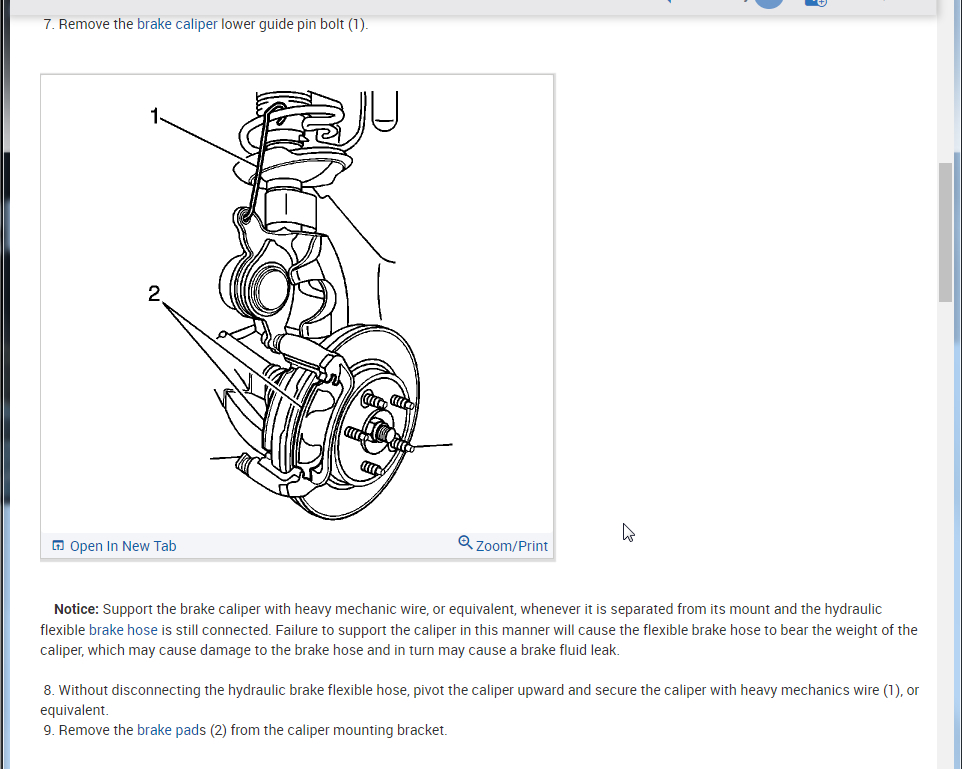

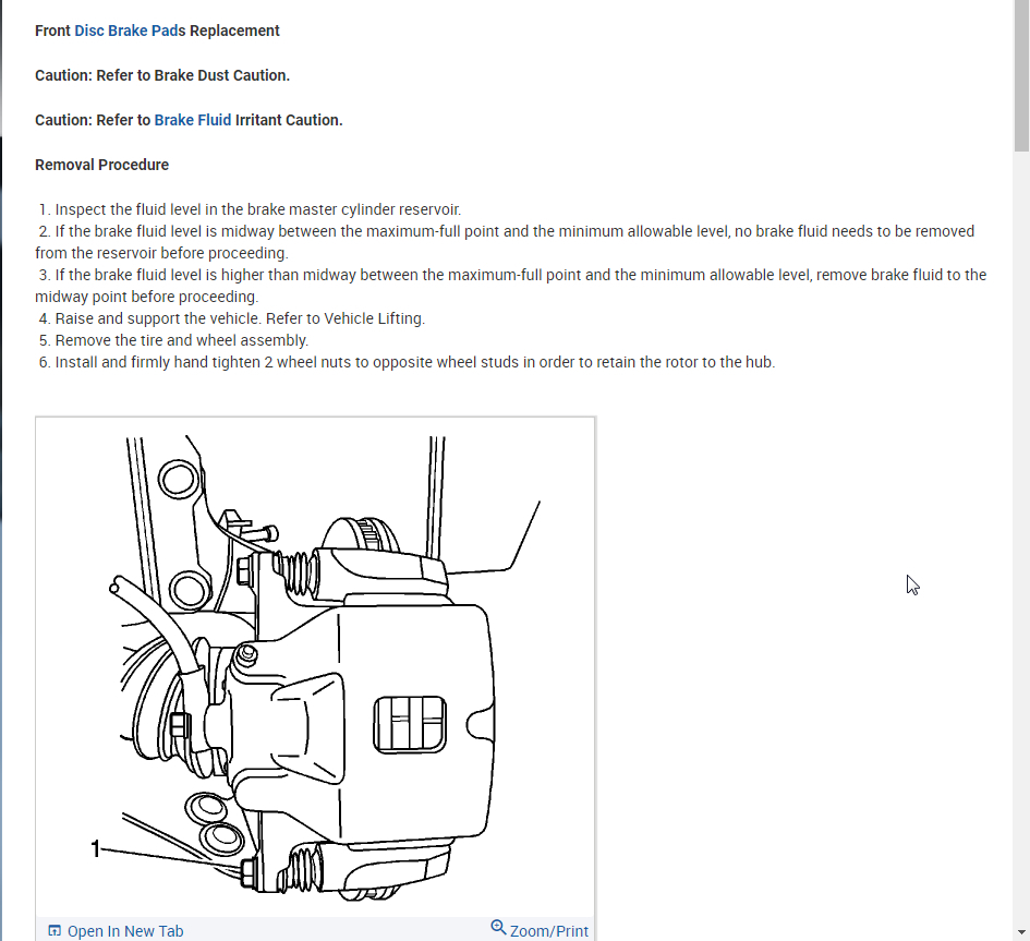

Below is the process from the manual that will help with this as well. Please let us know if you have other questions. Thanks
