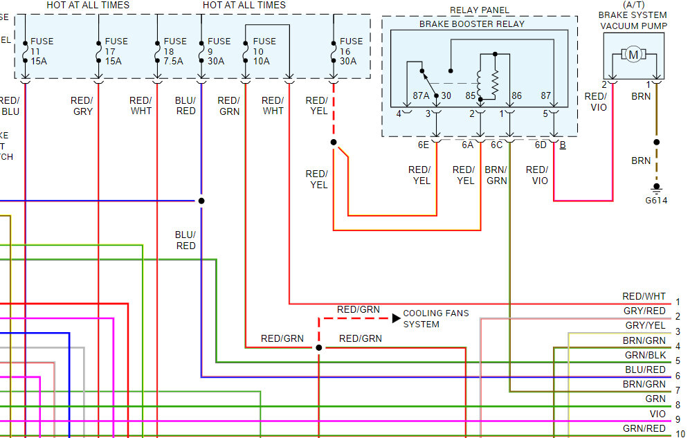

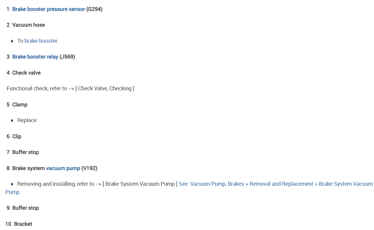

I have a hard brake pedal, and I’m not getting any power to the plug that connects to the vacuum pump! I’ve tested the pump, and it works, also fuses and relays! The only thing I think could be the problem is the brake switch! Just not sure if the switch goes to the pump.
Apr 13, 2024 at 1:44 AM
  • 55,433 POSTS

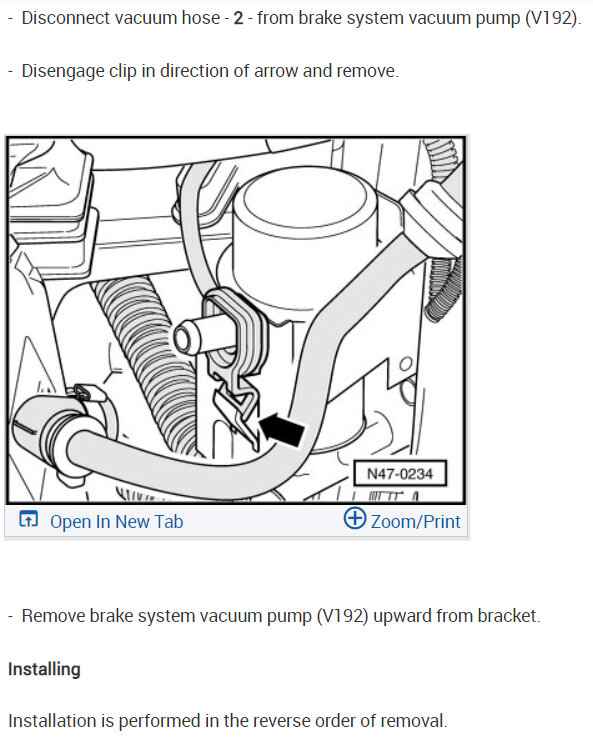

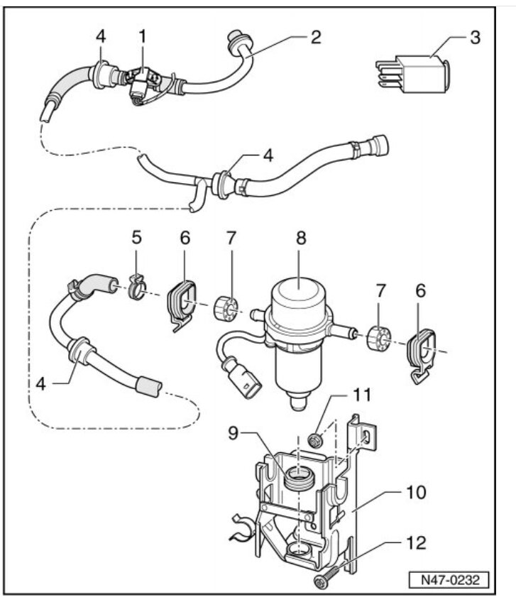

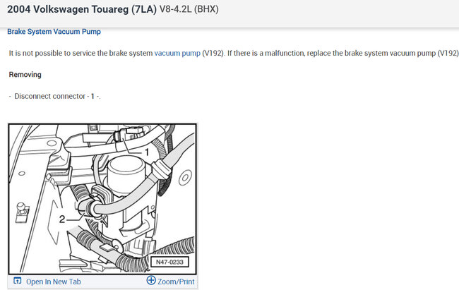

I would check the ground #G614, here is the wiring diagrams for the brake booster vacuum pump and how to change it out which shows how the vacuum lines go.
This guide can help you check for power and ground, also check for power at fuse #16:
Check out the images (below). Please upload pictures or videos in your response to the problem so we can see what's going on.
