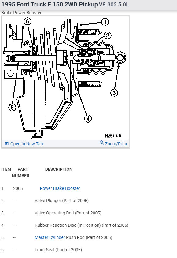

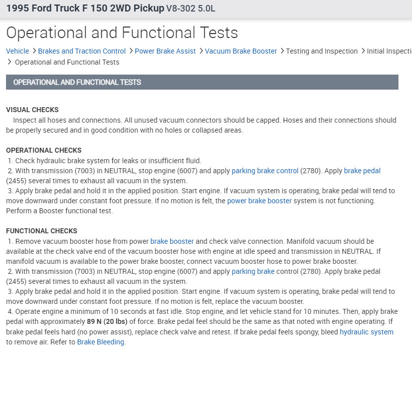

When depressing the brakes there is a popping or clicking noise coming from the brake booster. I took the booster off and when i push the rod in by hand it still makes the noise.
Nov 4, 2016 at 6:36 PM
There are a number of things that can cause clicking noises but if you removed the booster and it makes the noise on the bench by moving the rod by hand then the booster needs to be replaced.

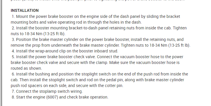

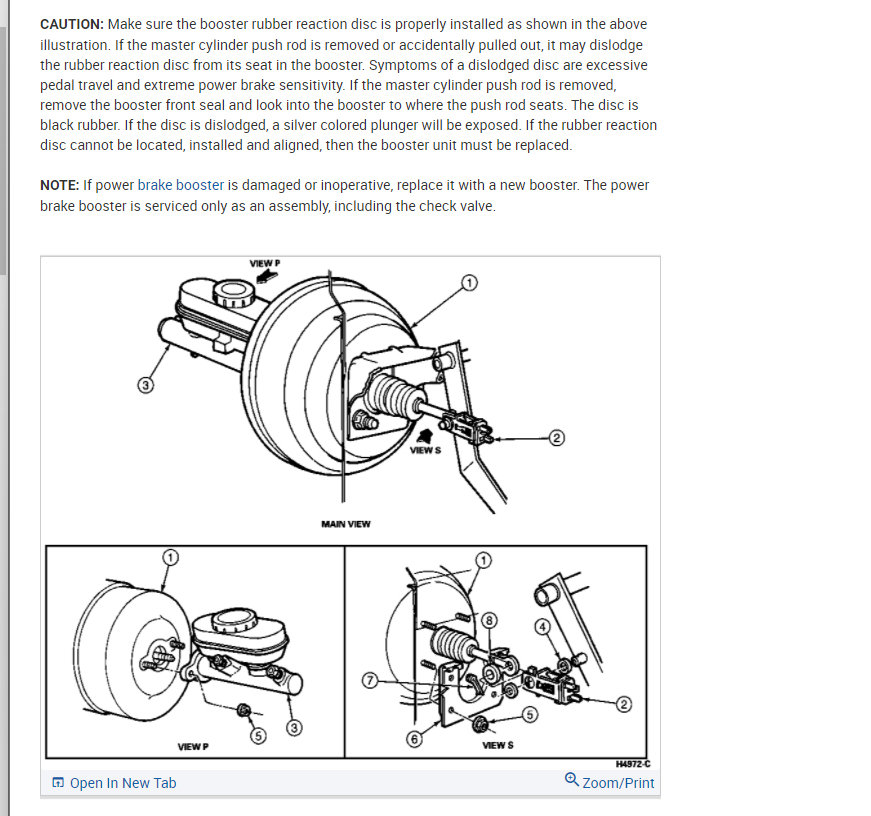

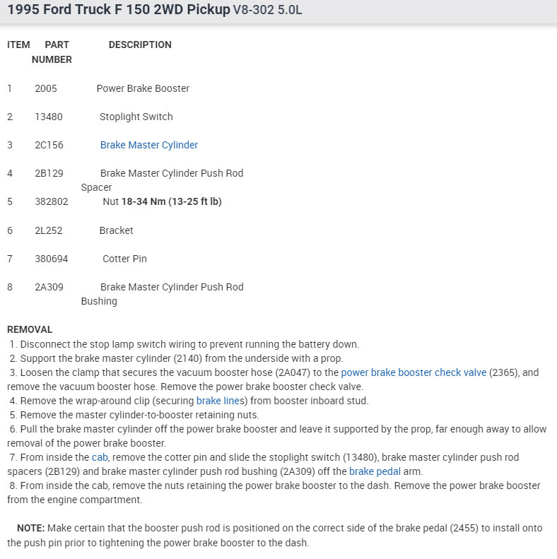

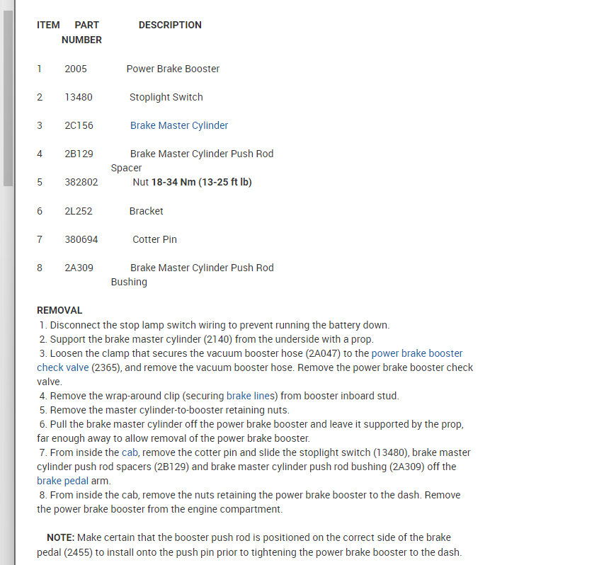

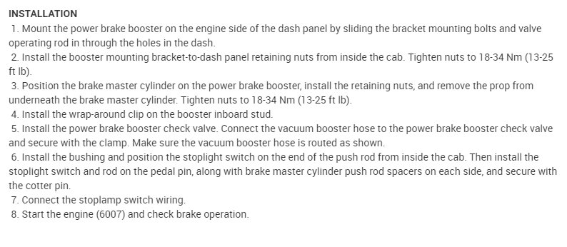

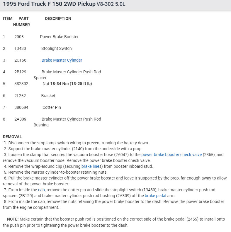

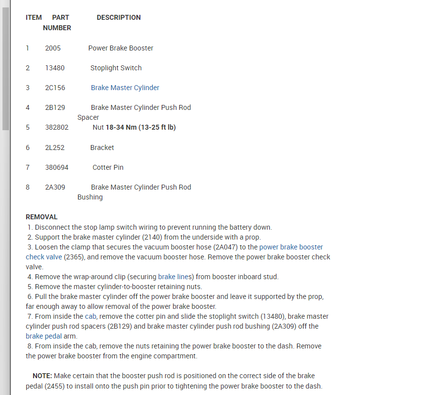

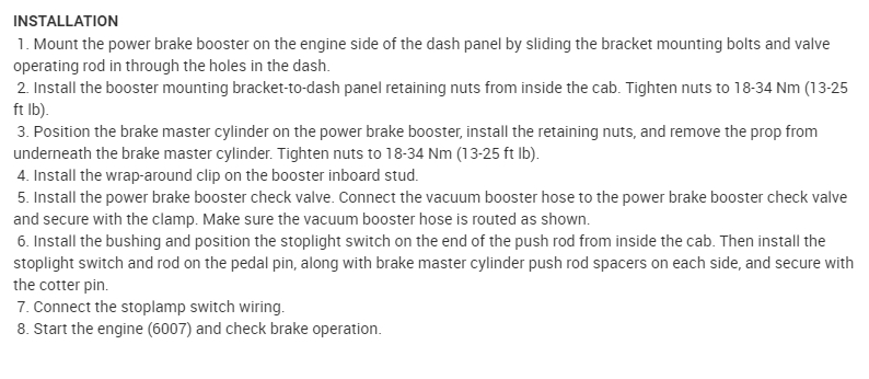

I am attaching the info below on how to replace this from the manual. Please run through this and let us know if you have other questions. Thanks

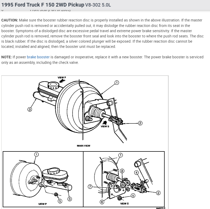

It sounds like you have a loose or broken component inside the brake booster.
This will require replacing the brake booster.
I have attached the replacement procedure for the brake booster below.
