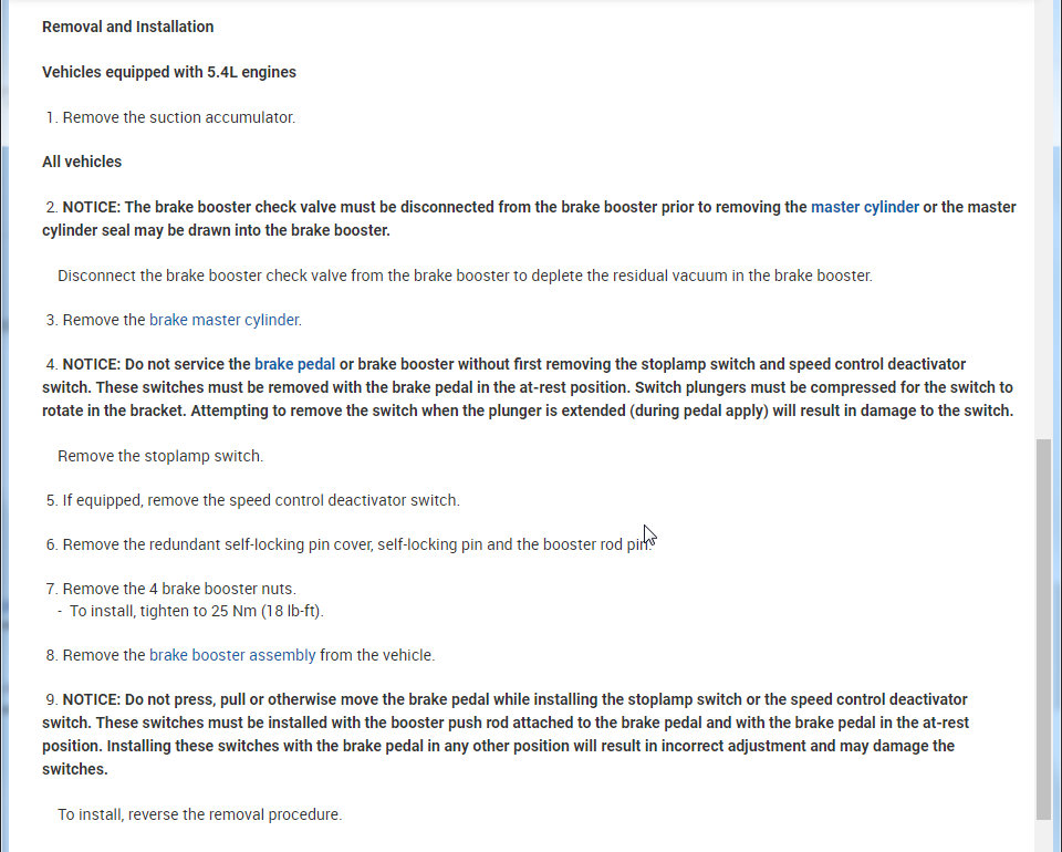

can loss of vacuum to brake booster cause pedal to go to floor and loss of braking power?
Mar 12, 2018 at 6:12 AM
Experienced Mechanic
18,907 POSTS

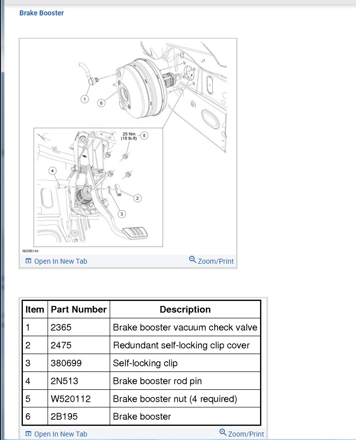

It will cause these issues so I would recommend replacing it. Here is a guide that will help with this:
https://www.2carpros.com/articles/brake-pedal-goes-to-the-floor
Below you will find the process from the manual on how to replace this. Please run through this material and let us know if there are questions. Thanks
