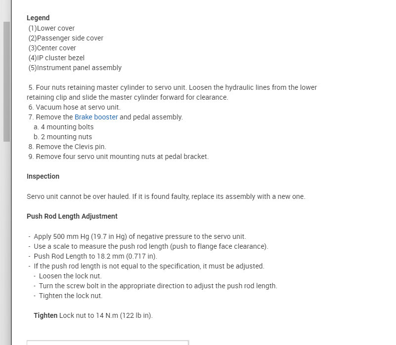

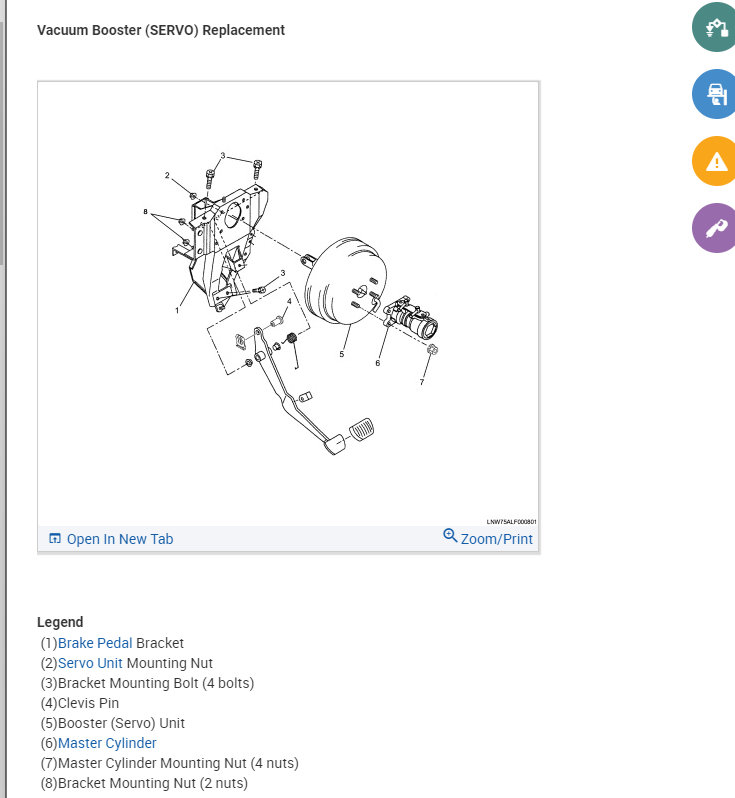

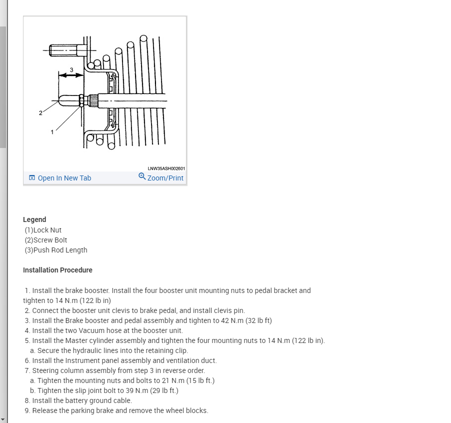

Does anyone have any tips on replacing the brake booster on the vehicle listed above? More so the physical removal. Does the flat brace on top have to be cut out? Is taking the lines off the master cylinder necessary to get the necessary clearance? Thanks
Apr 25, 2022 at 2:14 AM

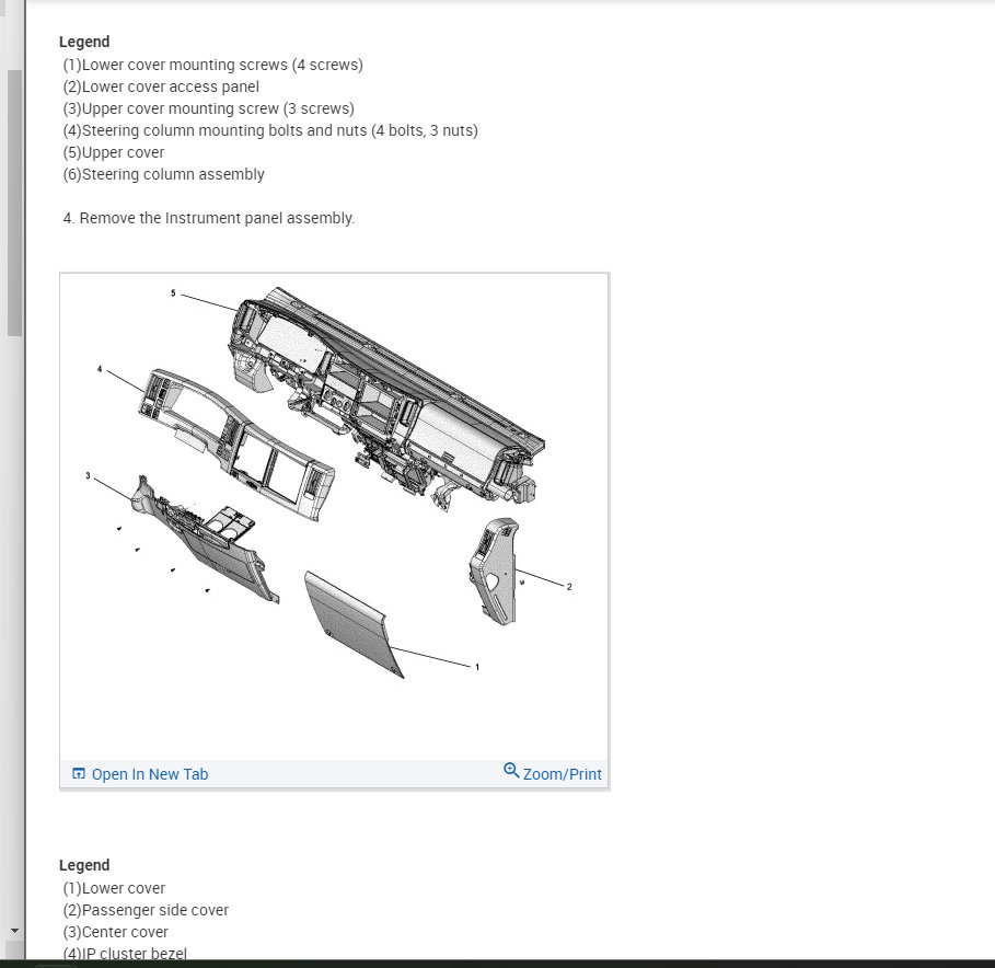

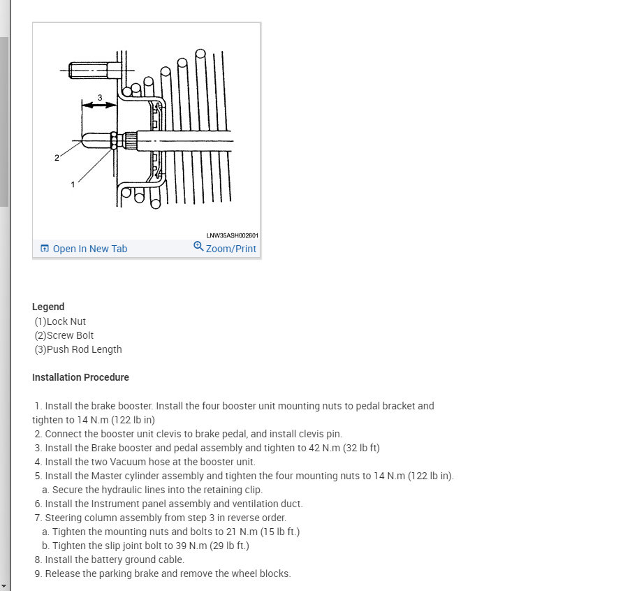

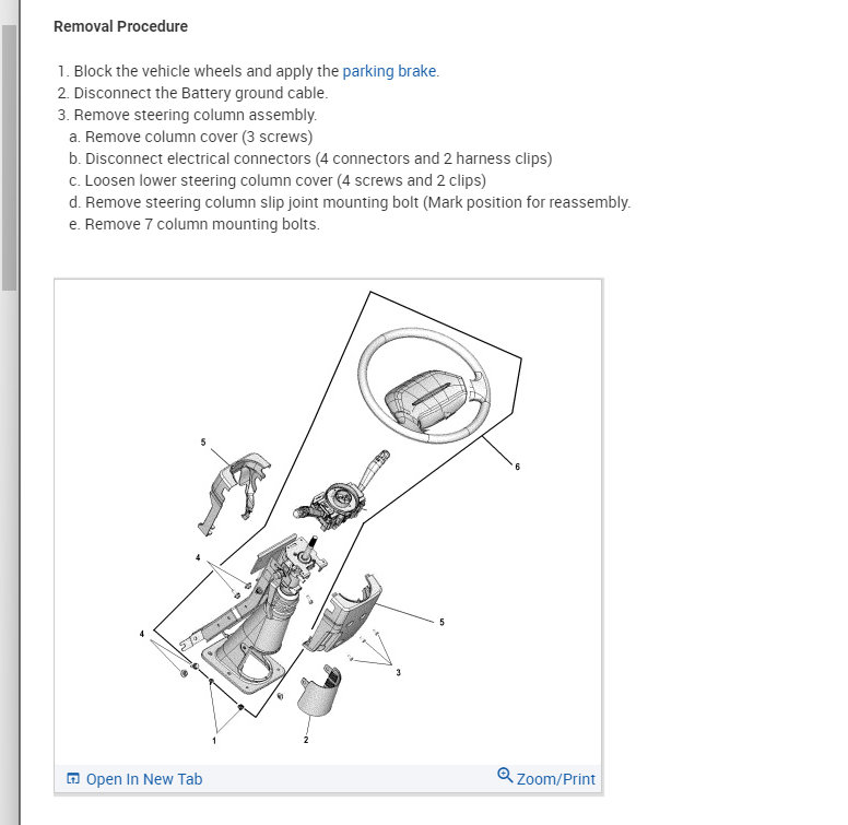

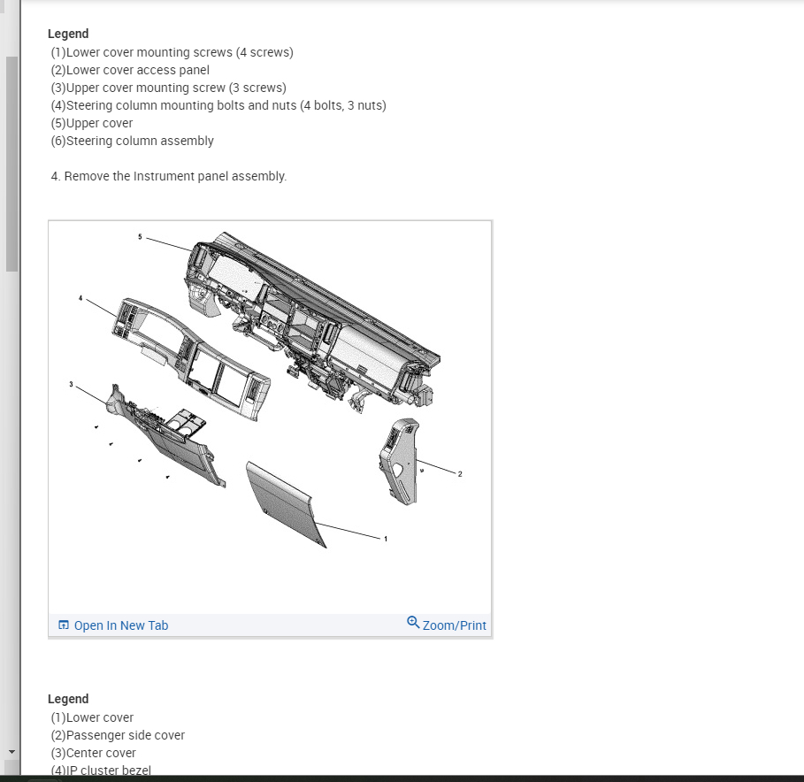

We don't have a manual that shows how to remove this on 2002, but we do have it for 2005, so I am attaching that below.
It does tell you to remove the front lines for clearance in step 5 so you are going to need to bleed the brakes after you are finished.
https://www.2carpros.com/articles/how-to-bleed-or-flush-a-car-brake-system
Take a look at this info and let me know if you have questions.
