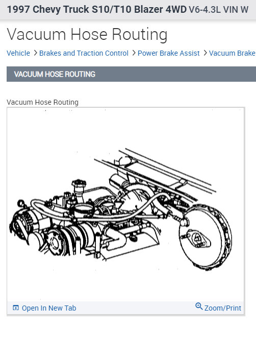

I have a brake booster that has failed me oh, and the question I'm asking is simple. Will I be able to replace the booster without having to bleed the brake system? I've already traced all the vacuum lines to ensure that I didn't have a leak somewhere else, because I just changed the throttle cable. I was hoping when I change the throttle cable, I have not something else too loose. I wasn't that lucky. The last question I asked was answered rather quickly, and it was very helpful.

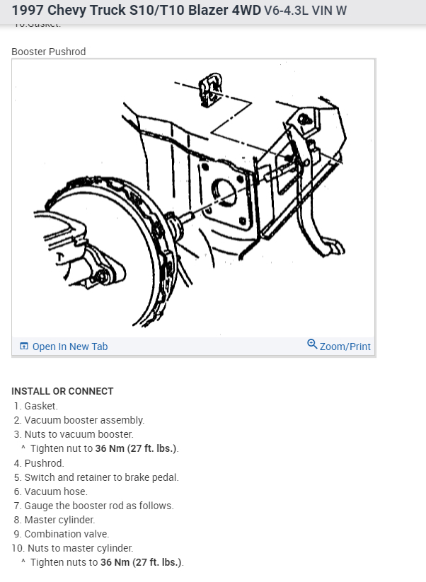

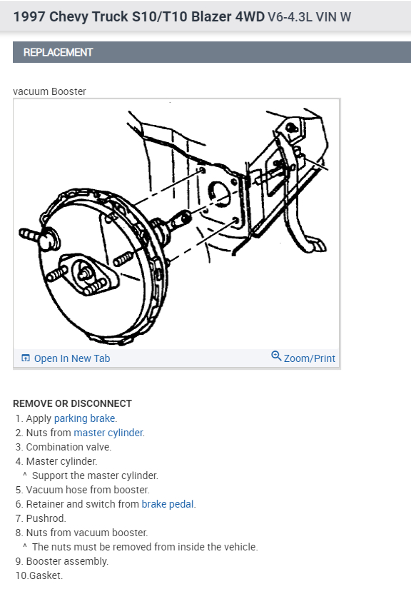

I wanted to jump on and add a little more info on top of what Steve has posted.
As long as you don't have to remove the brake lines you do not have to bleed the system. However, I'm not sure there will be enough space without removing the brake lines from the master cylinder. As the master cylinder gets removed along with the lines when replacing the brake booster.

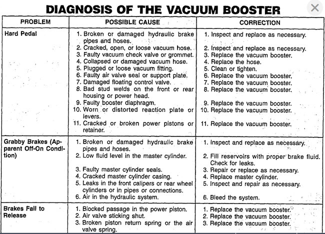

I have attached the brake booster replacement procedure below.
Let me know if you are able to get this done or if you have any questions.
