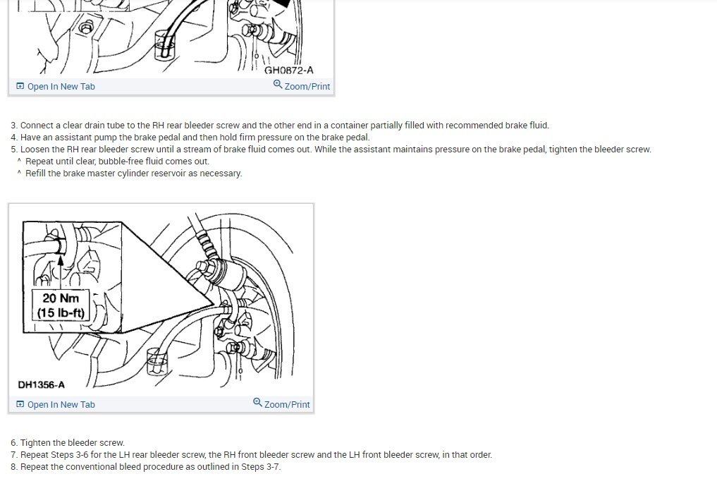

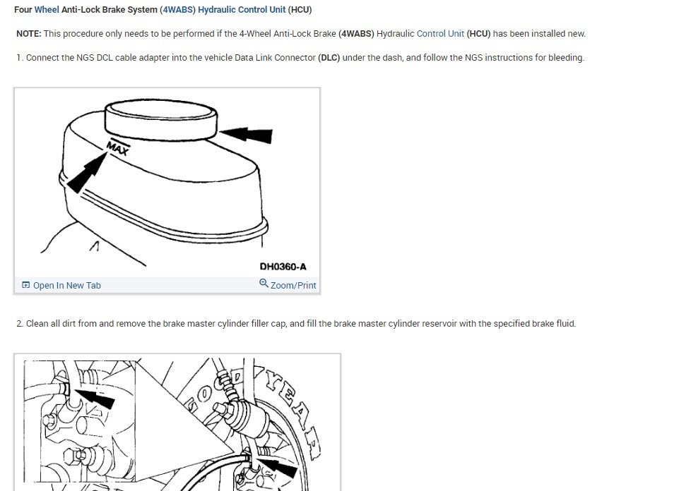

What is the correct procedure for bleeding air from brake system with ABS?

Here is a video and guide below to help you bleed the brake system correctly.
https://youtu.be/w7gUsj2us0U
and
https://www.2carpros.com/articles/how-to-bleed-or-flush-a-car-brake-system
and
https://youtu.be/WDxvEQrMkBg
Please run down these guides and report back. I have attached the service manual brake bleed procedure for ABS equipped Ranger. Basically connect the scan tool, follow the instructions on the screen, and open the right rear caliper bleed valve.
