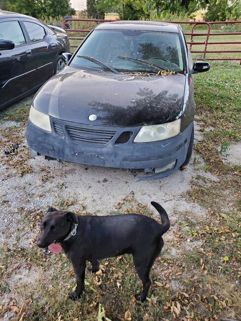

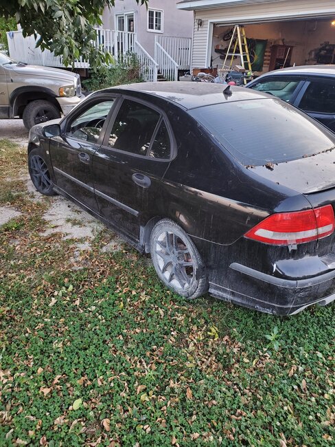

JEEP769
  • 51 POSTS
Here is a couple of photos and a video of my car while I'm waiting for the mechanic to reply LOL
Aug 4, 2025 at 2:30 PM
  • 55,433 POSTS
Yep, you should be able to get the brakes working, the ABS system needs to be open, or I would use vise grips and gently close off each wheels brake flex hose to see if it makes a difference.

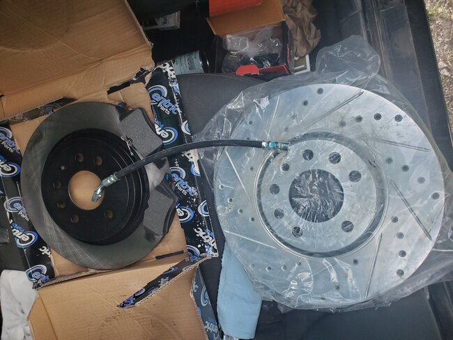

JEEP769
  • 51 POSTS
Here's a picture of all the month new parts that the mechanic was supposed to install and never did
Sep 7, 2025 at 12:20 PM
  • 55,433 POSTS
Yep, those look like good parts, did you want to try installing them yourself? We can help walk you thought it, CARADIODOC and myself ;)
