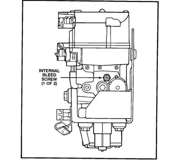

This Is not my car! My friend is having problems with his brakes. I think he let the fluid get too low, and now needs to bleed the brakes. The ABS brake pump is disconnected because it is no good. But before the fluid level dropped his brakes were fine. The brake pedal goes straight to the floor. It grabs about 7/8 of the way down. You still stop, and it is solid. It does not feel spongy or like there is pressure loss. To restore his brakes, is there a sequence we need to follow even with the ABS pump not operating?

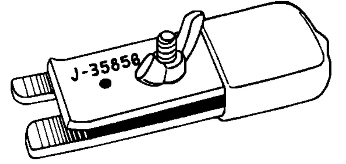

There is a method to bleed if you do not have a scan tool. in order to bleed this system, you need a scan tool and a ABS system that has no codes and is active. below is the procedure for this without using a scan tool. there are tools required which must be purchased. then you can bleed the ABS unit.

3. Install two bleed valve tools on the 4WAL EHCU at the high pressure accumulators (HPA).
4. Install one bleed valve tool on the combination valve.Do not over tighten the wing nut. Doing so will result in brake fluid leaking from the combination valve.
5. Back off the two internal bleed screws on each side of the EHCU 1/4 to 1/2 turn.
6. Use a conventional bleeding process (pressure, vacuum or manual).
7. Bleed the 4WAL modulator before bleeding the wheel cylinders.

12. Remove the bleed valve depressors and tighten the side internal bleed screws.Do not over tighten.
