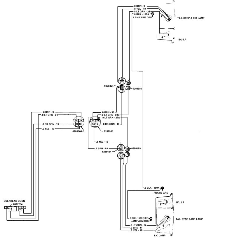

Right rear turn signal and brake light not working. Replaced bulbs and light receptacle. Still does not work.

It sounds like you have a bad ground wire. Here is a guide that will help you test the grounds and power to the brake light bulb:
https://www.2carpros.com/articles/brake-lights-not-working
Here is the wiring diagrams so you can see how the system works.
Check out the diagrams (below). Please let us know what you find.
