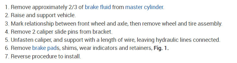

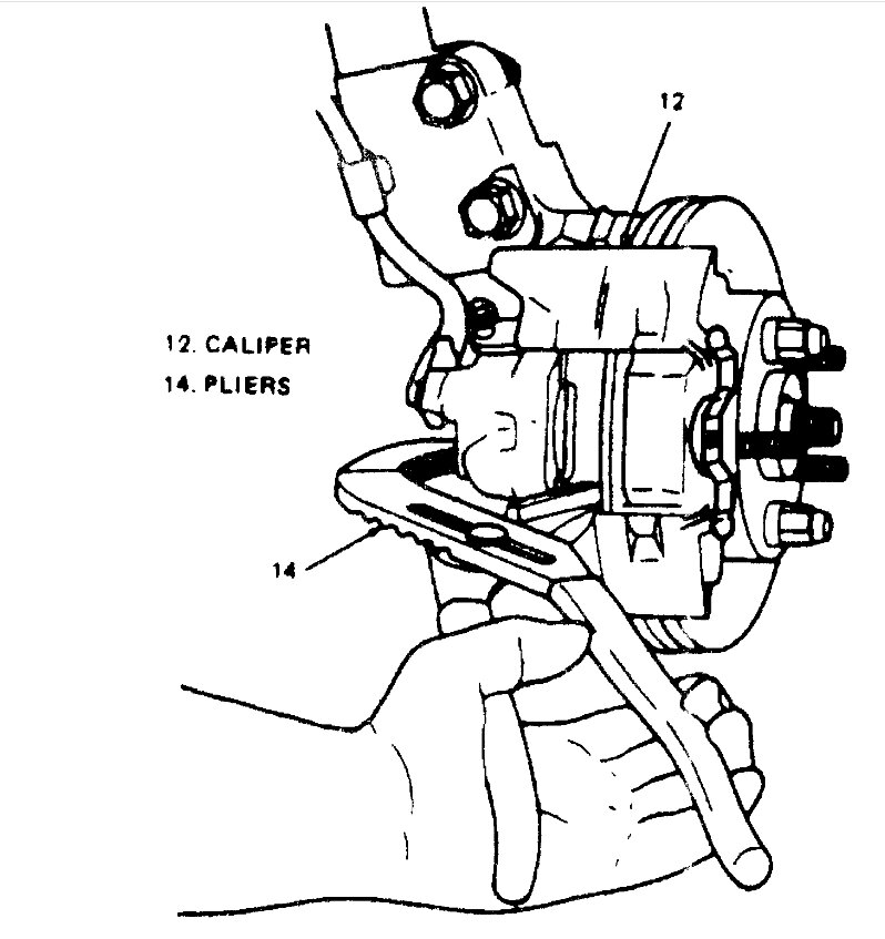

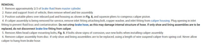

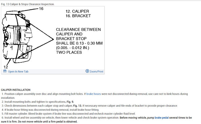

  • 55,732 POSTS

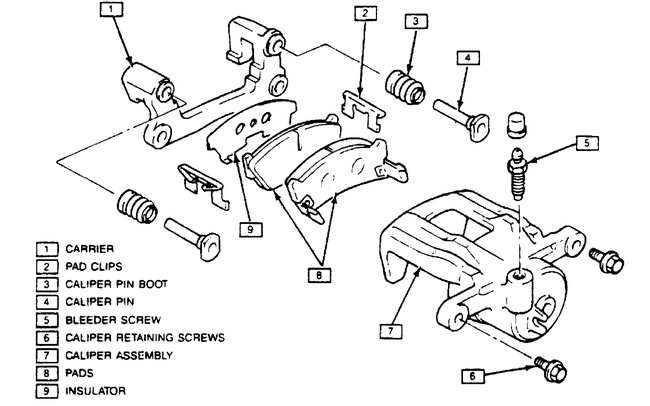

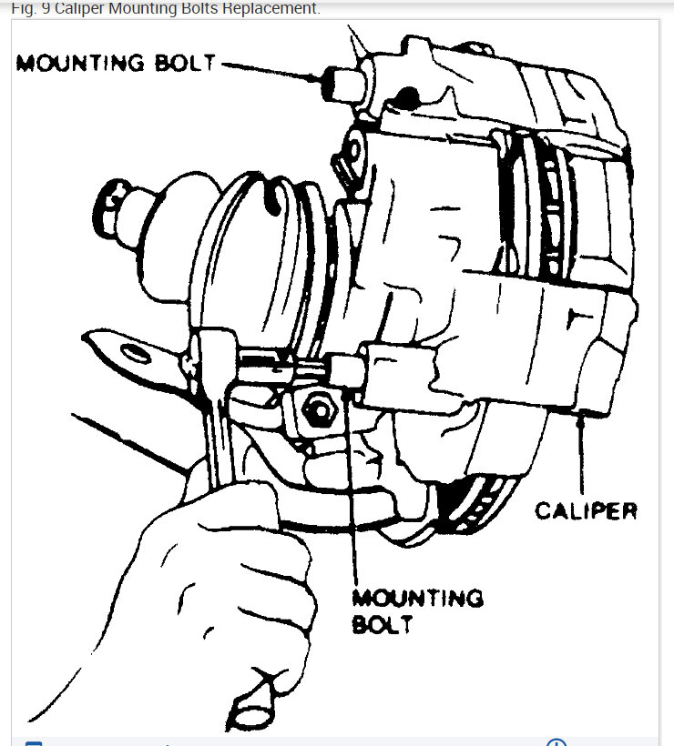

Does this car have rear disc brakes? This must be a problem with the pads or calipers, here is how the system goes together so you can recheck the work that was done. Make sure the mounting bolts are tight and that the slides are free. Please go over this guide an check the instructions in the diagrams below.
https://www.2carpros.com/articles/discover-why-automotive-brake-pads-wear-unevenly
Check out the images (below). Please upload pictures or videos in your response of any problems so we can see what to help you with.

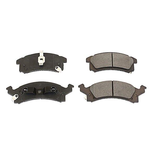

Did it make the noise before you did the brake job? If not, then the brake job is to blame, are the pads loose in the caliper mounting bracket? Did you install the retainer clips? Check out the images (below). Please upload videos in your response of any problems so we can see what to help you with.

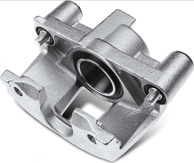

96CHEVYCORSICA
  • 8 POSTS
So, the noise only started after, and continued after taking calipers and pads off to do the wheel bearings. The pads are tight when put on the car, but they don't use retaining clips, and the caliper itself Is a bit different. Over the last few days it's gotten quieter and happens less often now, so maybe the brakes wore down weird when I was driving it home with the brakes dragging?

Or I guess i should say it doesn't use traditional clips.

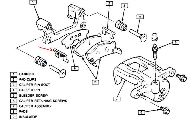

  • 55,732 POSTS
Did the brake pad kit come with the clips? It says it uses them, this will make strange clicking noises at times. Can you please shoot a quick video with your phone so I can hear the noise? that way I can tell for sure what's going on.
